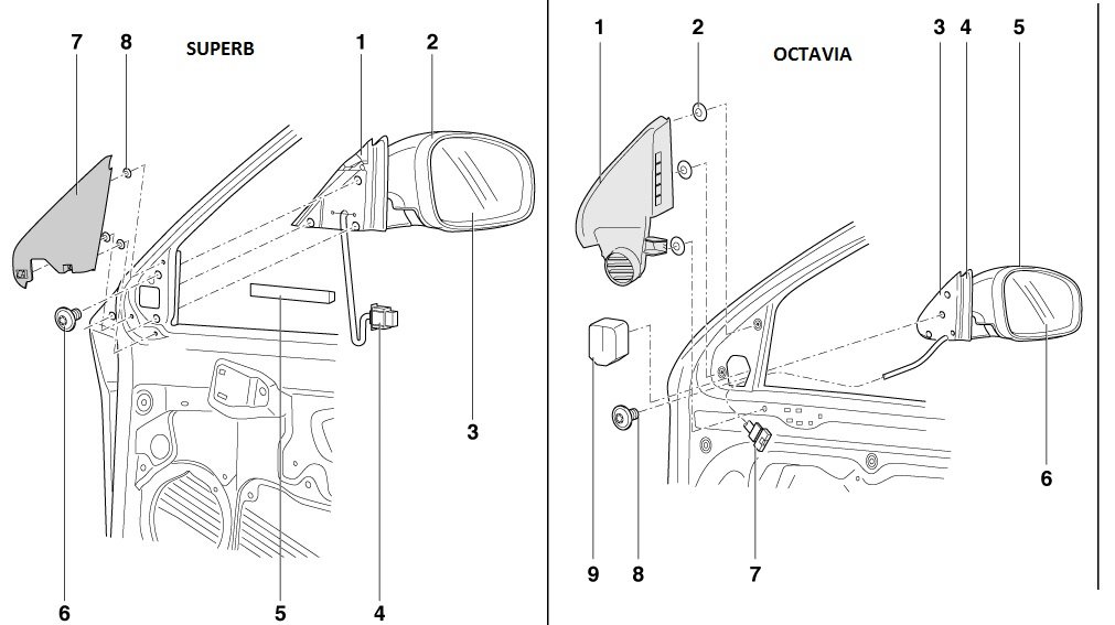

Anyone has any idea if I can install a Superb mirror on an Octavia 2011 FL.
I'm talking about electric fold-in, heated and entry light mirrors.
Maybe is a stupid question, but the mirrors look pretty much the same to me.

I'm having hard time finding a used LHD Octavia mirror at a reasonable price. Found a Superb one and I was thinking maybe...
Well, after some research turns out you cannot fit Superb mirror on Octavia. Different mounting points.
Now, maybe the inside mechanism will fit.... something else to research.
