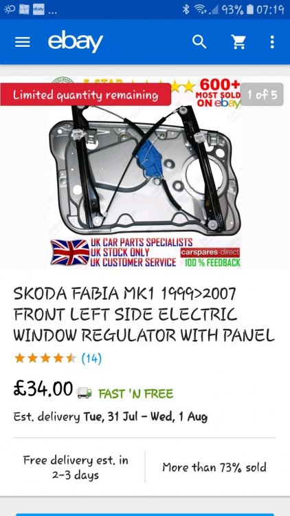

Anybody used these to repair the front window is so are they any good
Yeah they are fine, easy to install.
Sweet!
Might save a ball ache trying to get all lined up etc.
