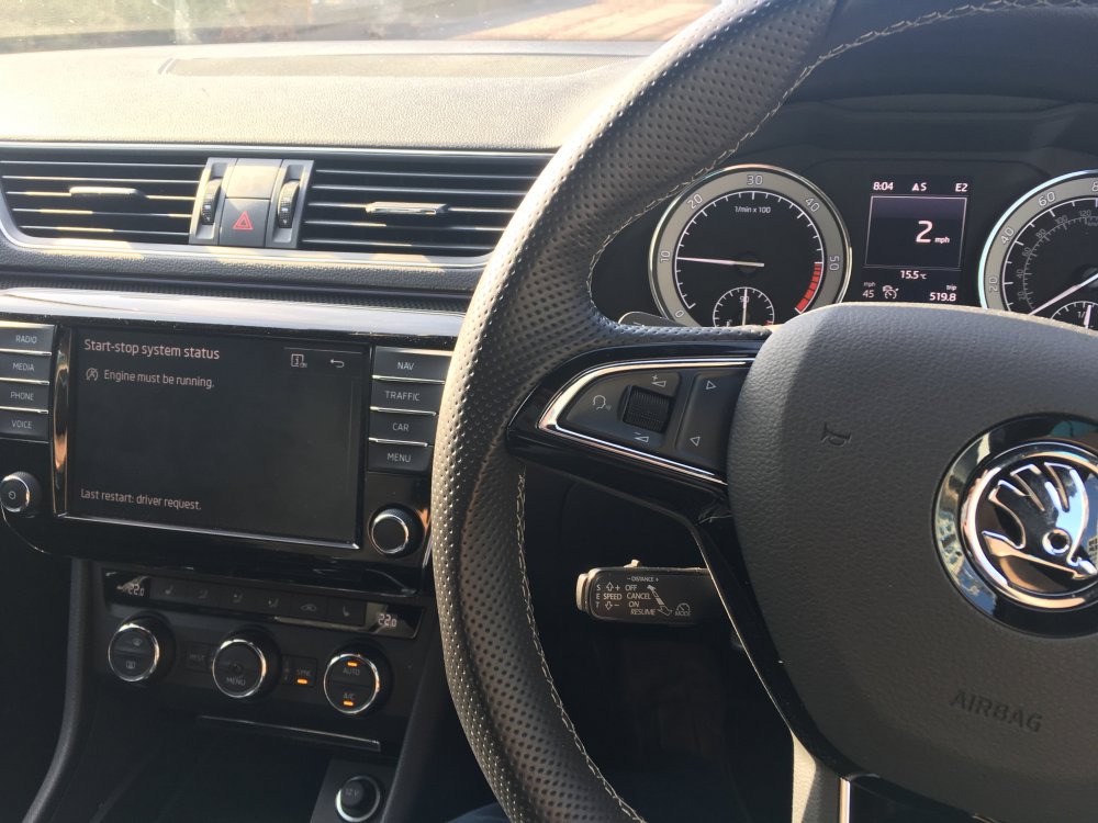

I'm trying to figure out if this is a fault or not, the car sometimes doesn't stop the engine when expected. I have selected the start/stop status screen in the menus and had many legitimate reasons why, except for one "Engine must be running"?
It is!!
Have a look at the photo, you can see the engine's rev's are idle and the computer seems to think the engine is not running?? I know the speed is 2 mph but it is the same at full stop.
Any ideas?

Yep all complied with although i'm on a DSG with auto hold.
So I wonder if it is a DPF regen?? It could have said that on the screen rather than a misleading "engine must be running"

 It is indeed the DPF regen, I have the same and if there is anything else stopping the S/S to work it usually tells me exactly what, but with the DPF regen it's just the general "engine must be running".
