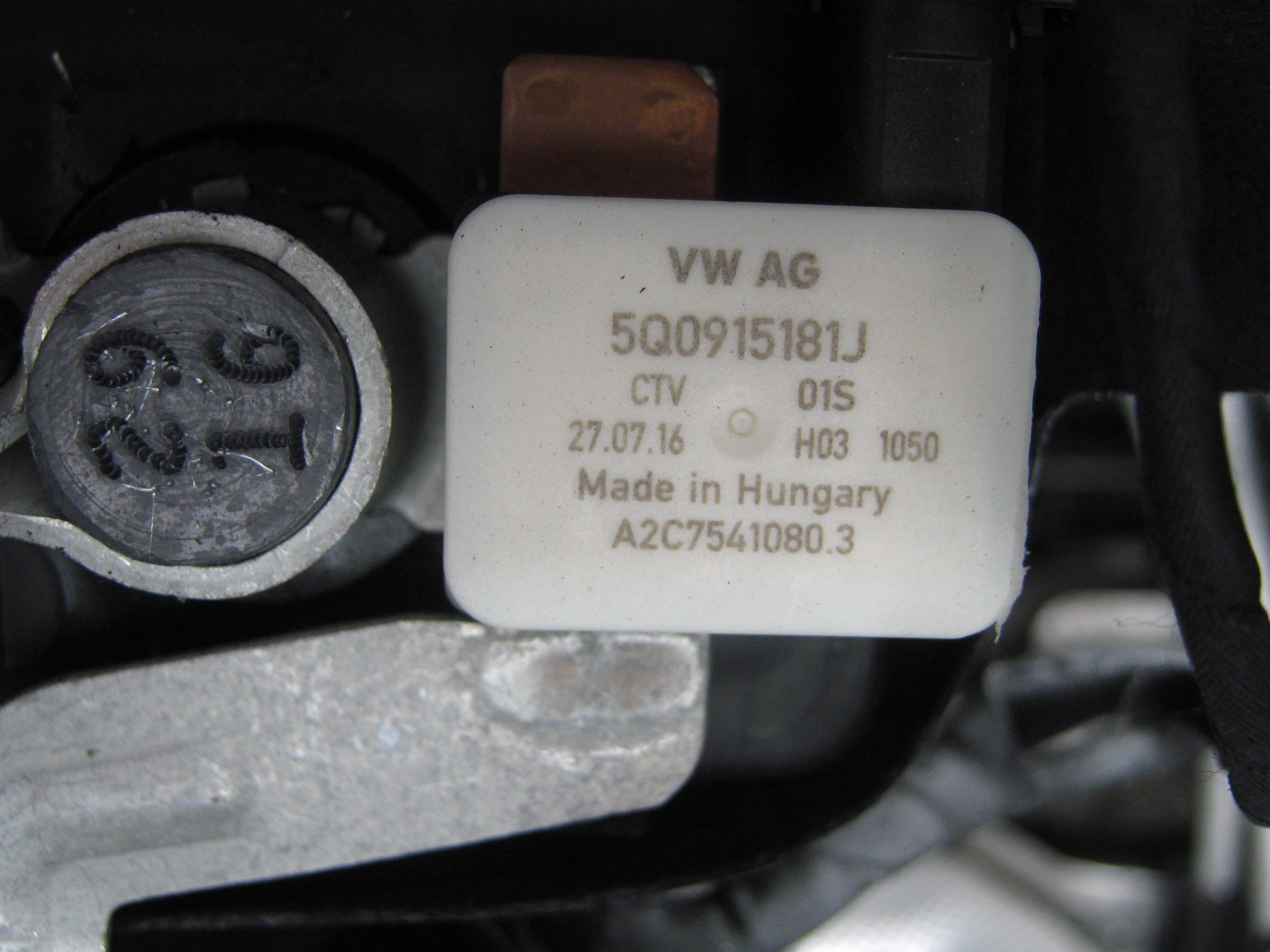

Waiting on a new control module to be fitted on mine.  Same message about high power consumption. Works very rarely  regardless of journey length.
Thanks, any info about similar problems is useful.
Is this the module (on the negative terminal of battery) you are getting changed?
