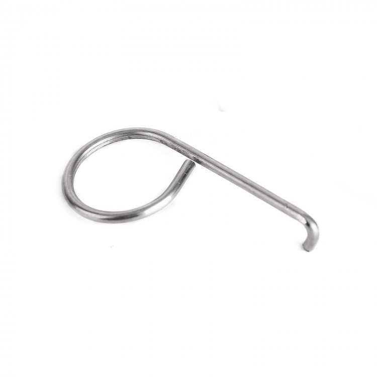

I think a proper tool to remove wheel bolt covers is missing in my car.
There is a spare wheel kit which includes:
tow eye,
wrench,
socket to remove security bolts,
jack,
screwdriver
and a little pick-hook.
I tried to pull the bolt covers off using included hook, but ended up finding long nose pliers and using them instead. I think there should be a U shaped tool to remove these covers.
Do you people have it in your cars from the factory?
Yes the lower picture is the tool you want. It is in my tool kit, but you might only see the curved end sticking up.
Thanks AG Falco
It's not in. I looked everywhere twice.
At least I know now that the hook was not the intended tool for the job :)

I had a similar plastic u shape for my old 55 plate Fabia estate but on the new Mk3 you seem to have to push the tool further in before the little lugs catch the back of the covers before you pull them off. The bent bit of metal is to remove a cover under the wheel arch when replacing the headlamp bulbs. If you value the skin on your hands and having to learn more !"£$*!! and !"£$£"!$ words than you thought you might ever need get a garage to do it for you, I did :) Joe

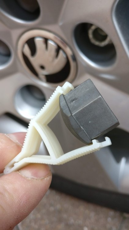

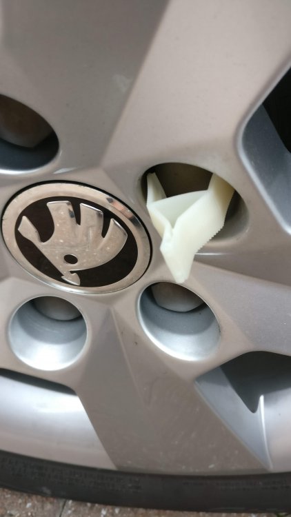

Today I found out that a fuse puller can actually do the job quite well. Maybe it will be useful for someone :)
Oh no, you need to keep that for the fuses, better to get the proper tool from Skoda dealer.
I ordered it from Ebay. Paid 99p. Will take some time to get here from China.
