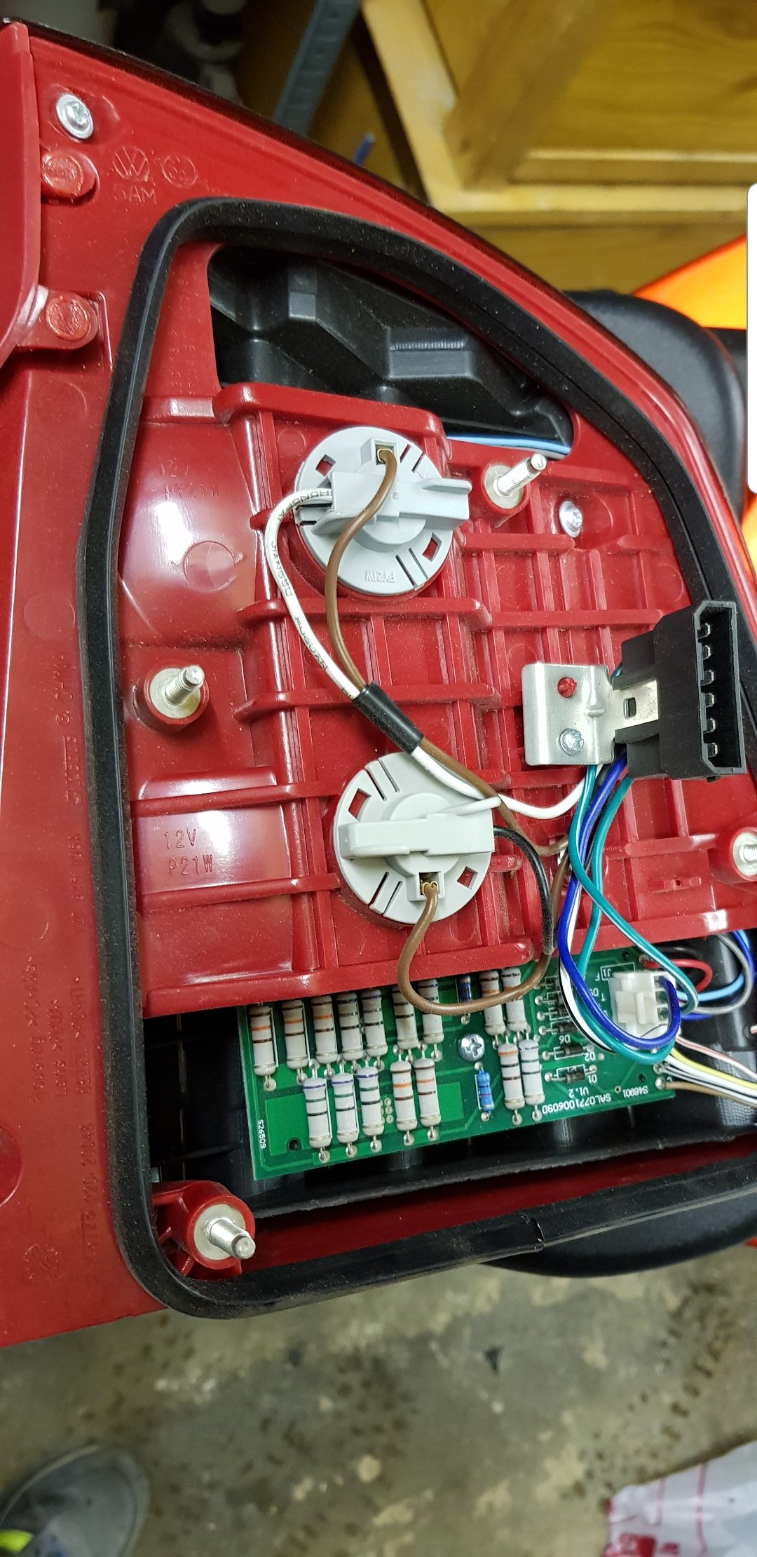

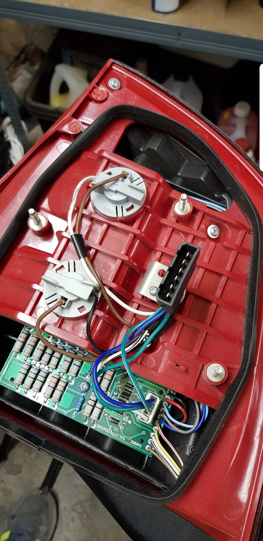

What resistors?
There should be a small PCB (resistors and diodes) permanently attached to the rear of the light cluster, there are no other resistors needed or included with mine.
All I did was unplug the original halogen lights, run a wire between the T10/W5W sidelight connector and the spare pin on the cars connector, then plug the new lights in. No other wiring or resistors were required. I then used ODIS-e to code the lights and they work are shown in my pictures above. Simples ;)
It might be worth adding some pictures of what you've actually got...

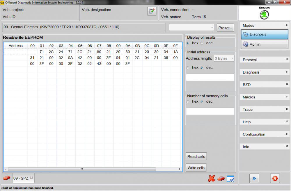

I will get pic up of the light 2nite, be interested to hear how u done it with out bulb warning lights
By directly editing the lighting configuration in the BCM EEPROM using ODIS-e.
This is an example where I was enabling the second fog on a stock vRS. When fitting LED clusters there are many more changes required but it's the same method.

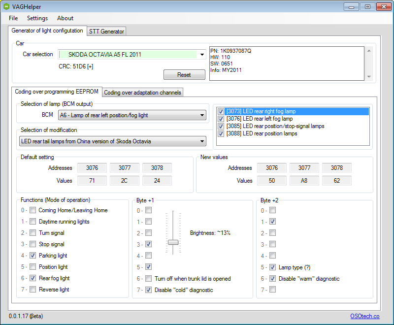

I prefer VCP and VAGHelper instead of ODIS. ODIS is not user friendly.
This is the method I followed to activate the rear position lights as rear drl:
  1. read and save the  *.bcm1 file with VCP (also make a safty backup!)
  2. load it into VAGHelper
  3. modify the corresponding BCM pin(s) with checking check boxes
  4. save the modified *.bcm1 file
  5. load and save it to the BCM with VCP
Here's an example screenshot of the VAGHelper with the preinstalled setup for the OEM rear LED lamps (left position/fog light output is selected for detailed info):
(I haven't tried it (the rear led version), maybe Langers2k can confirm whether it is ok or not)
Edited by mucden
The vaghelper defaults weren't great. It's almost like they didn't know how they were wired up so drove the same LED's over multiple channels and tried to match the brightness.
Instead I came up with my own simplified version that I've had zero issues with.

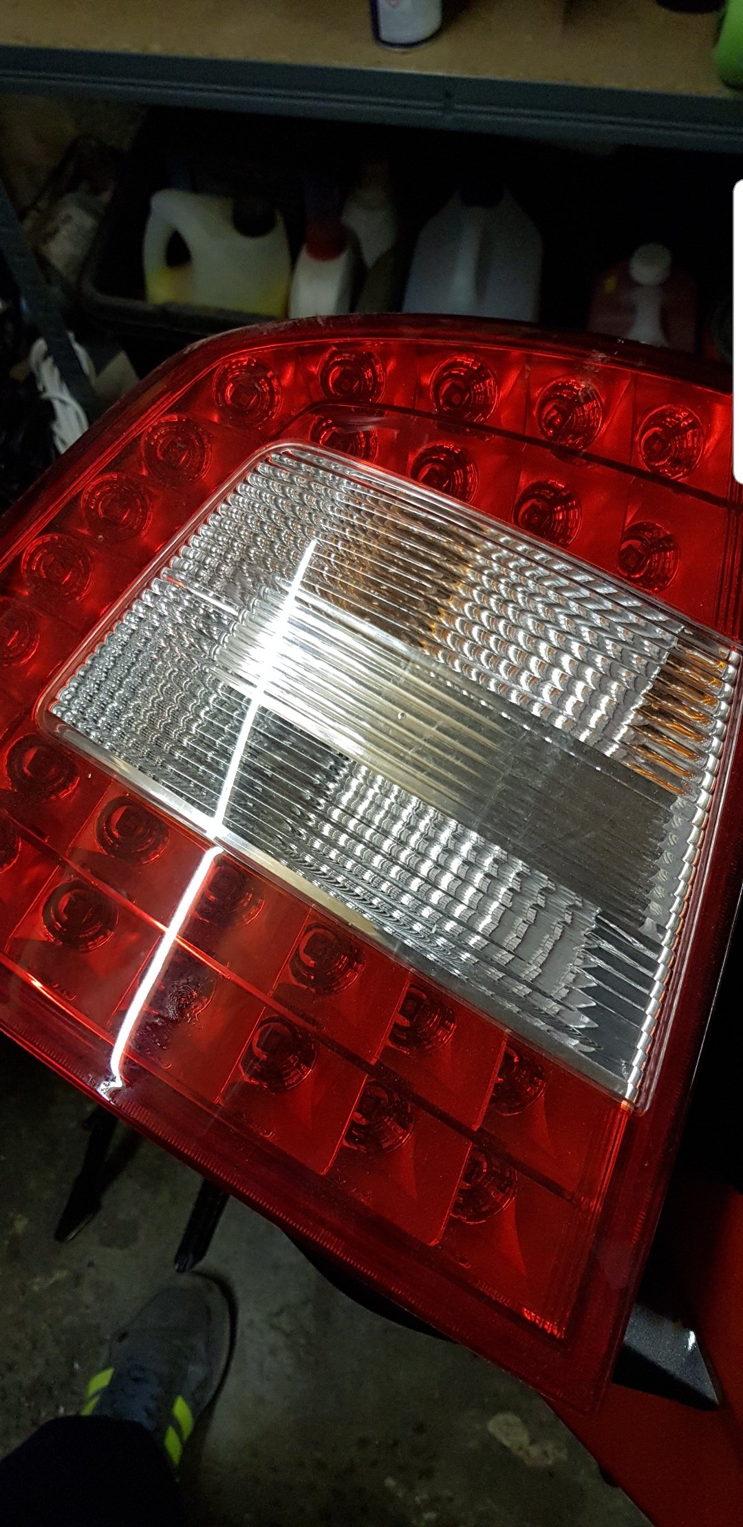

Langers2k these are my rear lights, reconise them
They look very similar to mine.
You'll need to wire the T10/W5W connection on the car side to the spare slot in the cars connector, plug the new lights in and then code them with VCP/ODIS-e.
I havent got vcp/odis-e so will have to find some1 to help me with that and maybe explain in more how to wire it up so they are on like a drl
Dont suppose u have a how 2
Rear DRL is done when you code the lights in VCP/ODIS-e. As I say, the only wiring needed is to connect the existing T10/W5W wiring to the spare pin on the connector to the rear lights. This is used to make the tail lights work :)
