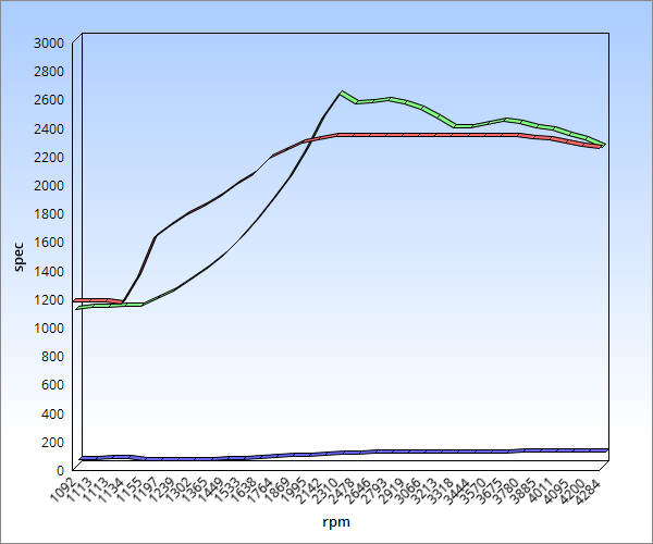

Ive just fitted a reconditioned PD150 turbo to my vrs, however its having issues with overboost. On the standard pd130 map it is overboosting slightly, peaking at 1.65 bar then coming down again slowly. The N75 is showing 79% at 4000rpm which i believe is correct. There is no lag it kicks in when it should so i would have thought the stop screw would have been set correctly.
When my mapper puts the revised map on it for the bigger turbo it just spikes in overboost to 2 bar. he has adjusted the map and reduced boost etc but it still wont hit the target boost until gone 3k rpm. Ive uploaded a graph to show the issue with the standard pd130 map on the car.
Ive checked the actuator moves freely and holds a good vacuum when tested. No faults logged in vcds

I managed to resolve this , was a dodgy MAP sensor in the end should have updated it
