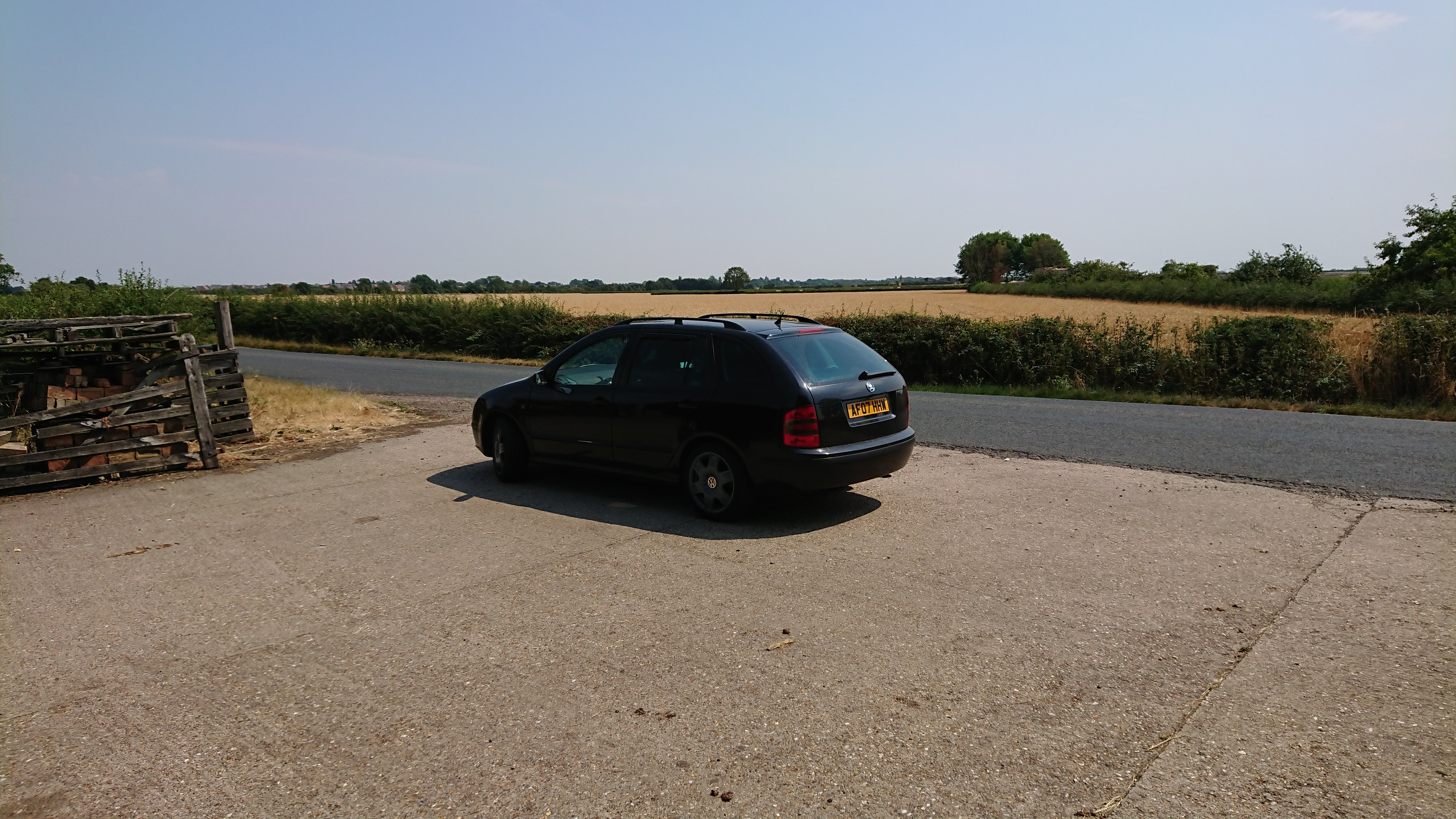

Hello everyone. As some of you may know, I have an 07 reg 1.9 PD fabia Estate. It has Bilstein B4 shocks on it, Eibach pro-kit springs (35mm drop), H&R spacers and a new set of (refurbished) MK4 Bora Sport wheels with Sailun Atrezzo 205/45/16 tyres on them. All major suspension components have been changed as well (But the NS front wheel is running - 1.0 camber due to pothole damage..........I have been told this is within tolerance though)
However, when the car is unladen (with just me driving) and the fuel is below half a tank, the handling goes to pot! (Not that I'm bombing around) Any bumps in the road and I'm almost catapulted to the moon, and the car gets dragged off course by camber in the road. Fill it with diesel and the handling is much better. Reminds me of the old Capris where you'd stick a bag of sand in the back to keep the arse in check!
Any ideas? Many thanks in advance :)
