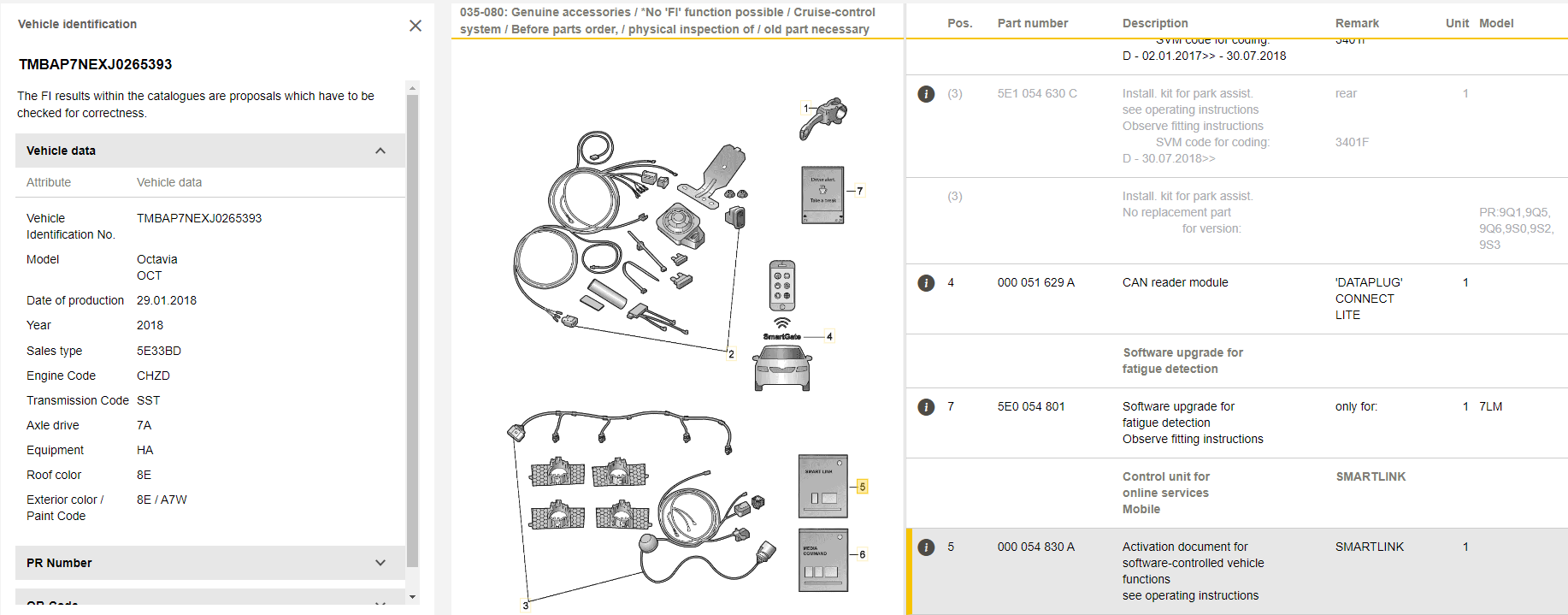

Well, looking at the unit I'm not 100% sure. Pls share VIN.
TMBAP7NEXJ0265393
Well,assuming there is no bug in the catalogue, activation is available for your unit - see screenshot below.

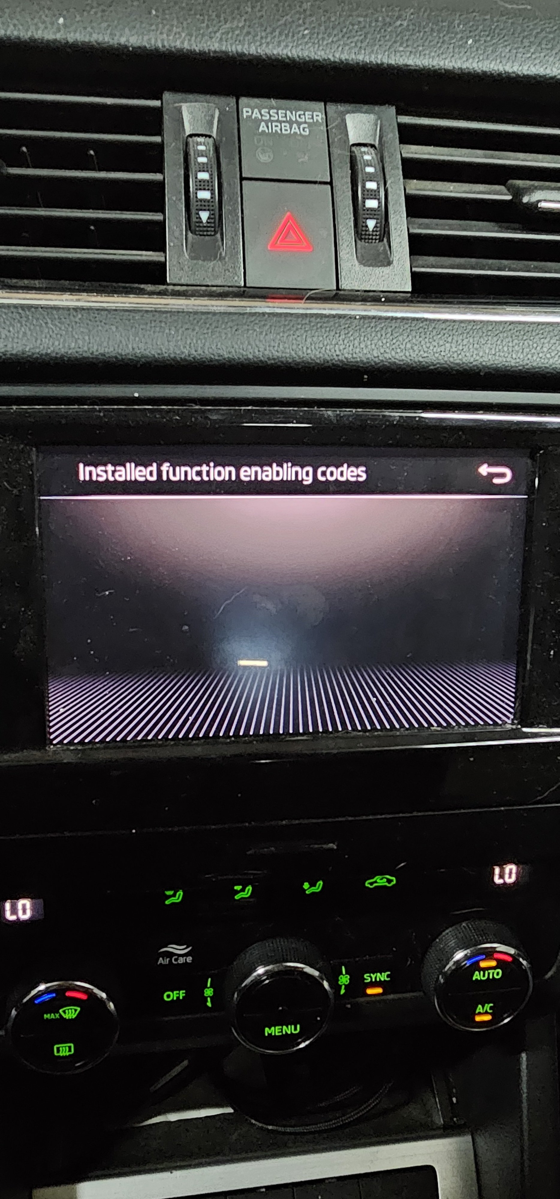

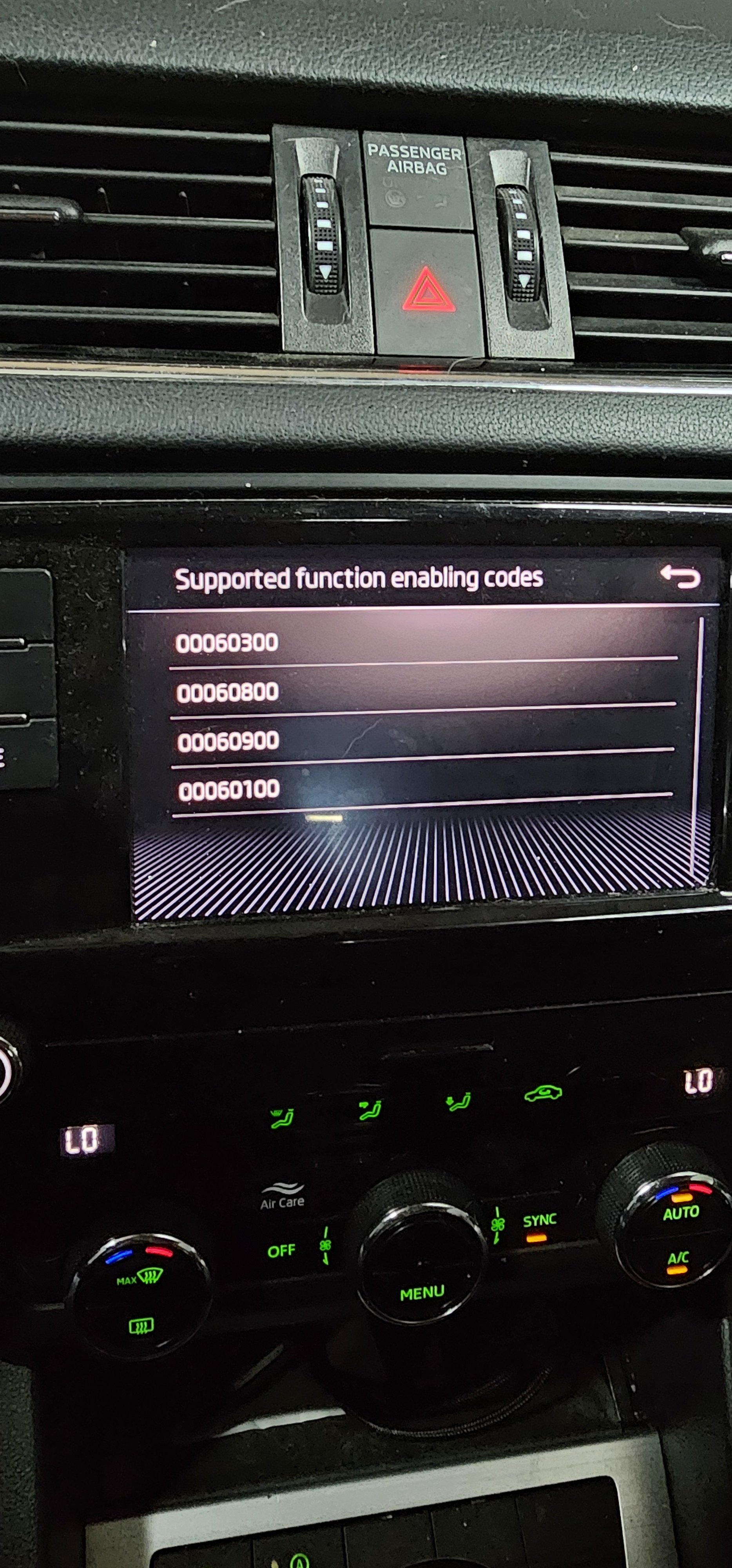

Make one more check. Go to service mode (long press SETUP button) then FEC/SWaP codes then supported codes.
Yep, your units support it, so you have to contact yoour Skoda delaer to have it enabled.
