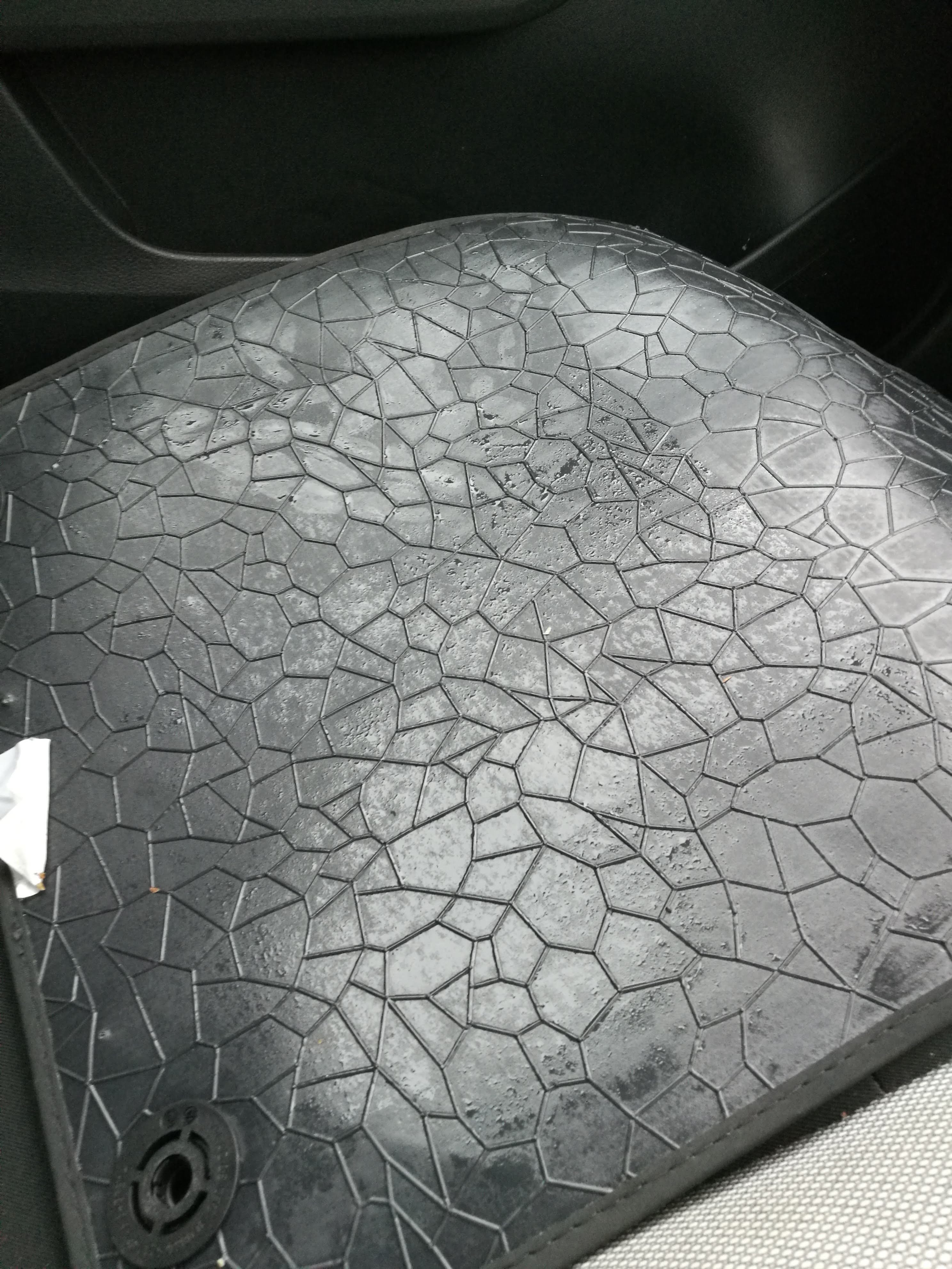

All was good until about a month ago I noticed the floor under the drivers mat was soaking wet, I dried it, put the mat back, next day soaking again, this went on for a week or two sk called skoda, they picked up the car and returned it to me the next day saying that they cannot find a fault.

(I have attached an image of how wet under my mat gets)

No, your new car should not leak water into the footwell. It will be interesting to see what the dealer makes of it this time. I will say water leaks can be very difficult to track down. We normally use a flurenscent dye to help diagnose where the water is coming into the car and it can take sometime to find it. Often when water is coming into the footwell it can be traced to poor sealing around the bulkhead area of the car. But of course, it can be a seam almost anywhere causing the issue or even a door seal. The thing to do is document everything that happens regarding when the car goes into the garage for checks and of course list everything the garage tells you. If you are not getting anywhere, then it's worth having a chat with the dealer principle by phone or email to tell them of the issue. Usually, bodyshops are good at finding water leaks as they know precisely how your car goes together. Let us all know what happens this time please. Good luck!

My wife's polo had a similar problem which turned out to be condensation leakage from the AC drain pipe.
Let them check that pipe, that it is routed to the hole on the floor for sure.
Agreed. Most likely the problem is that the condensation drain hose for the A/C evaporator has become dislodged and is draining in to the the interior foot well, rather then to the outside under the car. This is a relatively common problem and is (usually) pretty easy to rectify.

Beddiawl, do nothing. Let them get on with it. They will find it. This sounds like a heater matrix leak when under pressure. It must be a very slight one though. AC condensator leak would show easily by now.

Well, I have had the car 3 days, I am happy to report there is no more water, it did turn out to be as we all thought the AC outlet.
