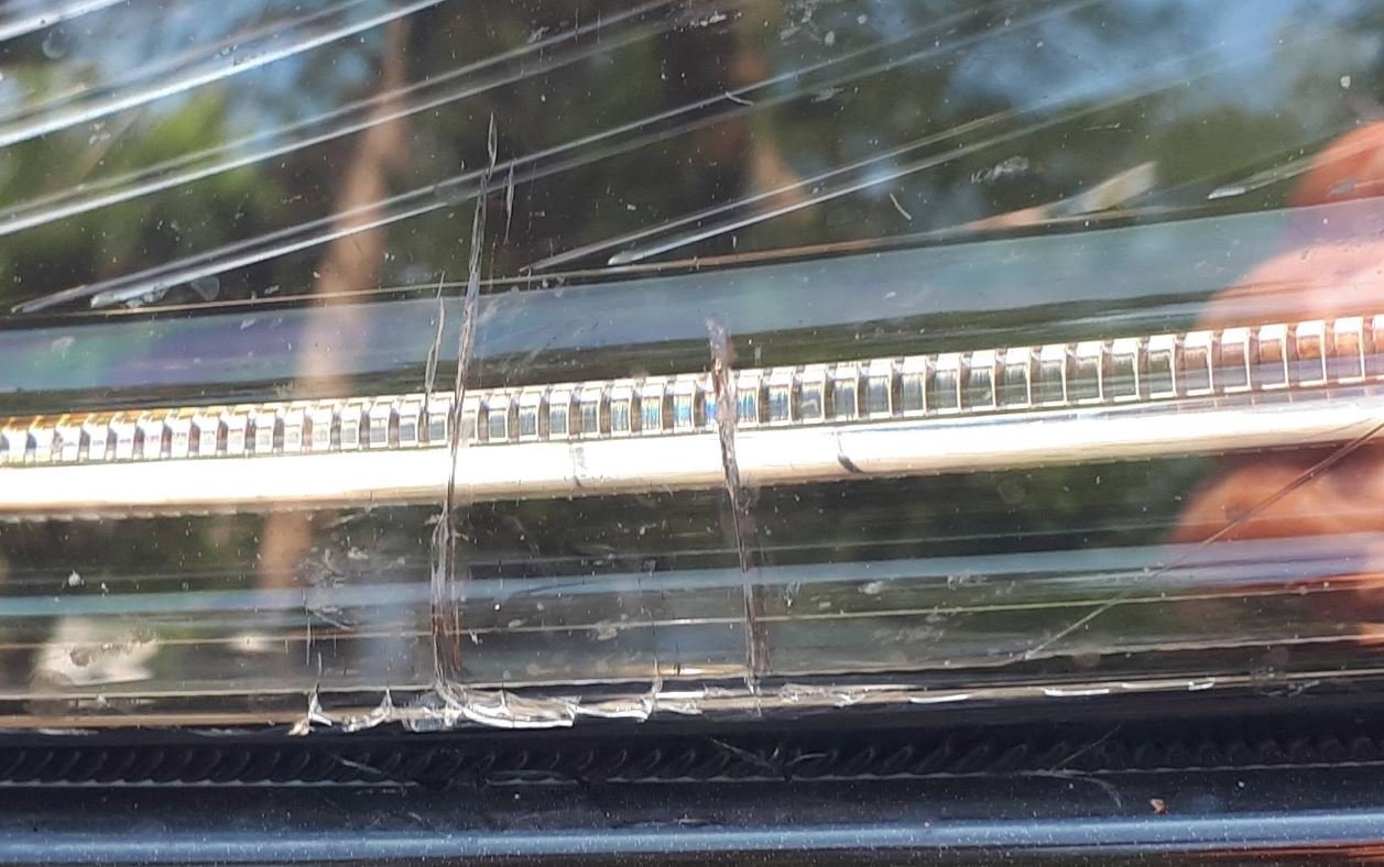

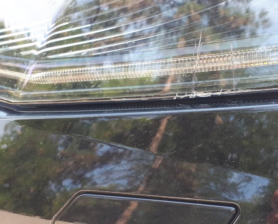

I have noticed cracks on both headlights on my Octavia 3. This is on the line of headlight washers so I suspect it is connected with washer. My Octavia is only one year old. There are also these cracks on Octavia of my friend that is 5 years old.

Here are the pictures...
That certainly looks like damage from stone chips. Looks like a stone has hit the leading edge and cause it to crack.

Alternatively, looks like someone has tried to remove the headlights by levering along the bottom edge. I'd say that the force has come sideways rather than an impact. Just a gut feeling after doing cerification impact tests on plastics over 4 decades.
I would not agree as there are 4 headlights with same demage (2 on my car and 2 on friend's car) on the same place which is just upper of the washer. I will check other Octavias in my company to see how their headlights looks like.
That doesn't look like a build quality issue.  It looks like some form of force damage.  How long has it been like that
Is there a local reason why this damage might have occurred (don't know where you are based from your profile) ?
Is there any damage to the paintwork immediately below the edge damage? If so, that would suggest an attempt to pry the headlight unit out of its mounting.
No local reason and no damage on paint. The damage is increasing with time. On the right headlight it is starting to show on the bottom edge of the headlight
Only two cars each with different headlight housings - that wouldn't suggest a manufacturing issue.  I agree it does look like they've tried to be prised off but can't understand why anyone would want to do that especially in that location. And if that were the case of prising with a screwdriver or whatever tool, then surely there would be damage to the bumper as well?
Would suggest stone damage the most likely cause.
