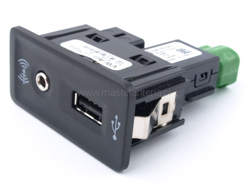

the blank socket is where the additional USB + Aux port goes - 5G0035222E.
i'm planning to retrofit it one day, but it involves getting a USB Splitter hub (5G0035953C - that gets installed inside the centre console), and additional wiring harness.

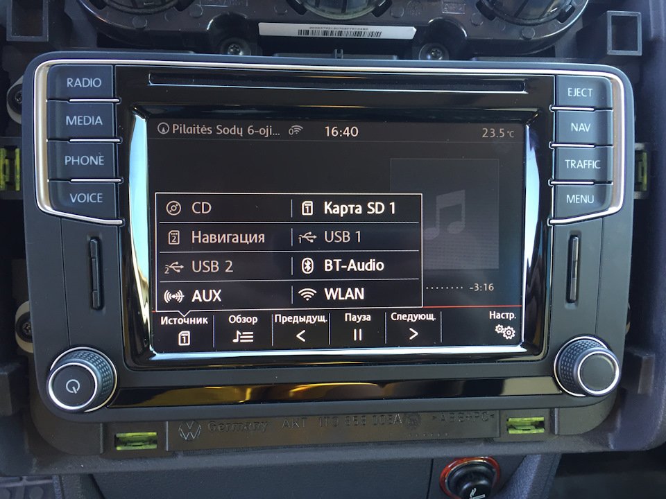

this will then give u a "USB2 " option in your infotainment screen.

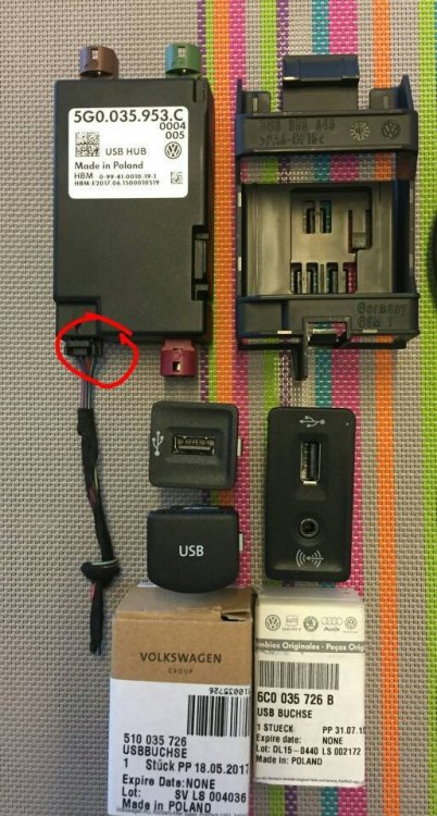

the more i'm researching about the usb splitter/hub, i'm finding that the hub needs to be powered (circled in red in pic below).
this involves tapping into other wires and bits :(

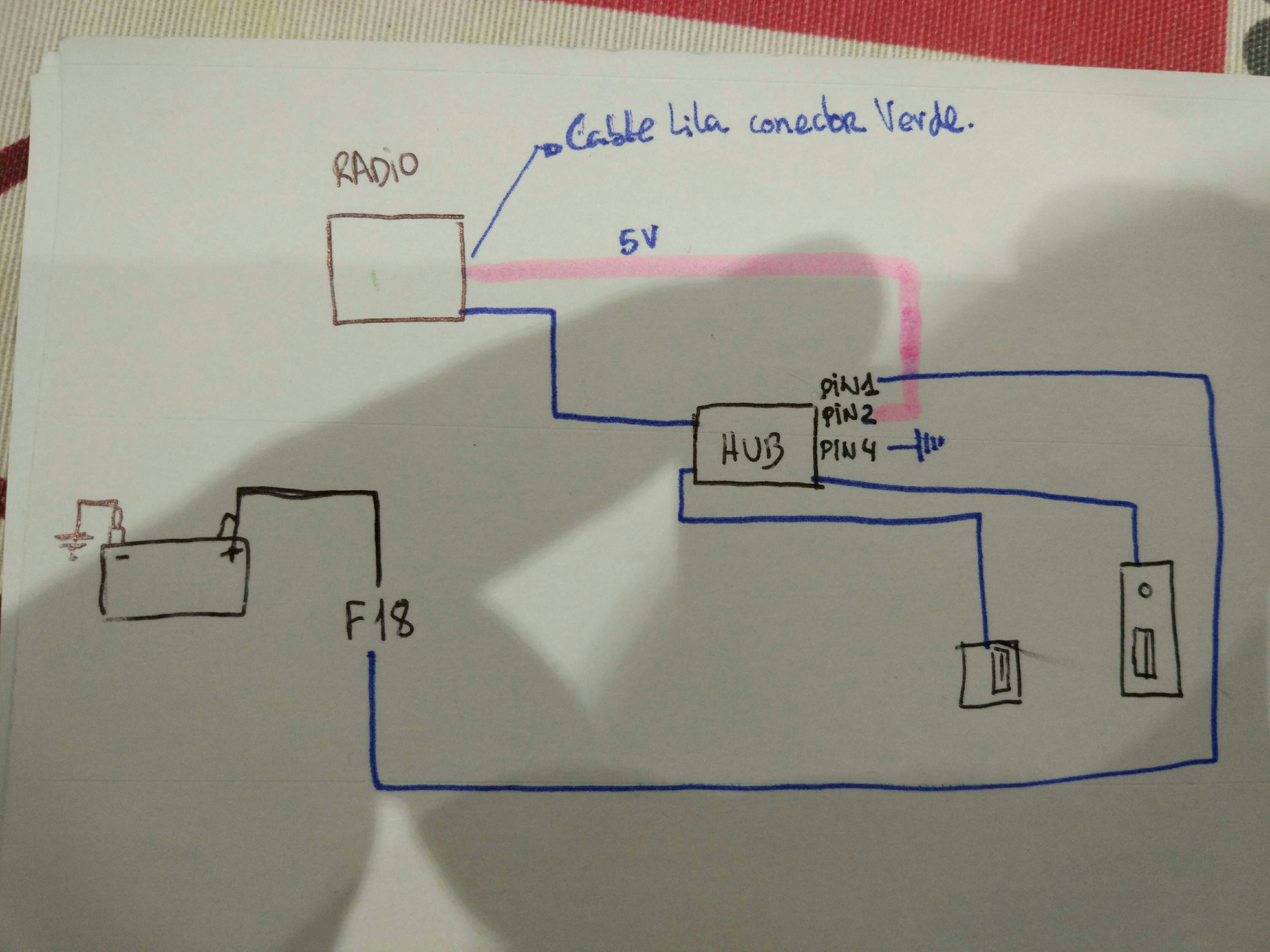

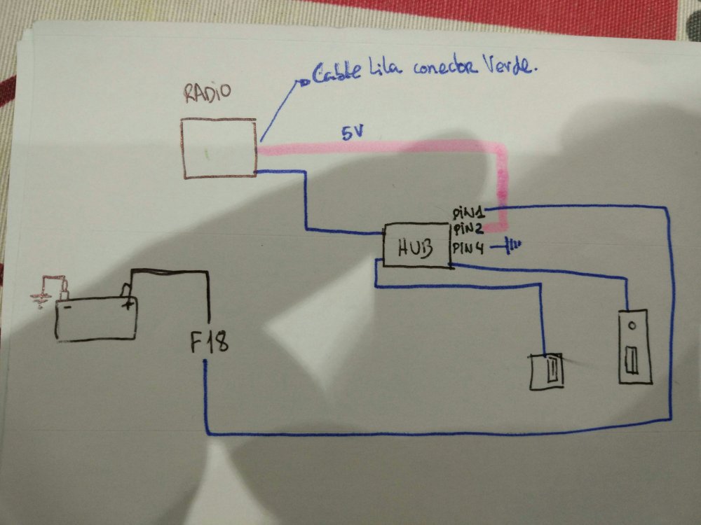

Looks like the only extra wires that would be needed are a 12v feed from fuse box and a ground. All others are reused from existing fakra connections and one red wire from the green block of the quad lock. (Top part of diagram is without hub, bottom part of diagram is with hub R293)
BCM not involved.
This kit has all the wiring. Would just be the actual usb port needed.

You can see part numbers in the photo post higher up this thread. Only thing it won’t have is the cables. But you may be able to get just the cables from Ali express.
