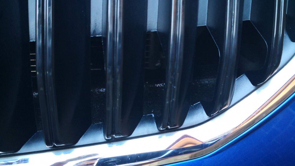

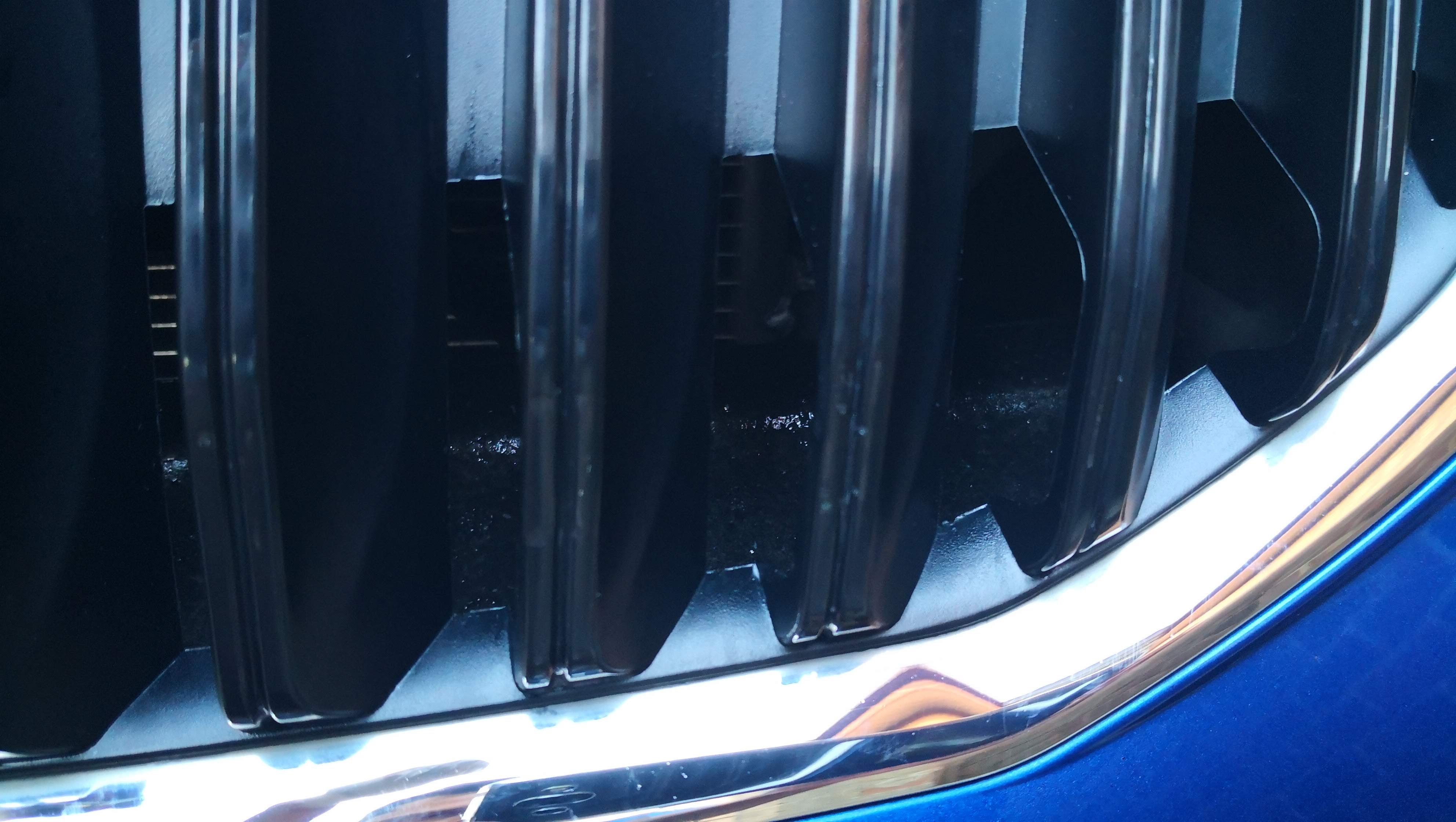

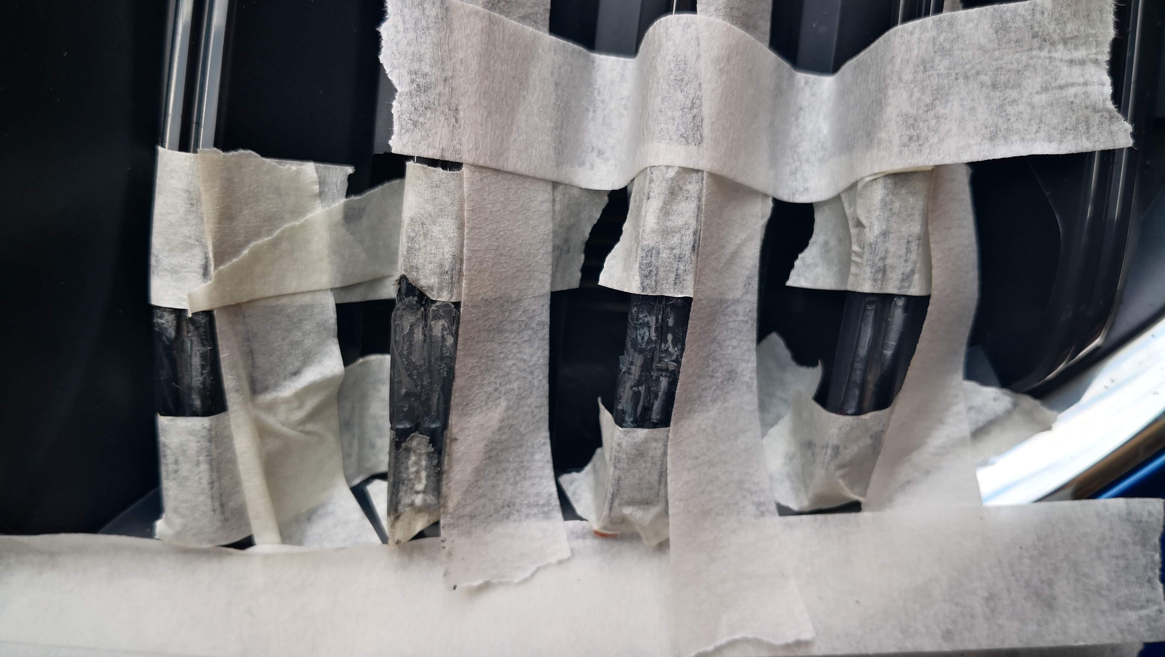

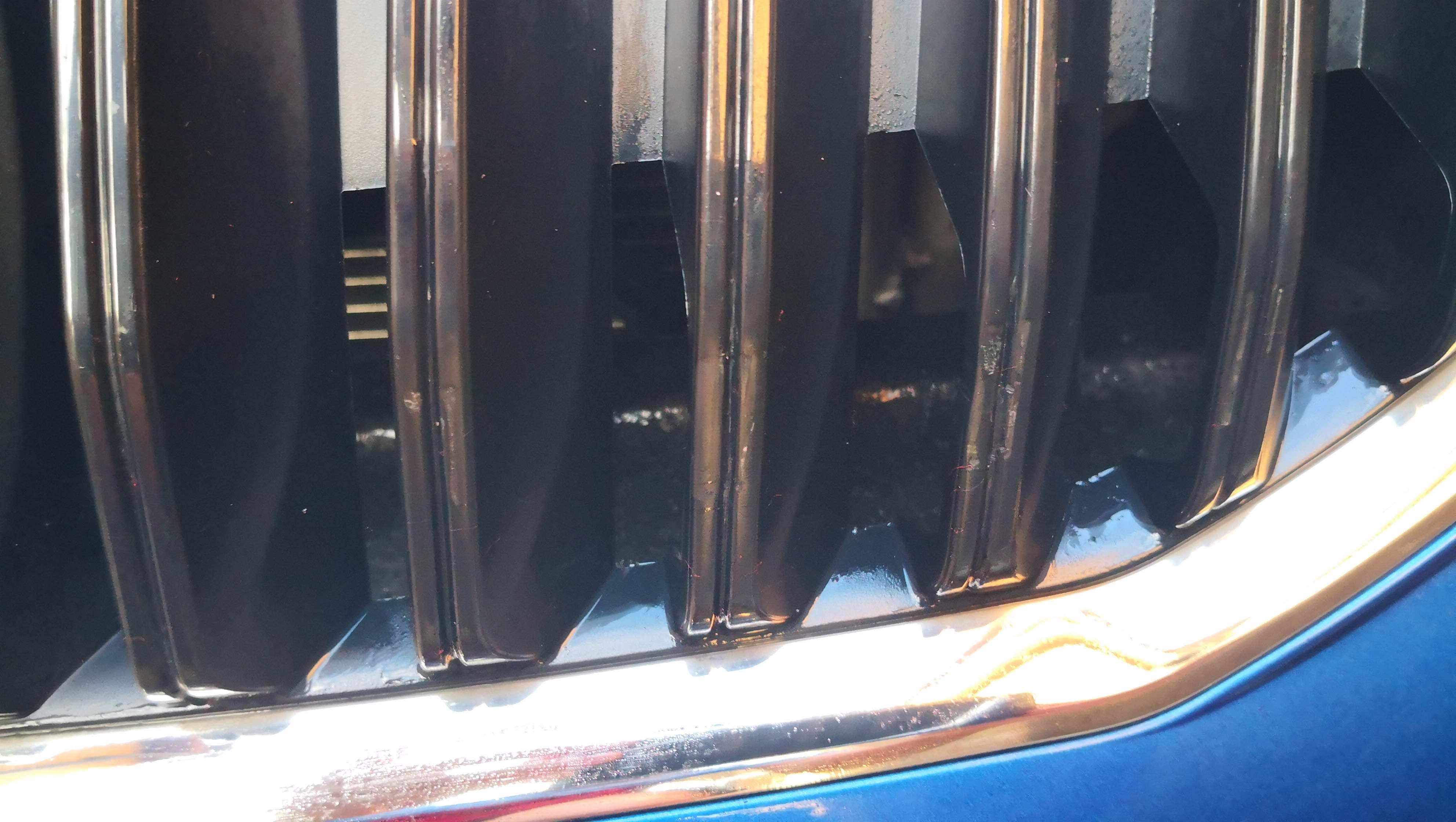

So i used a flat head screw driver to prize the chrome lettering of which exposed the back plate, now im not sure why the heck Skoda decided to more or less weld the plate to the grill and make it almost impossible to remove without  messing the grill up!??. I had to cut the back plate into sections and then used a craft knife to get in between the back plate and grill and slowly wiggle the knife back and fourth until i cut through.......which kind of left me with this eye saw.......
at this point i papped myself and was consigned to having to buy a whole new grill!!!. But i decided to try and save the situation and got a couple of sheets of wet and dry sand paper (800 and 1200 grit) and started off by using the craft knife again and shave off as much of the back plate as i could without cutting into the grill itself, i then scored down the center of each grill segment to get the plastic out of the crevice to allow for the sand paper to fit down. After a few passes with the sand paper i had this result......
better but i still wasn't happy with it.

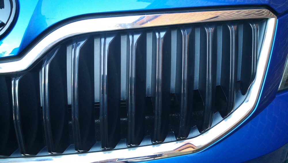

After about another 30 minutes of using 800 grit and moving onto 1200 grit to give a smooth finish i was presented with this......
a lot better i think you'll agree and from a distance you cant notice at all......
but i know its there so im hoping that they do the 'black magic' colour in a spray can and will finish it off with that and hopefully then you wont be able to tell even with your nose up close to the grill.
Im rather happy that i managed to save the grill to be fair as when i first got the back plate off i thought i had completely bugger it up.
