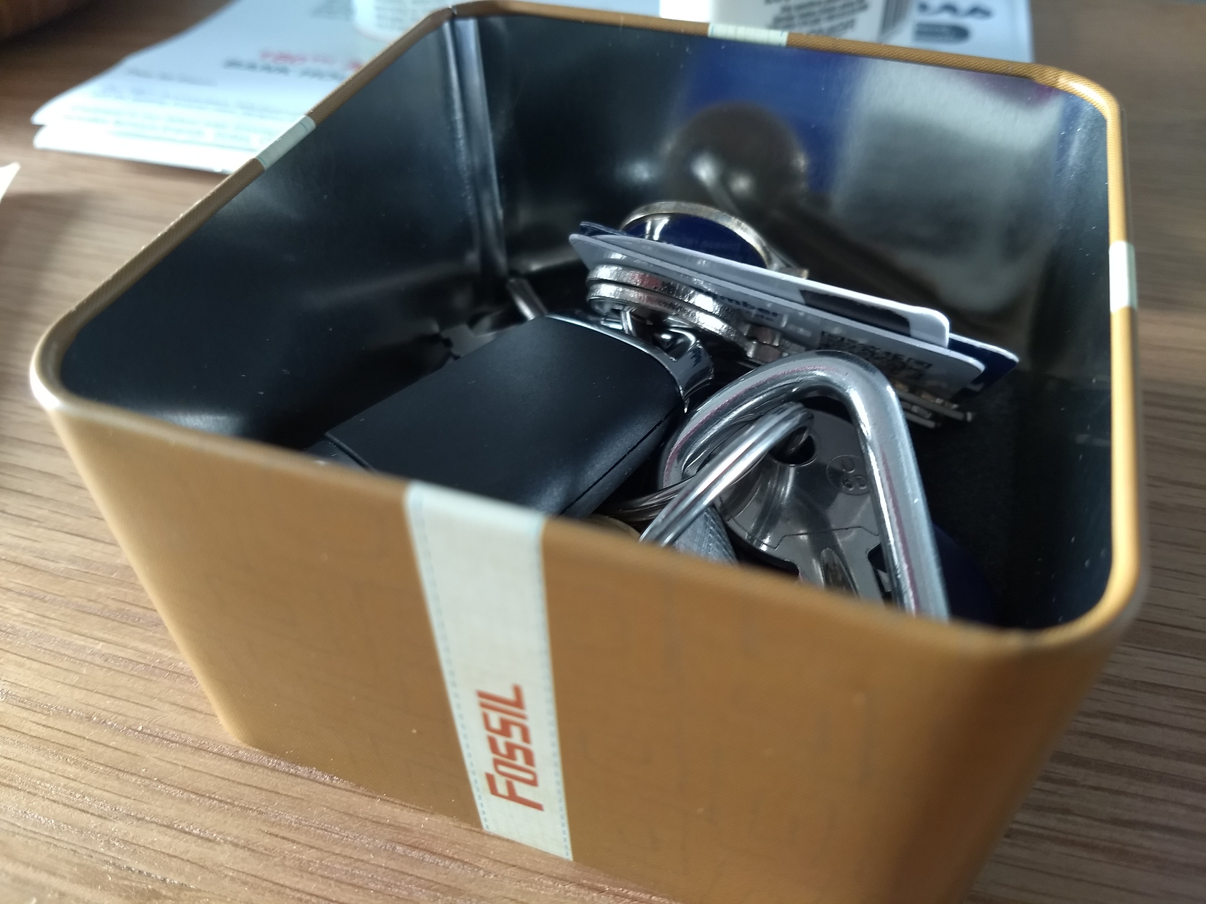

Now that I have Kessy, I’ve placed a little hinge-lidded metal tin in the drawer, and pop the keys in there. Quick and easy.

I’ve tested a few things and I’m going to go with a hinged biscuit tin! Works perfectly and satisfies my innate laziness.

We keep all of the KESSY fobs (4 of them, including spares) in a copper clad lidded biscuit tin. I've tested it by pulling the door handles with the tin right next to the car - nothing. The only thing is my neighbours probably think I'm a bit mad.......

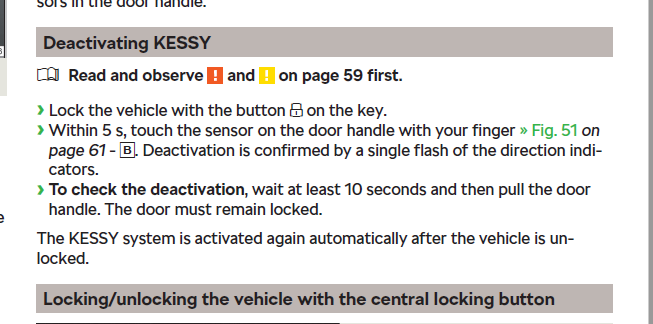

If you check the RTFM it shows how you can do a little routine each time you lock the car, which will disable keyless for that cycle.

Press the lock button on the key, then within 5 seconds, press the lock button on the door handle.
Thanks @StewartM - I think I’ve done that by accident and wondered why I could re open the door afterwards!

Fossil Watch tin.....with lid obviously!
Similar setup here, an old tin does the job admirably!
So, the solution is to do the above when at service stations, or going to stay near the car for whatever reason, and biscuit tin when at home. Perfect. Thanks guys.
I tried the above Key Deactivation trick today. It didn’t work. Not that I’ve ever considered deactivating my KESSY as it’s one of the best features on the car (refer to Audi, Mercedes et al for how to deliver half a job).

It's either faulty or you didn't do it right :D
Or, the description in the manual is wrong. I'd go and test mine but it's 22:45 and time for bed!
