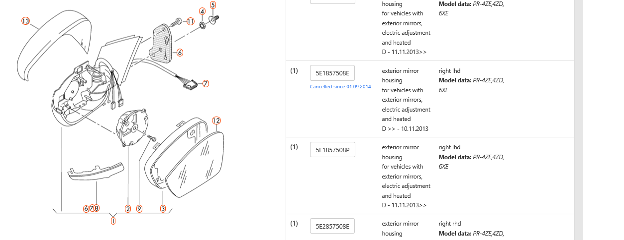

One thing to note is that we don't really want the whole wing mirror assembly, just the folding element. We don't need the glass.
We need Number 1 from this pic only:

It gives you the part number to an extent but it's the final letter that we aren't sure of as there are lots of versions of the same part (some with and some without electric folding)
check the relevant PR codes. It's eiither 6XK or 6XL in the >2013 model.
Depending on your precise timing - when was the car registered? - and the specifics of the PR codes.... 6XK is without memory. I'd expect 5E2 857  507 AB and 508 AB to be correct. But you need to crossreference your car's build date and spec.
€360 seems to be a price for one.
5E2 = RHD
5E1 = LHD.

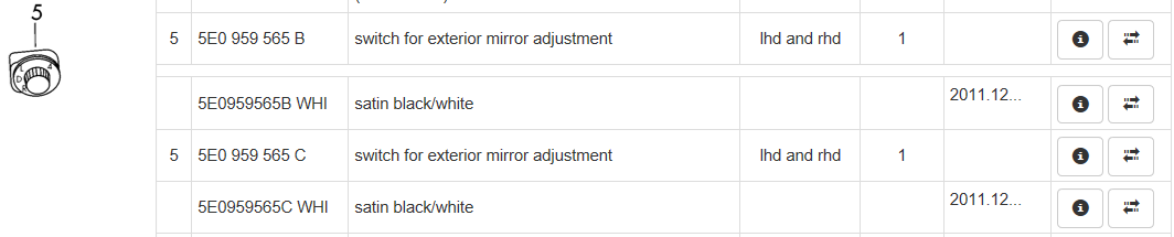

I've located the switch part number: Doing a quick google search of both part numbers ending B and C shows that the one ending C is the one with the elec folding option.

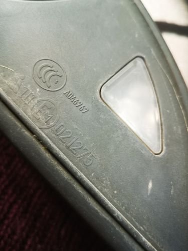

Anyone know what this is on the bottom of the wing mirror?
technically called a puddle light

Yep fitted as standard so I don't have to do any mods (thankfully!). The puddle lights look pretty cool but I don't think they serve much purpose when stationary B)

nothing, looks like part 7 connects directly to the control switch?
