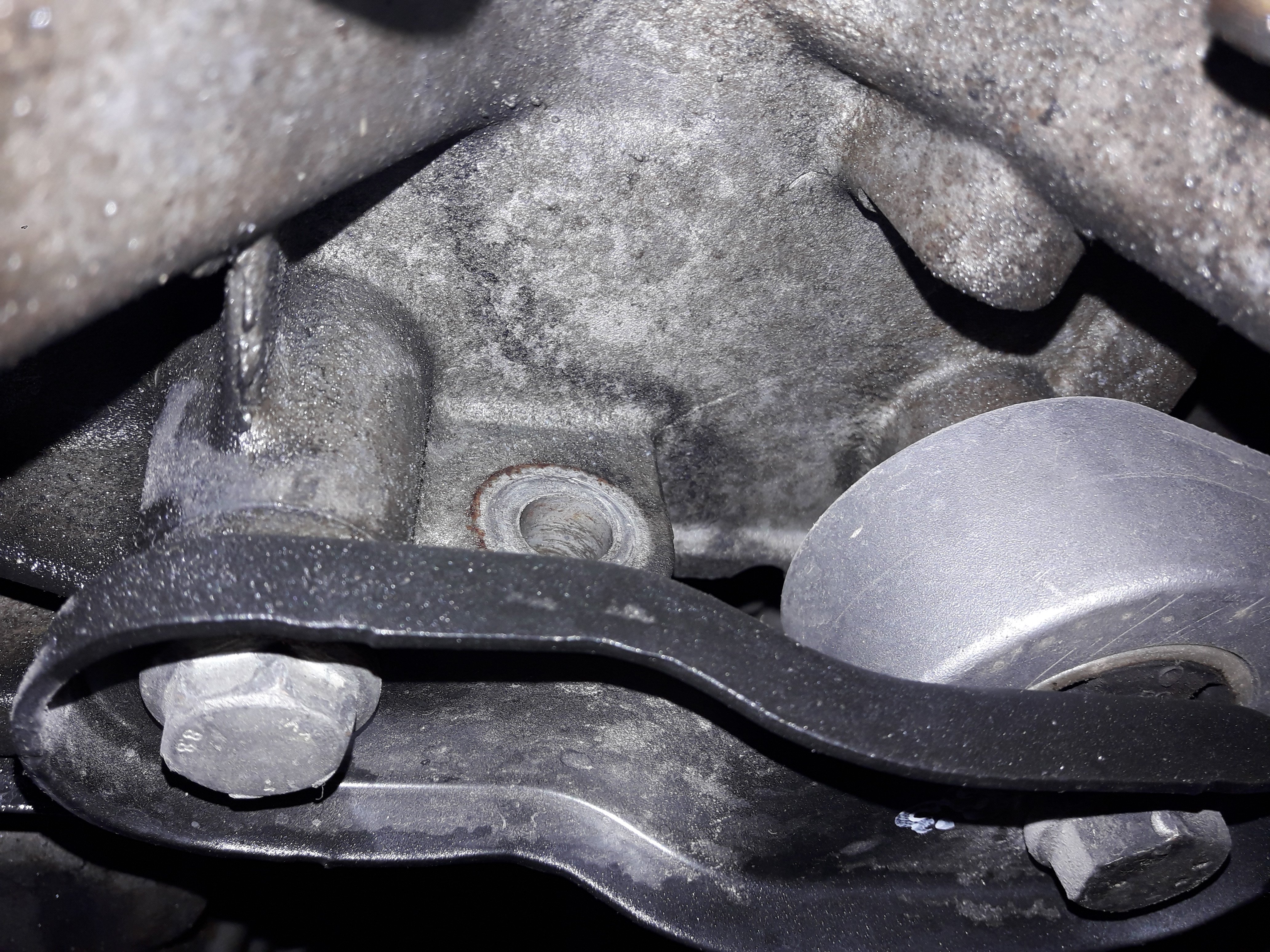

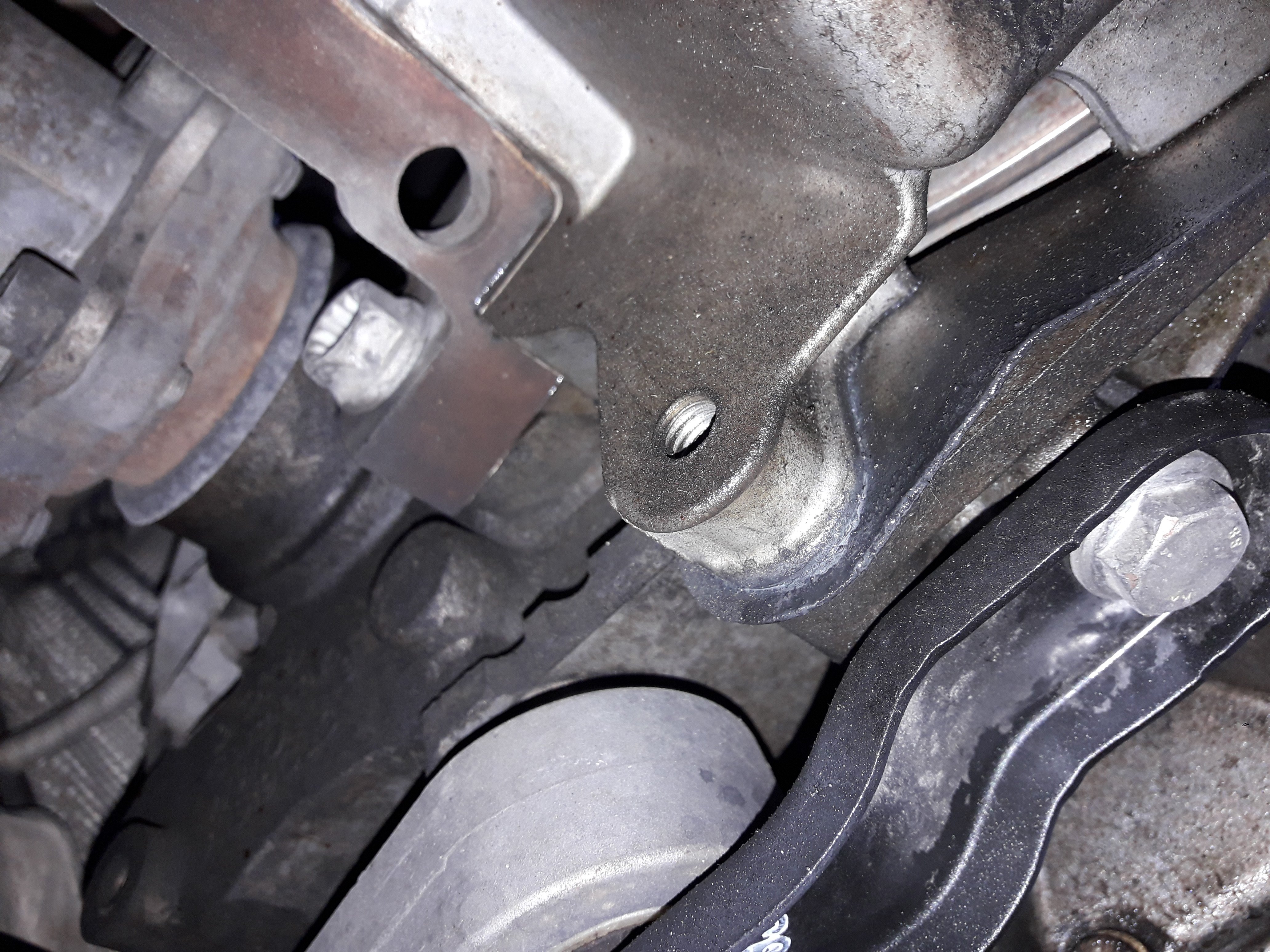

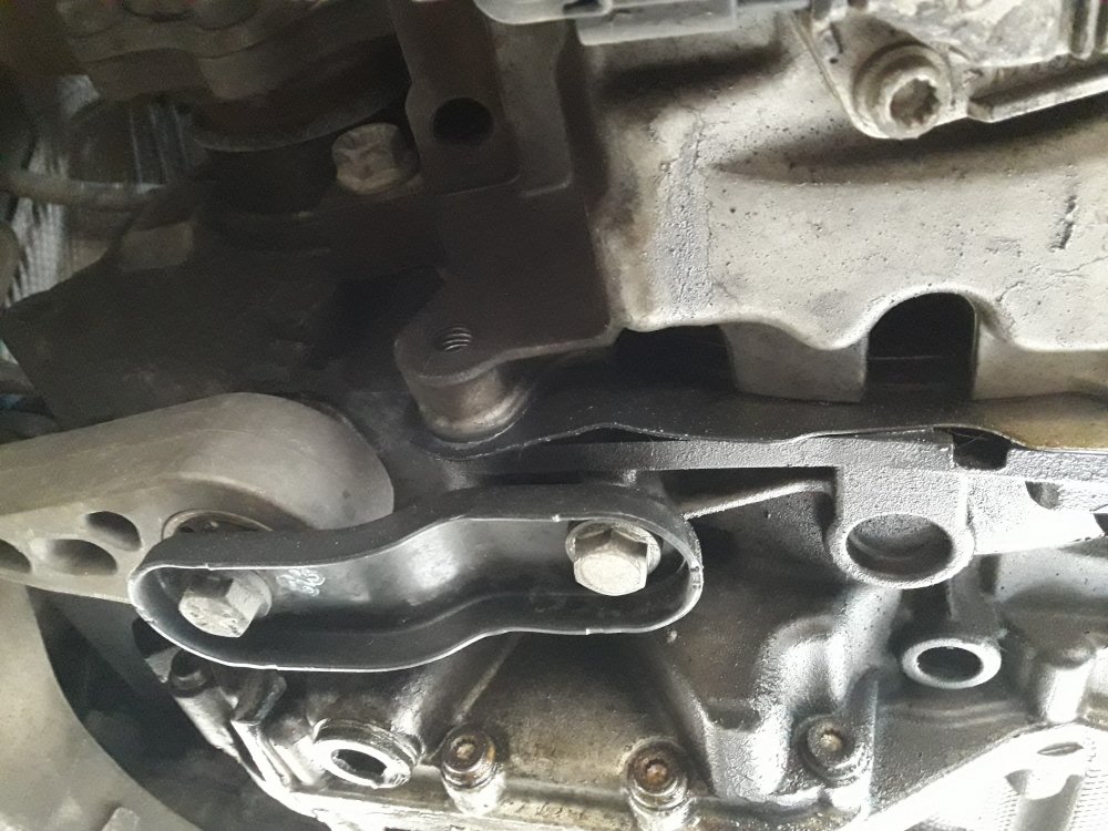

In my octavia tdi 1.9 bxe engine there's a missing screw.
Would like to know which screw is it to order it.
Adding some pictures.
Looks like a M10 x 50.
That's a very wild guess!

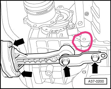

I think its this area. But the picture is from mk1
Obviously the bolt and washer are inserted from the side shown in your middle picture. I'd get hold of a standard M10 bolt and see if it fitted the thread as shown in pic1. If it is a M10 then you just need the correct length and grade. You can measure the total depth required easily enough and I'd suggest a 10.9 grade at least.

Yes, but we probably need to know the gearbox code. This will be on the options sticker near the engine code. Year of the car may also help.
If you go here there are a number of diagrams which show bolts connecting engine and gearbox, but there are variations with different gearbox codes: https://skoda.7zap.com/en/cz/octavia/oct/2004-419/3/
Knowing which diagram to reference will be a good start.
