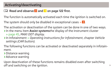

■ If an automatic brake intervention is triggered by the system, the pressure in
the brake system increases and the brake pedal cannot be operated with the
normal pedal stroke.
■ The automatic braking interventions can be cancelled by pressing the accelerator
pedal or by steering intervention.

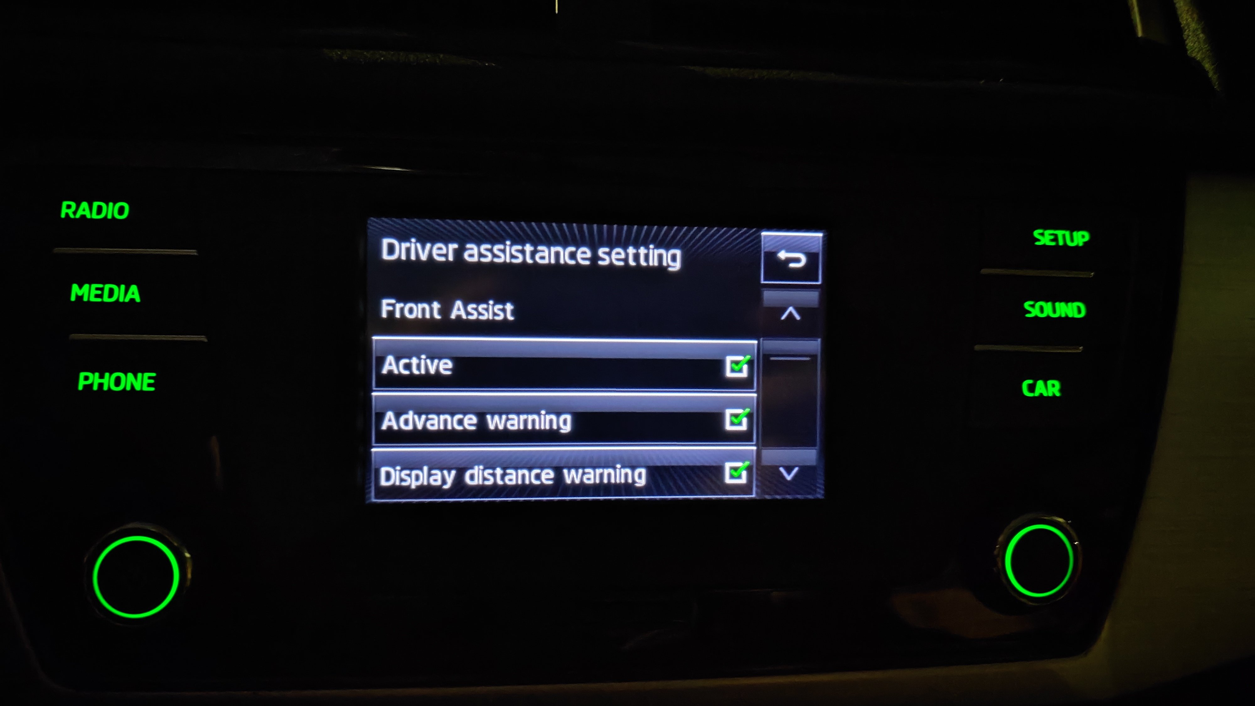

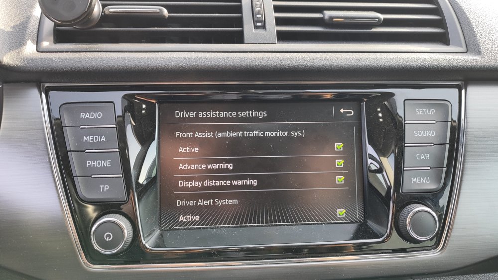

@AGFalco, both are set the same, please check the attached pics. As you can see, the menu seems to be different. While the hatchback displays less options on the SWING radio, the estate displays more options on the BOLERO.
@Marty_ro my wife's 2015 (hatch) also has a Bolero but the Driver "assist" displays less than your phot, do you also have the follow-the-car-in-front traffic-train active cruise control?
