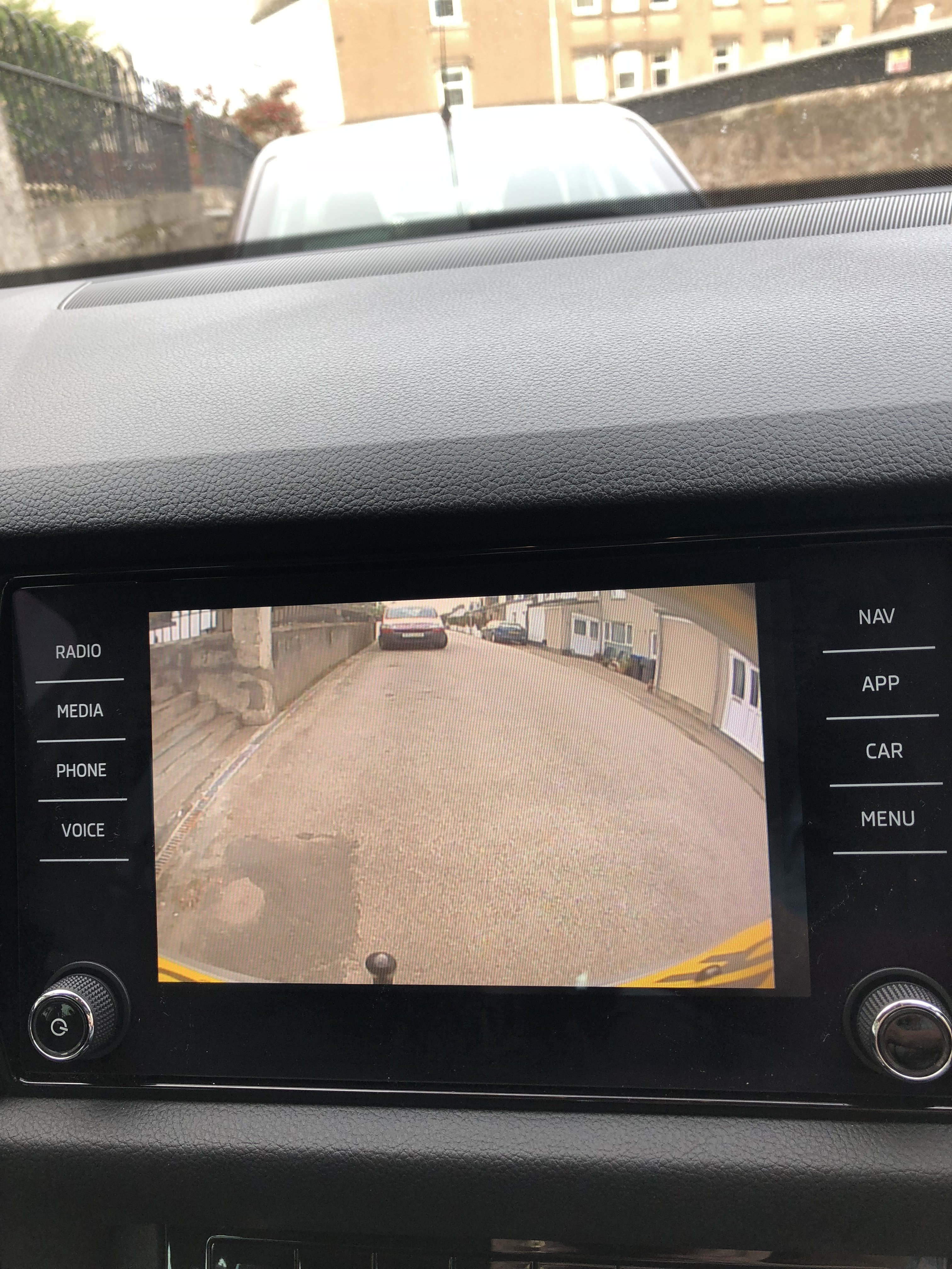

Skoda dealer arranged to retro fit a reversing camera to my 2018 kodiaq SE but when got car back I was just like looking out a window with no guide lines does anyone know how I can get the guide
lines the picture shows what I see.

I believe there is a low and a high version camera. The high version has the guide lines that change with steering input, and also has different modes.
I thought the low version had the distance bars but they didn’t move. Could it be your dealer has fitted a 3rd party camera.

Hi
The dealer retro fitted the reversing camera on to my Kodiaq, I have no idea if it was a low version or a high version, but it does show the parking guide lines which move dynamically with the steering wheel.  I also have the ability to view the camera in a straight down position or or in the standard reverse position. My head unit is a Columbus 2017 version (two buttons and smaller screen)
I have also read about some VCD or OBdeleven coding that have to be completed to give the full functionality I did see this somewhere on web.

At least for Superb II there is a separate module, which transfers low version camera into high - the same that creates the quiding lines.
I have tried touching the screen but nothing happens I thought that would be a way to change views but this seems to be the only view I can get the radio was upgraded to a Amundsen in my 2018 SE so thought it would be easier help
Might be worth asking the dealer what it is exactly that they've fitted?

I am 99% sure that an aftermarket camera has been used. If you look at the reversing camera, it should be integrated into the handle/button for the tailgate. This is what you need to get.
I'd be a bit annoyed if a franchised Skoda main dealer was using non-genuine parts.

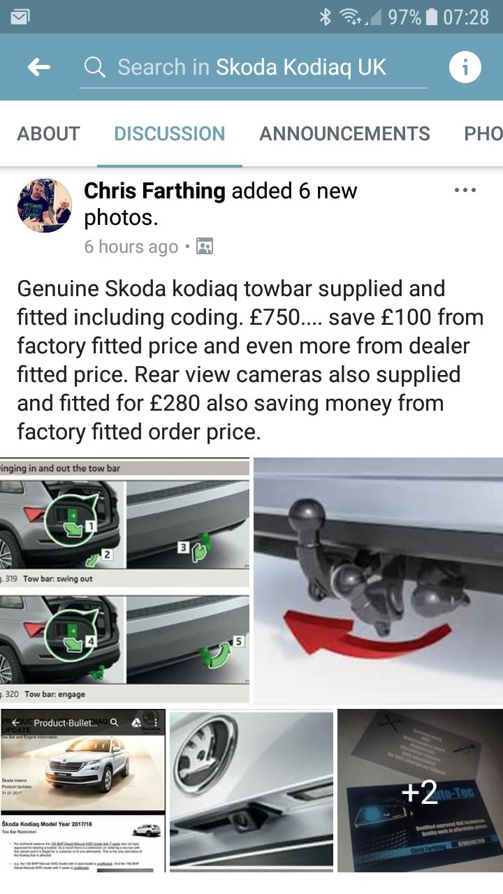

This guy fits the genuine kit for £280...

Hi - I have just bought a kodiaq and looking to retrofit some items but cannot make out the auto tec contact details on your image. Could you possibly send them over to me?  Many thanks,

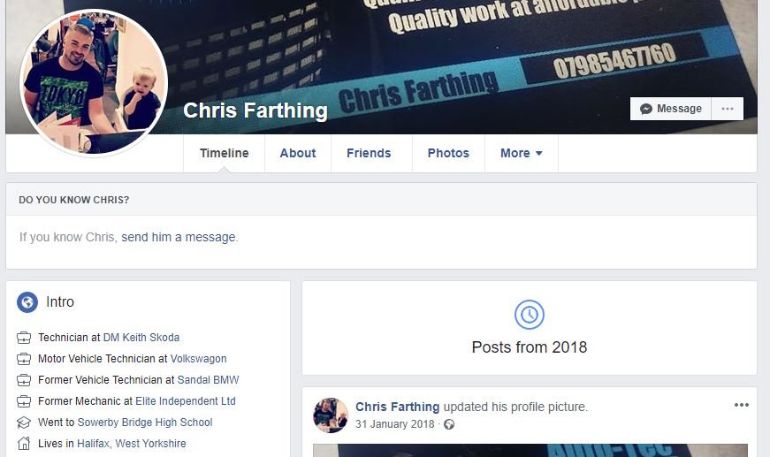

Are you on Facebook? If so search for Chris Farthing.
If not you can see his contact number in the top right corner...
He works for DM Keith Skoda in Yorkshire which may be a bit of an issue if your in Buckinghamshire?
Hello - thanks for the advice.  Unfortunately i am too far away for him.  i have seen a firm called 'vagtec' advertise their reviews make them look shambolic.  Does anyone have experience of them or anyone else?
