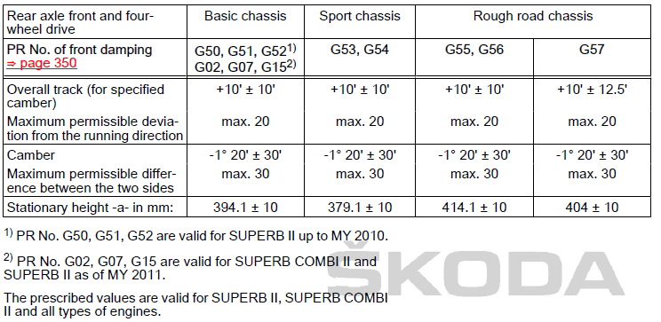

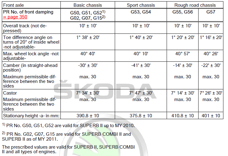

What engine is fitted? That will have some impact on the suspension settings at the front since the front suspension has to carry the weight of the engine. Also, what year is the car?
These two tables show the suspension geometry settings for the different models, pre-facelift: it might give you some guidance. Stationary height is the ride height, measured from the centre of the wheel to the edge of the wheelarch. If you're looking for a modest drop, perhaps the OE sport chassis is the one to go for?
front_suspension_settings.png.31094408166b72805fb1932d956ac934.pngrear_suspension_settings.png.14afc3433a59fa33c06313dbf47f4d83.png
