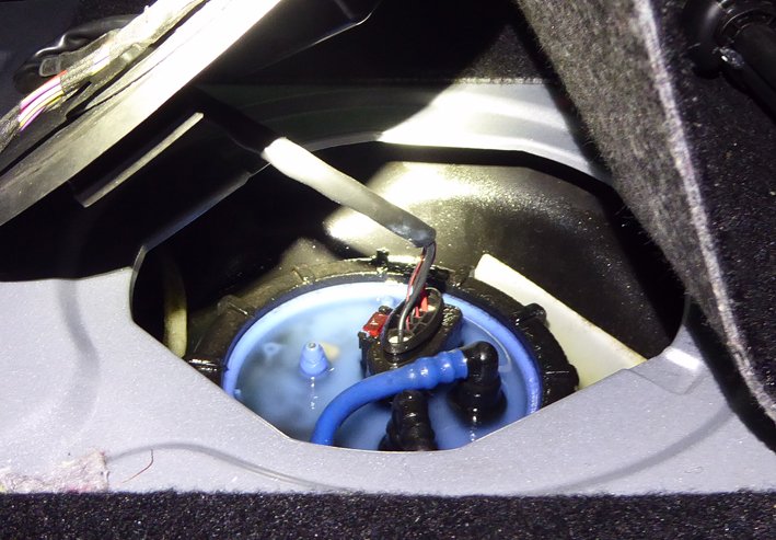

Got it!
No sign of a leak at all underneath the car this morning. Looked under the rear seat cushion - thanks AG Falco - and removed the inspection plate. Bone dry. Probably touched the pipes but didn't do anything much...
Went away for some hours, came back and looked again.
A mark on the garage floor under the fuel tank. A drip hanging down from the bottom of the fuel tank. And fuel covering the blue plastic cover that houses the overflow pipe and fuel level gauge - see photo! If we press down lightly on the blue plastic then fuel wells up. Maybe there's a problem with the gasket or the black plastic lock ring isn't tight enough?

Eek!
Most dangerous thing I've see in a while. Don't smoke in that car whatever you do.

Get it looked at asap though, and check it after it's fixed to make sure it really is. (The lack of smell will probably be all you need to tell that it is fixed TBH.)
If the dealer tries to charge you anything for rectifying this, I'd be disappointed, given how deadly this could have been. Print that photo out and take it with you.

4 minutes ago, KenONeill said:
@oscarl - Well, my advice is to never repeat never fill the tank above about 3/4 until this is fixed.
 Not even that. It looks like a leak from the pump itself or piping. It is dangerous to drive as it is. Especially as the petrol is splashing around an electrical connector!!
Get it recovered into the dealer.
Also @Tech1e  Ah yes OK. I'd thought that was the level sender and not the fuel pump.

Skoda Roadside Assistance told us not to drive the Roomster as it was "highly dangerous".
It was recovered to local dealer DM Keith in Bradford. They reckoned the car, which I'd bought from Simpsons Skoda in Preston 6 weeks earlier, had been "misfuelled" and this must have led to a split in the seal of the fuel tank. This meant it wasn't covered by the year's Skoda warranty. They conceded they had never seen anything like it before but ruled out that it could be a faulty part.
Since the car had only had one previous owner in 3 years it seems unlikely to me that they misfuelled it with diesel.
Simpsons said all the right things but didn't/couldn't really help. I found DM Keith rude and unhelpful and spent hours calling them because they never returned my calls. Skoda UK were helpful to begin with but in the end wouldn't budge or pay out. No courtesy car was provided by any party even though this is our only car. It was a highly stressful, deeply unsatisfactory experience which left us with no faith in the dealership or Skoda UK. We paid £120 to have it fixed so we could have our car back after 10 days.
This is so wrong on many levels. It is absolutely impossible to misfuel a petrol car as a diesel nozzle will not fit in a petrol filler! (Only the other way round is possible). Also Consumer Rights act applied in this case. The fault was reported within 6 months and it doesn't matter what the previous owner did or did not do or what any dealer thinks about the fault, the supplying dealer is responsible for fixing unless he can prove the fault did not exist at point of sale.
