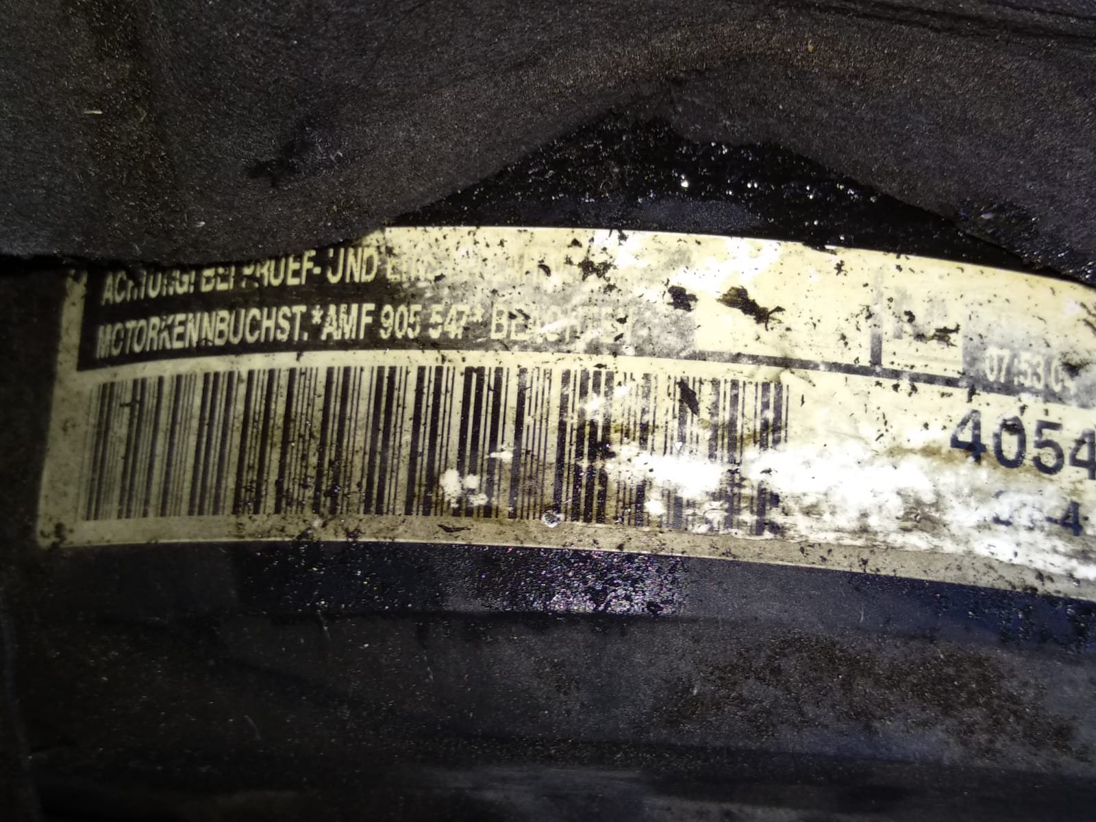

I am not sure how I find out which exact model I have. All I know is that it's a 2005 estate

Engine code should be on the sticker on the top cover of the cambelt; or on the data sticker on the boot floor.
@wodgey -
1) Find your engine and gearbox codes, or failing those your chassis number.
2) Take it from there!

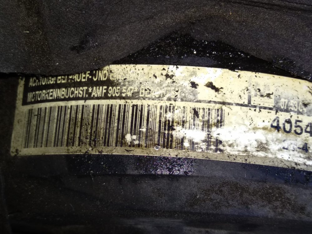

Here's the sticky label from the cambelt cover. It's a little tatty. Does this include the info I need?
The clutch I have purchasded is the LUK 622 3018 00. Have I got the right one?

You have an AMF code engine.  Written just to the right of "Motorkennbuchst"
According to @rone18, the LUK may not be right for that. Hopefully he or someone else can confirm.
That isn't the same kit sold by Euro Car Parts. A quick Google shows it as suitable for the higher powered engines including the AMF, so looks like it'll be fine.
TheLUL one from ECP has a really small band of friction material on it. That one looks like the Valeo one I fitted :-)
