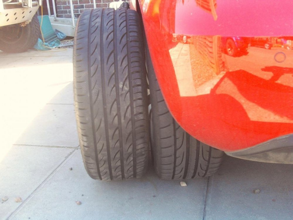

Always worth measuring old and new tyres side by side.  Just because both say 205/40 R 17 does not mean they are the same size.
Pirelli Zero Nero can be bigger than Dunlop Sport Maxx and the Rain Sport 3 can be bigger than Dunlop Sport Maxx in the same size.
205 is the tyre width, not the tread on the road width.
http://kouki.co.uk/utilities/visual-tyre-size-calculator
On the rear here.
The Pirelli that Skoda fit when customers complained of Pulling to the left. The Dunlop is on the car.
Hard sidewall and compound tyres with less tread on the road next to Dunlop Sport Maxx.  Both are 205/40 R 17.
On the front is a 215/40 R 17 M&S marked tyre, and the 205/40 R 17 actually is bigger, bigger circumference.
