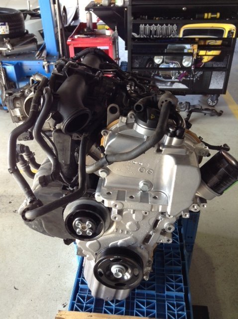

Picture of Mr J's new engine.
There used to be plenty pics in threads of new or as some were 'Refinnished' engines from VW in the Crate and going to be fitted.
