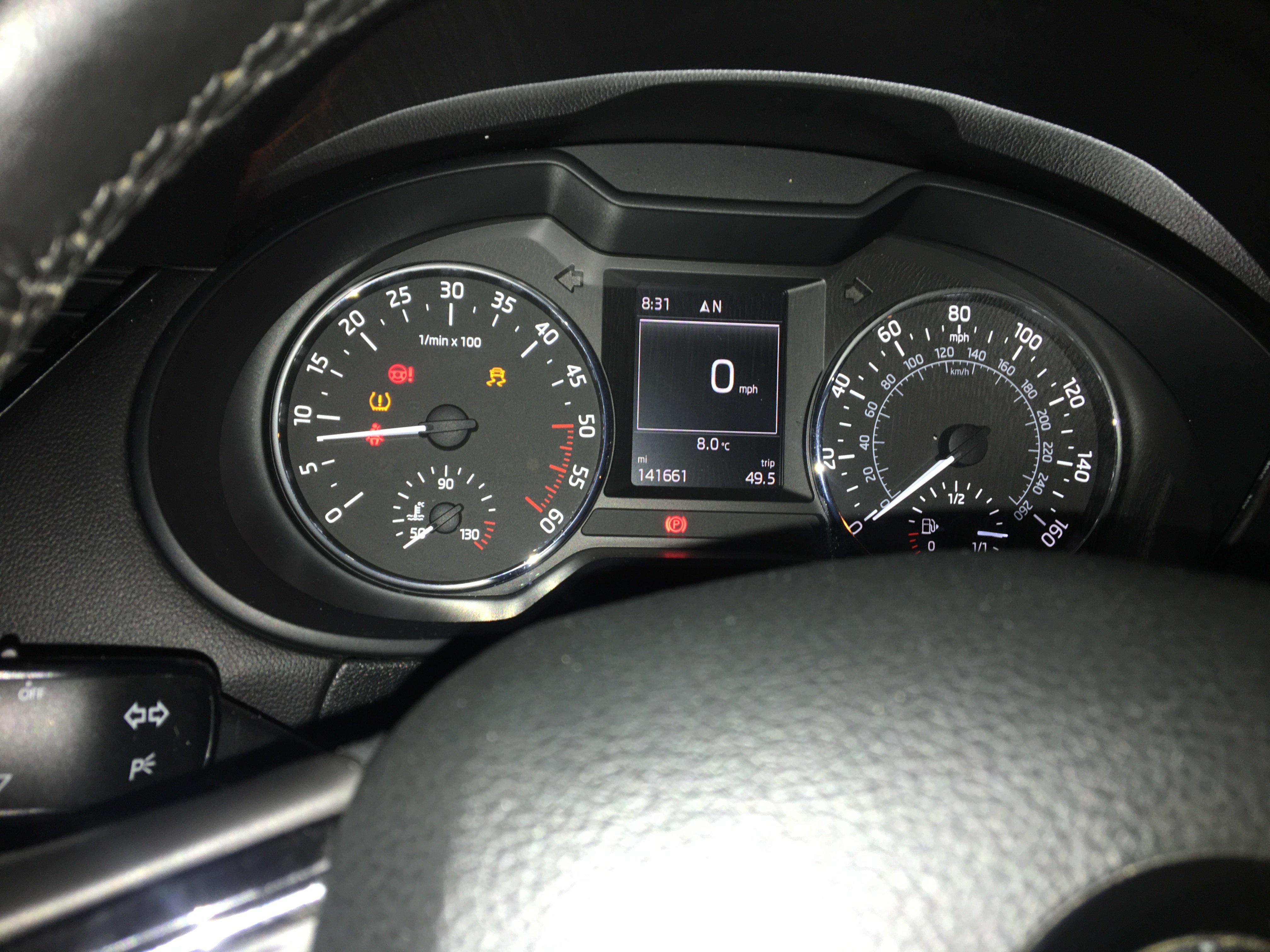

Skoda Octavia 2.0tdi, elegance, after a couple of weeks once you park the car and then start it back shortly, it does start but the steering lock freezes, esp light comes on with a quite a few other lights. Some time it takes a few minutes + attempts of starting and comes back to normal but sometime it can take like a half an hour or so .. it happened after I changed the timing belt and water pump of the car but if something was not done properly then surely the problem would happen again and again

been tested the battery which which was low but then he goes the alternator is not charging it. So was about to change the Alternator but mechanic goes it is not that. This time the power steering was not working at all and sign on the dash for steering, esp and start stop. Go it diagnostic and it showed steering column sensor which means it’s the steering rack. Called AA who did diagnostic and then said either ecu or the steering senor which can’t be changed alone so it is the steering rack. One thing I forgot to mention in the diagnostics it was saying under power to the sensor. At this time I have been driving it around for a couple of hours but no luck then it turn it off when I go to the last garage for his opinion and the power steering starts to work and after a quick drive around all the lights go off and start stop etc works .

These lights are on Dash board but codes to come power steering rack.  Check battery power seems okay. New power steering rack is costing around £1200
