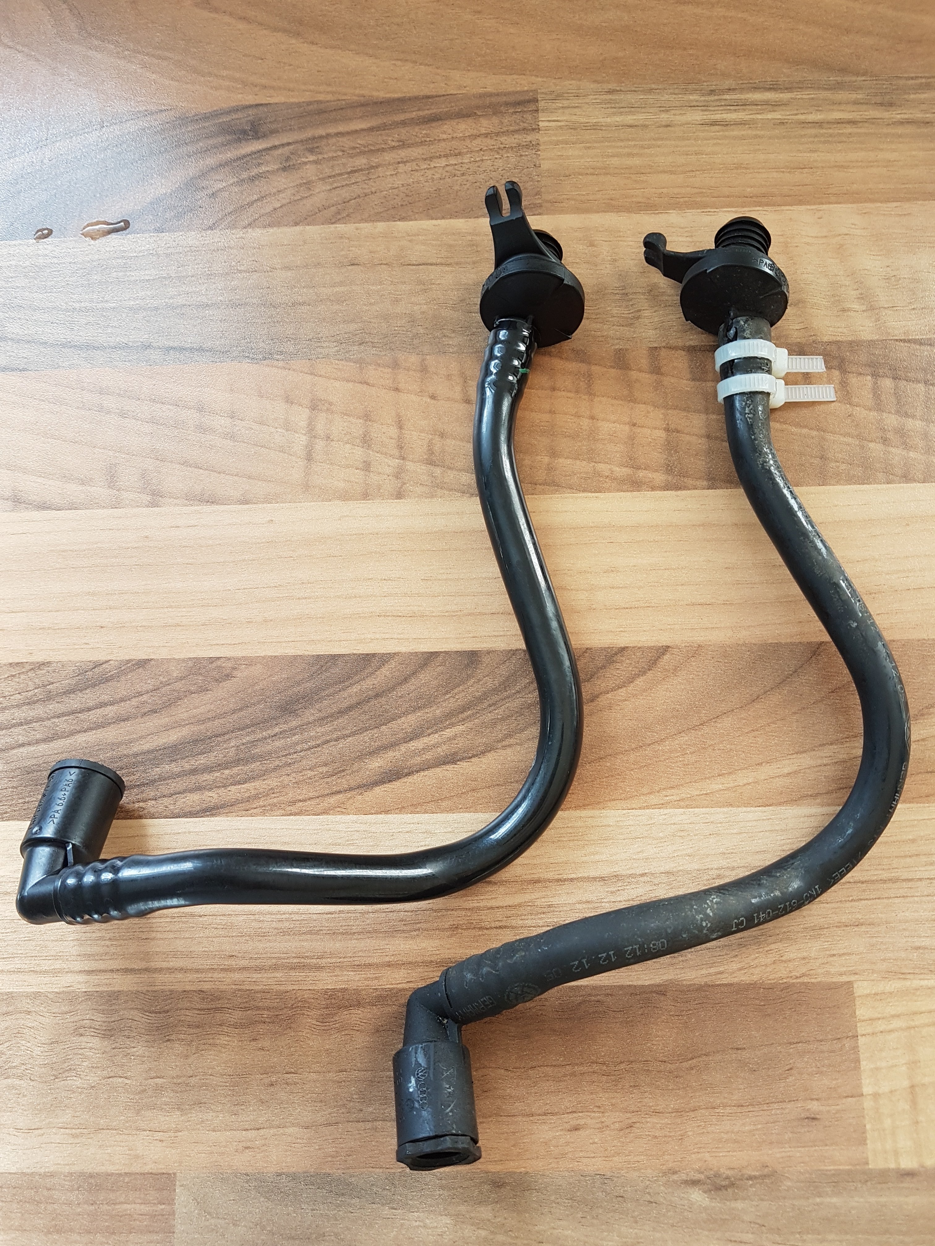

For anyone's interest, this is the hose I replaced the tie wraps are or were holding the split together to stop me loosing vacuum for the brakes.
