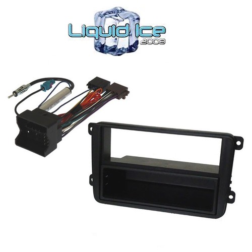

Generally to fit a non-oem stereo you just need a fascia kit that comes with the adapter so a new stereo can just slot in

I cant comment on any good ones as I have the stock Columbus unit, and a single-din bluetooth unit in my MK1 :P
