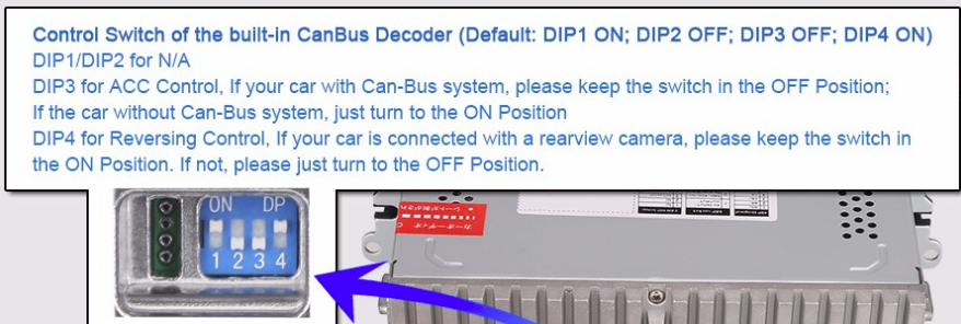

This might help you, dip switch 3 to on,
Yeh it's already on :/
thats what is troubling me
Your car has CAN-bus so that image suggests it should be off.
If it's on, you'll need to wire a switched live to get the headunit to turn on/off.
