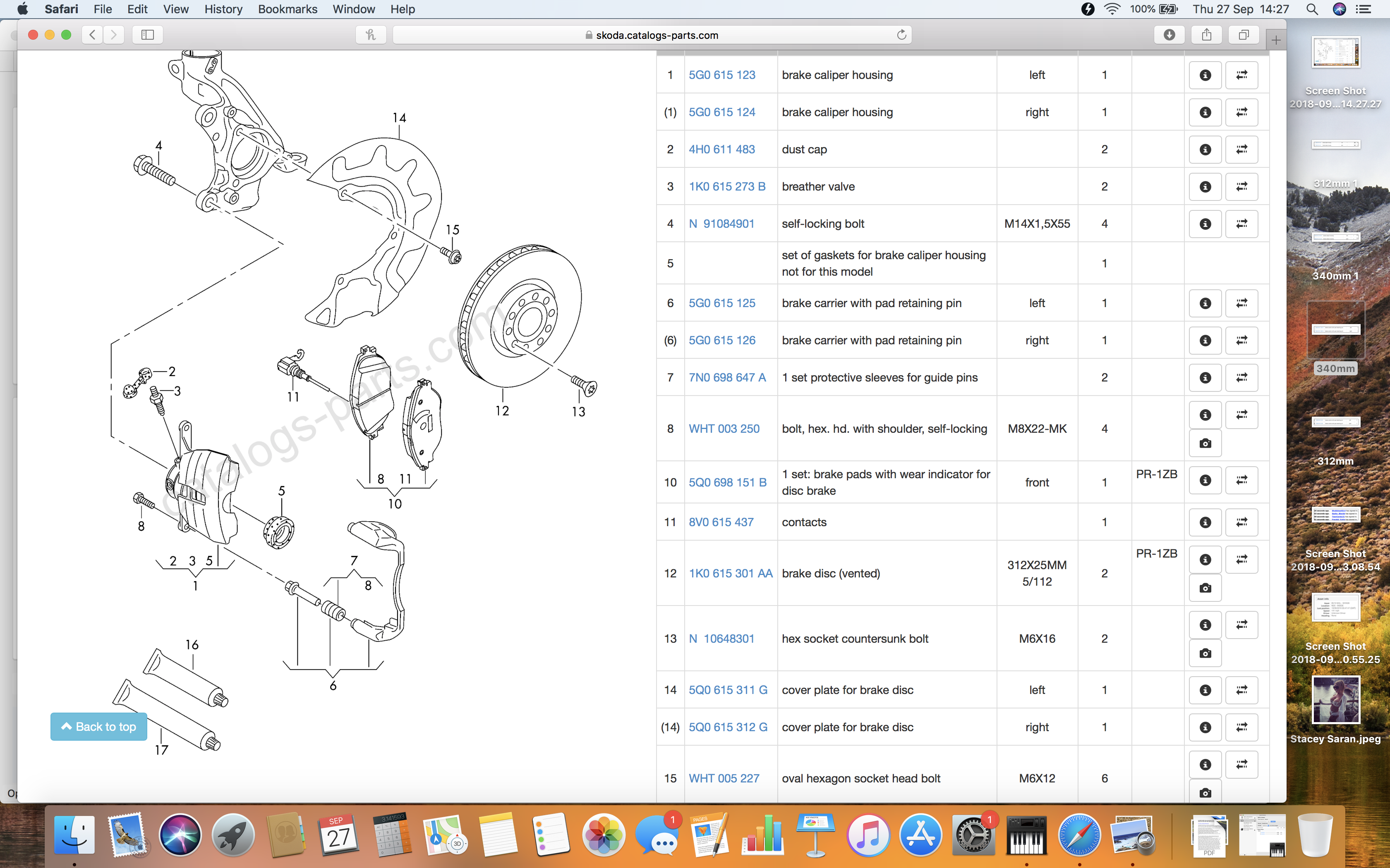

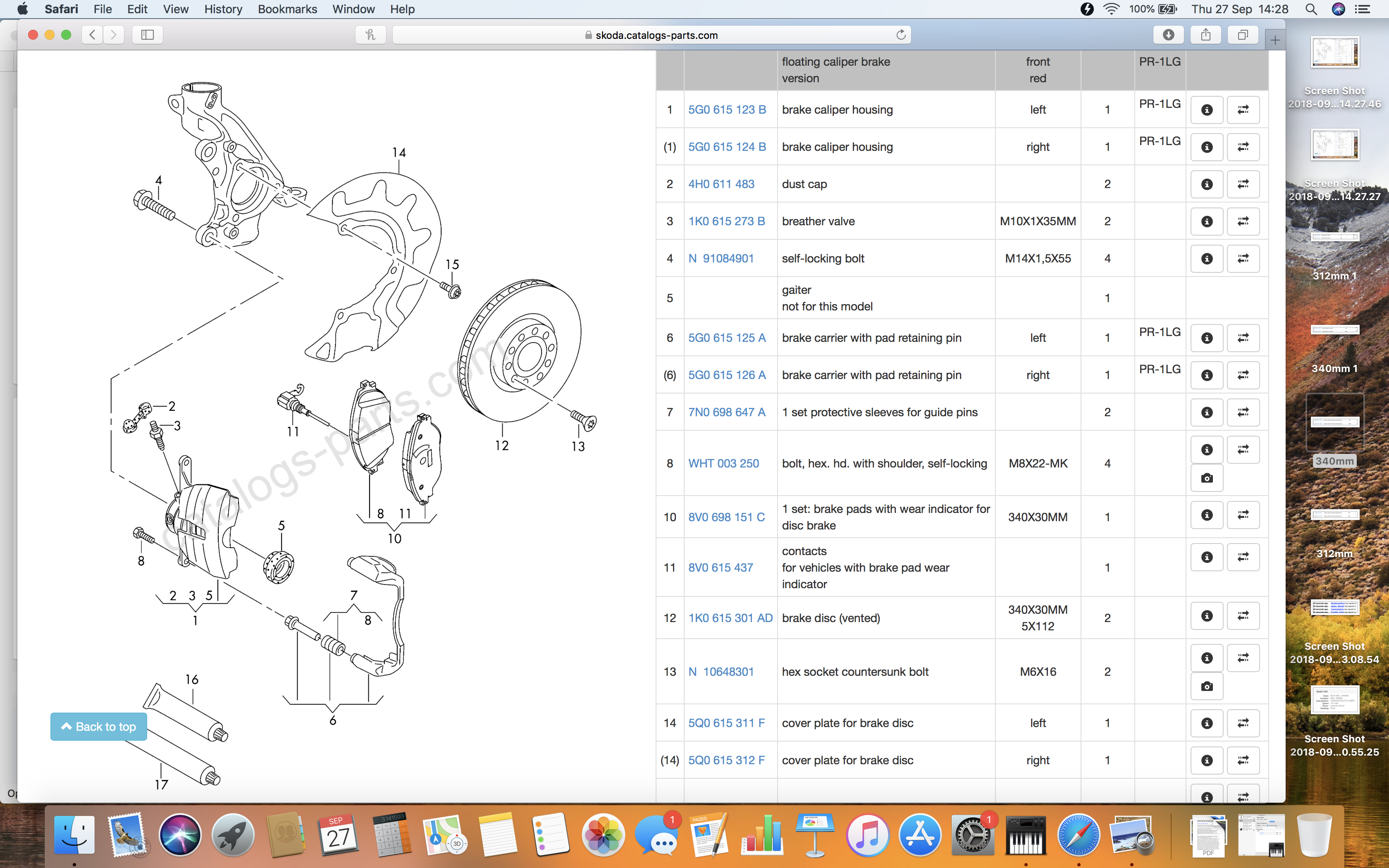

I was bored yesterday and had a spare hour so went down to my local Skoda and they've just emailed me back.
To go from the 312mm to the 340mm setup you need (all prices including VAT):
2 x new calipers £162.70 each
2 x new caliper carriers £118.26 each
2 x cover plates £15.94 each
So looking at £593.80, then obviously the bigger discs and pads which are £336.56 from EBC, so total cost would be £930.36.
£930 minus £283 (Cost for same but 312mm size discs and pads) means I need £647 so upgrade to the 340mm's
I could recoup some fo the costs be selling 312mm callipers but I wouldn't imagine they sell for much.
My friend has a 2009 Leon with the 345mm setup and he's upgrading those so thinking I might buy them off him and see how I go about getting those to fit?
