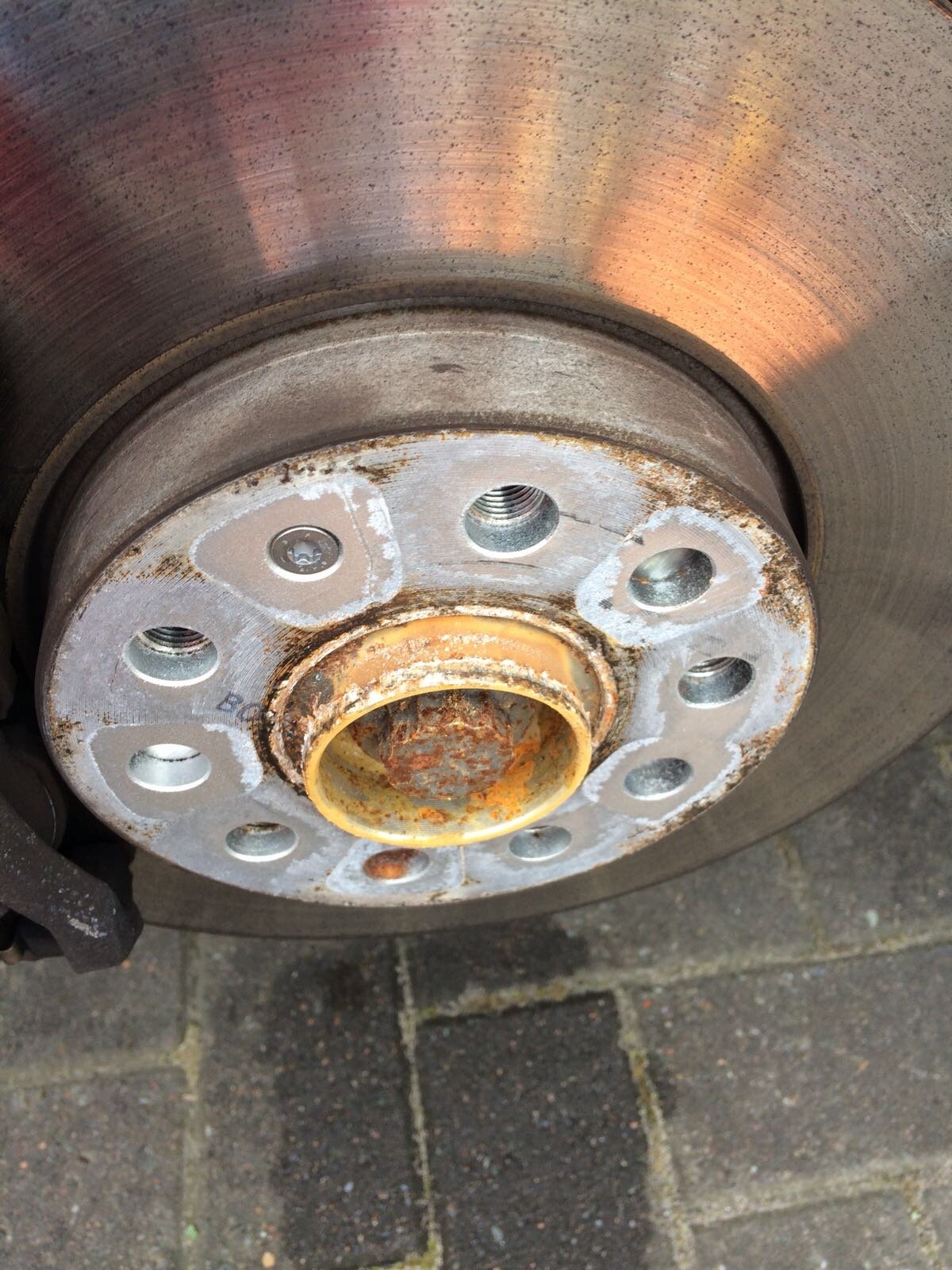

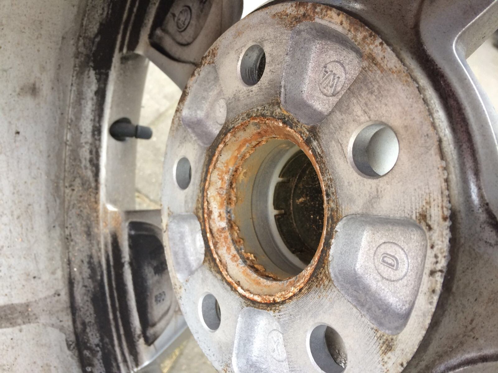

I think this is probably well known but removing  a rear wheel for a puncture etc. can be very difficult. The centre spigot that the wheel locates on can rust and almost weld itself to an alloy wheel (something to do with electrolytic reaction between dissimilar metals). I needed to remove a wheel yesterday and found it almost impossible. Removing the wheel bolts had no effect and I eventually I had to use a lump hammer and block of wood to hit the wheel (on the tyre) very hard before it loosened. Fortunately I was at home and I used a trolley jack to support the car; this would have been impossible and very dangerous at the side of a road with the car's own jack. I checked all the other wheels and found that the front wheels came off easily for some reason but the other rear wheel also had to have the heavy hammer treatment.
Obviously I cleaned the rust off the wheels and the brake hub and applied some copper slip grease to the rusted areas so, hopefully, this problem will be prevented in future. I strongly suggest that members of the forum check their wheels before they get stranded with a puncture in a tyre where the wheel won't come off.

Then on the surfaces showing rust in the pictures, hopefully not yet on your new car, you apply a little amount of copper slip.
So the hub centre and where that faces to the alloy wheel.
Not any on bolts or wheel stud seatings or on threads.
Then put the wheels back on using your wheel brace.
Then torque them up to the correct torque with a suitable torque wrench and see how much more that feels than when using the Wheel spanner you have with you.

Clean all mating faces to remove oxide corrosion, particularly the white alloy oxide. Use steel wool. Wash down using solvent like brake cleaner. Apply a thin smear of grease on centre spigot and around the mating hole in the alloy. A tiny bit of grease on the hub edge.
LM bearing grease or high temp brake grease. Copperslip is fine on steel wheels but will cause further electrolytic corrosion on alloy wheels so is not suitable despite what others may say.
The main hub surface and mating alloy surface must be grease free. These faces when bolted together transmit torque and shouldn't slip which transfers shear forces on the bolts.
Bolts and threads should be clean but NOT greased or lubed.
Torque in correct sequence to 120Nm for most Skoda alloys
