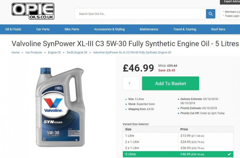

I don't care ;) my brother done it for free + air/oil filters ;)
2 hours ago, silver1011 said:
I'd want some pretty compelling evidence to justify the 100% price upper compared to the Quantum...
Is that group IV or V?
No idea, it's the one jafo linked earlier...
Useful information that might have helped if it had accompanied your link :D
