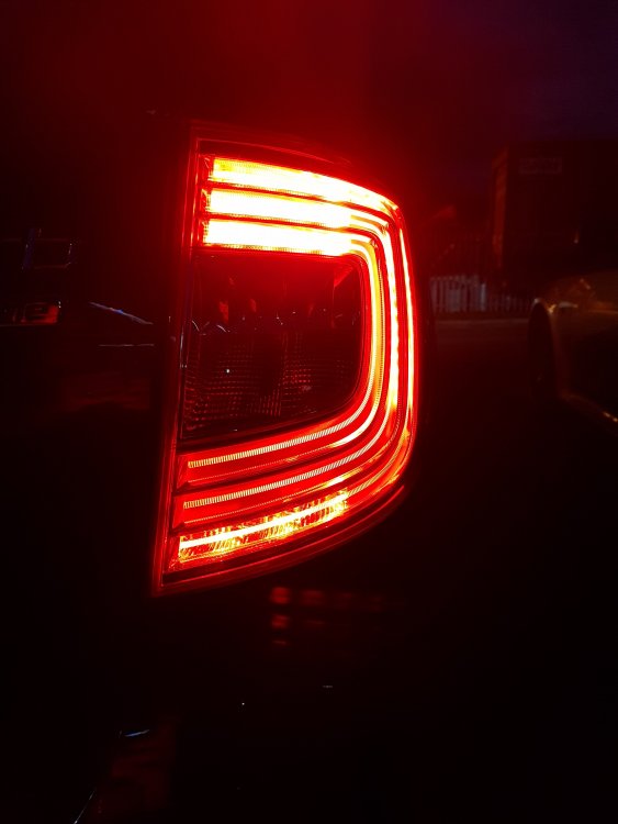

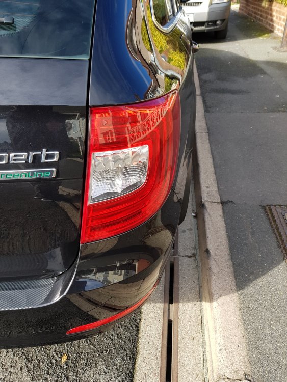

No mine are from a FL estate 2014 model. Like langers said Odis-e is great tool in the right hands, but in the wrong ones very dangerous.20181015_121340.thumb.jpg.4646850410bed45f541f246984e34684.jpg
15397121185975190904808881061195.thumb.jpg.920f0f13dd25265e6d2150f04d96cfff.jpg15397121185975190904808881061195.thumb.jpg.920f0f13dd25265e6d2150f04d96cfff.jpgAlso looks like the fog light is on all the time.
