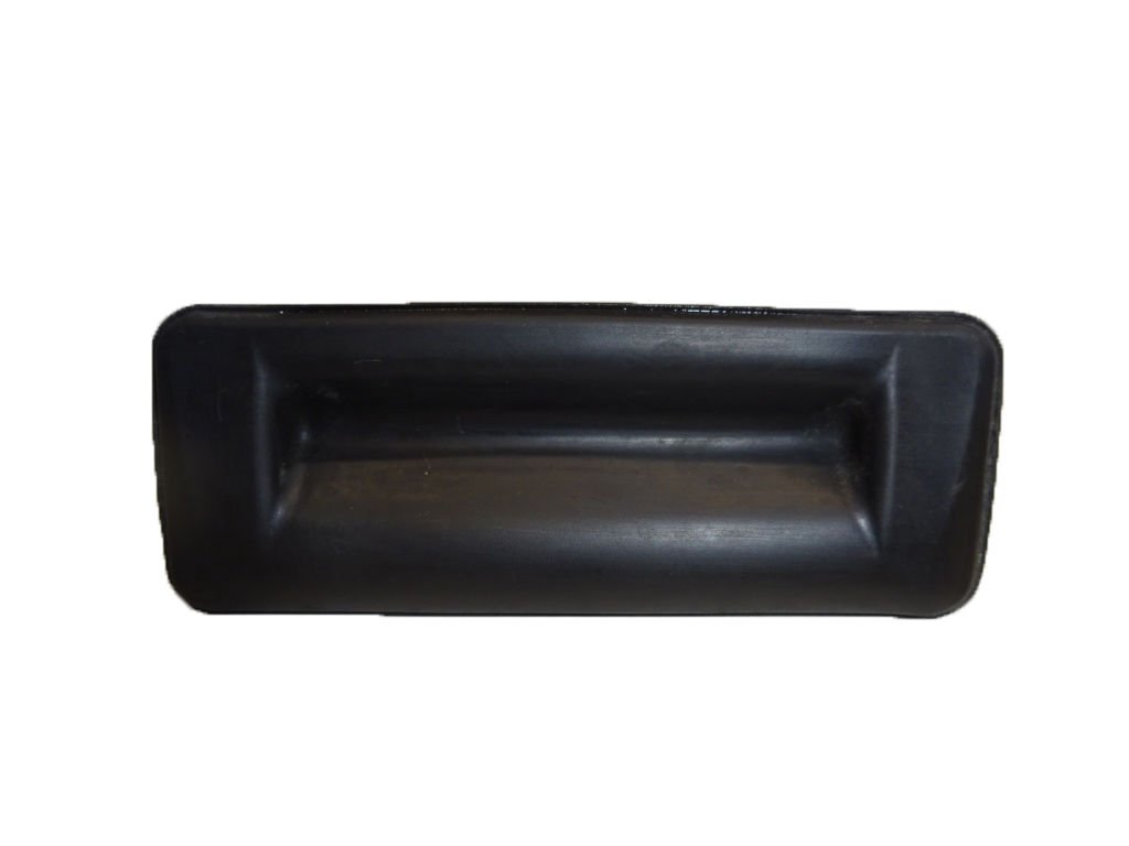

I'm about to remove my tailgate boot handle on my Mk3 Fabia, and replace it with a handle with a build in camera.
I have to admit, i can't figure out how to remove the electrical handle.

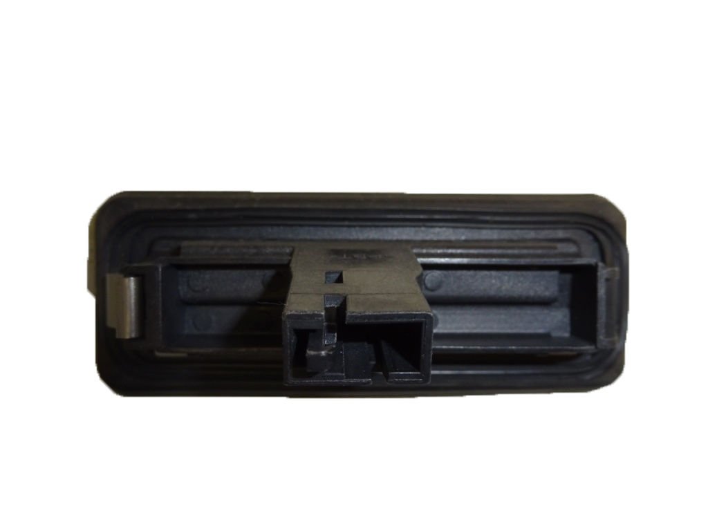

It seems as if it is installed with the metal clips, which have to be "activated" in order to "pop out" the handle.
However i can't find a way to activate it and pop it out - are there another way of doing this, or do you have any kind of "guide" / "step by step description"?

The metal clip is just a spring keeping it in place. You just need to push it sideways against the metal clip side and the other side will pop out.
Thank you for the reply!
i thought i have Tried this - but maybe i just need to push it harder?
i will try lager tonight - and hopefully it works :-)
