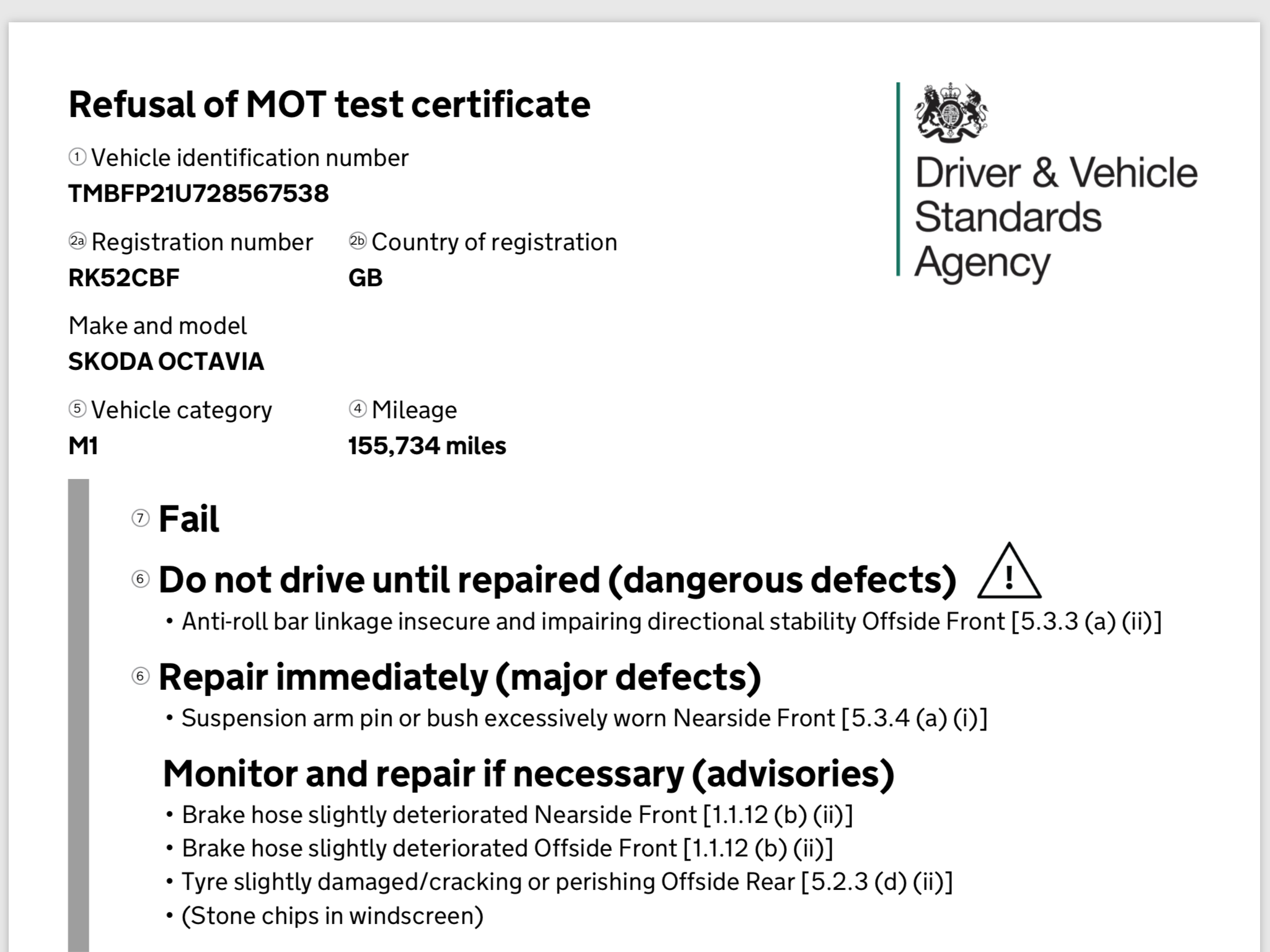

My Octavia 1.9TDI L&K estate has failed the MoT with a u/s front anti-roll bar bush. I propose to do the job myself and would welcome some advice. I found a post from 2010 on here but the photos are not available. Anything special  to look out for?

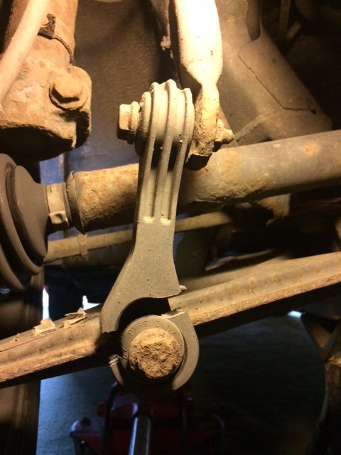

Is it the bush is knackered, or the droplink connection to the roll bar?
Or as tech1e said... the ARB itself is possibly done...

As you suspected, mac11irl, it's the drop link - snapped in half!
I suppose "Anti-roll bar linkage insecure" is a reasonable description, if you count "totally detached on one side" as insecure! Very strange, neither I nor my wife noticed anything odd about the handling. But it's always been a very "wallowy" ride, even when new, so perhaps that's why we didn't notice.
The other failure (suspension arm pin or bush excessively worn) has got me stumped - I haven't yet found anything wrong. So I think I'm going to replace the drop link and then take the car back to the tester and get him to point out the bit that needs replacing.
@YellowVrsToo
Thats fairly insecure.. and explains why its listed as "dangerous defect" its what drew my though to it..
I replaced my plastic ones with lemforder steel ones. Felt a smidge stiffer after the change and i felt more comfortable than with the plastic..
