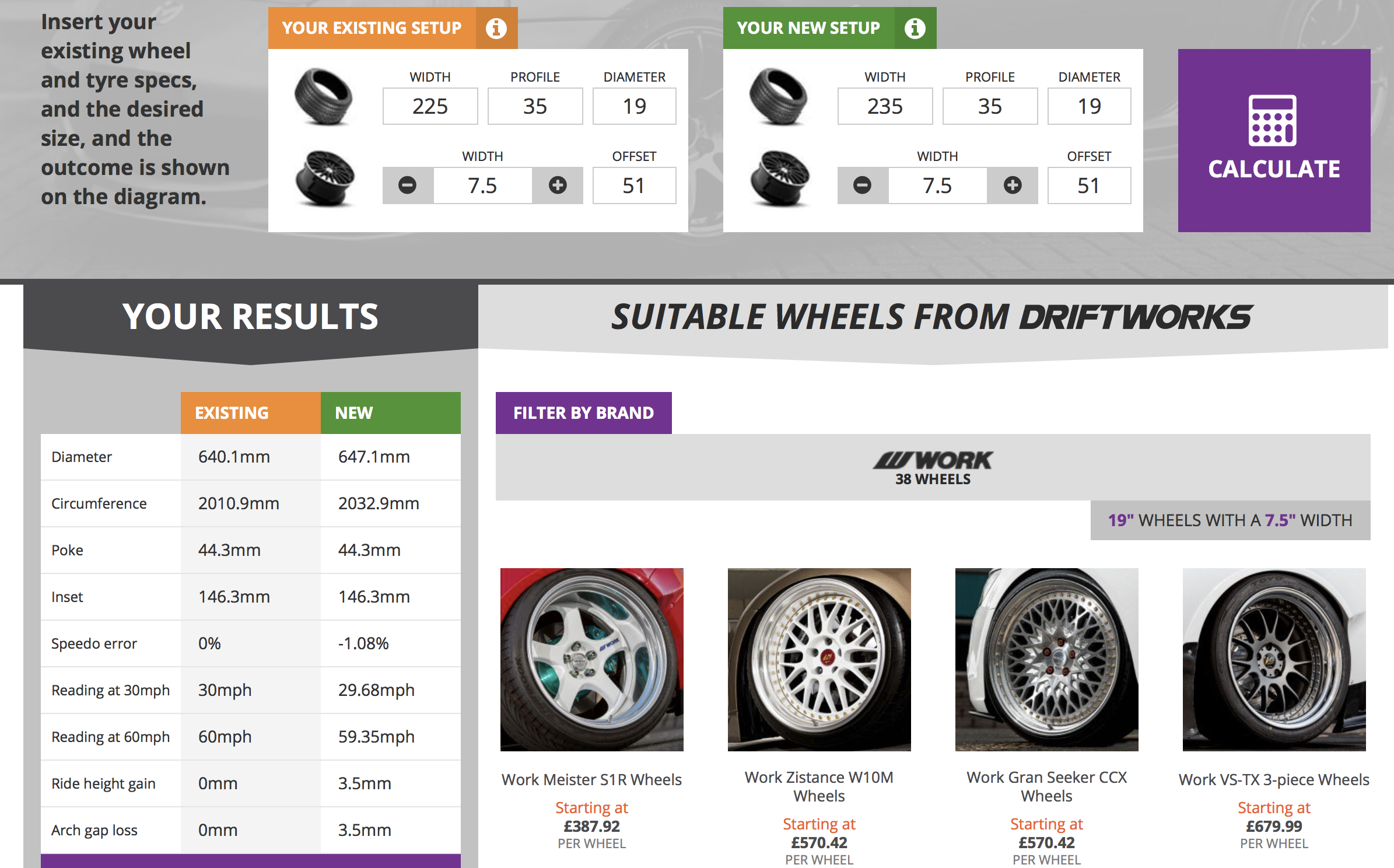

Quick thought @Auric Goldfinger, does this not affect the rolling diameter and therefore the speed etc?
Should be OK............................
So in fact it slows you down....... interesting B)
