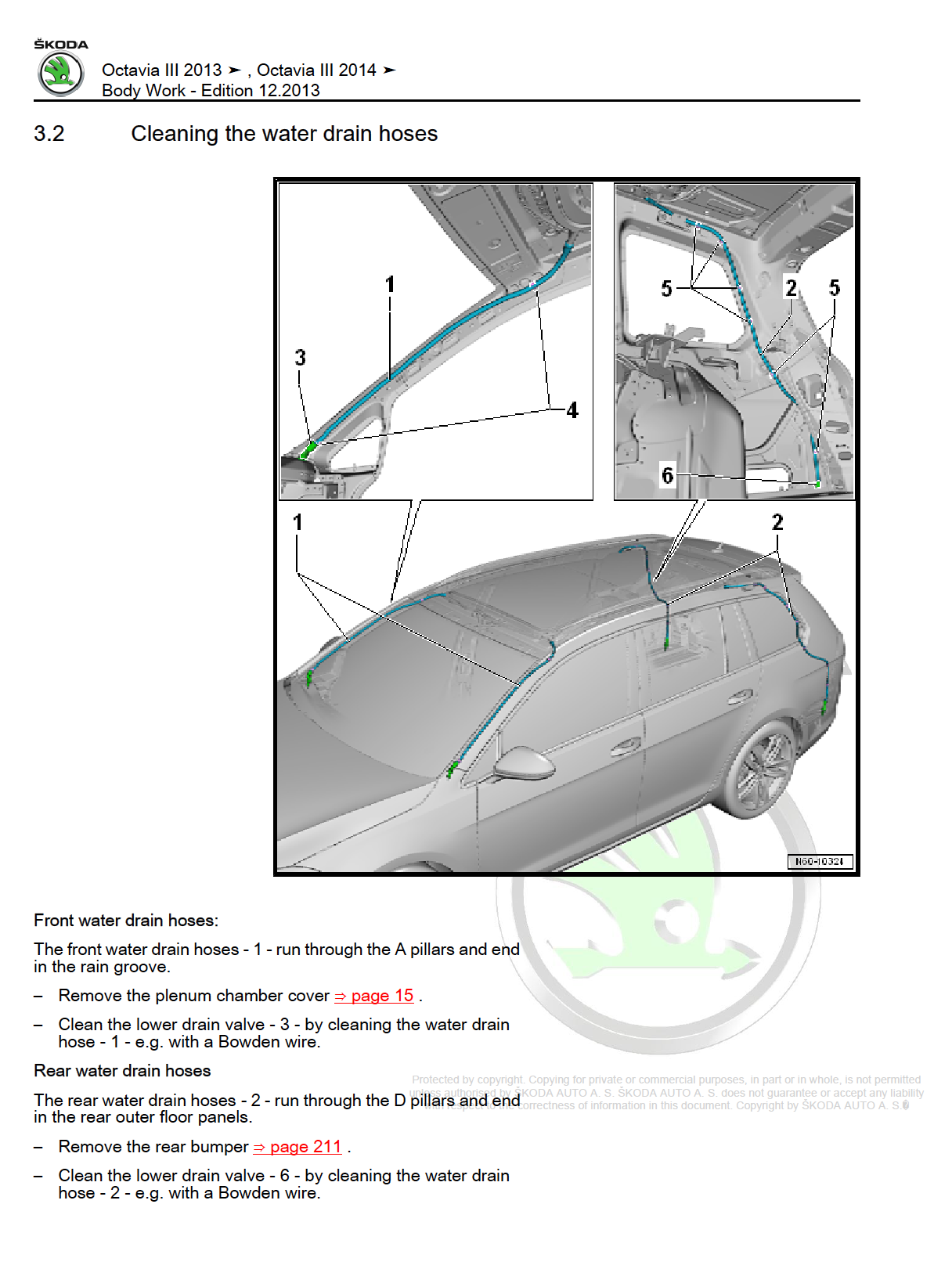

I can easily locate the front drain tubes for the roof at the top and I am going to try and stick some wire down and clear them out, or possibly give compressed air a go. They aren't draining as they should as water pools at the top - and I can see water entering at the front of the car, drivers side roughly where the '3' is in the image below. I can only assume though as the front carpet isn't really wet at all that this is not the source of the problem (albeit a very similar problem waiting to happen). If this doesn't work, I will pop the trim off and clean the valves as suggested in the manual above (and picture below).
Sorry, I'm getting to the point - does anyone know how or where to access the rear drain tubes/valves? The glass is in the way of them at the top, and the manual suggests taking the rear bumper off; I am not able to do this! Short of trying my best to blindly get some wire into a small hole like a drunk trying to get their key in the front door I don't know what to do - has anyone found a way to do this? The image suggests they are accessible from the inside of the car, but I can't work out what I need to take off to get to '6' in the pic.

Perhaps look in the rear light cluster access panel, inside the boot?
Oh and be carful using wire as I doubt the drain tubes are a single run and could have connectors, elbows etc so you may inadvertently disconnect something.
Im surprised the roof would need to come out as per the dealer suggestion; surely dropping the interior roof liner would allow access???

Then I found footwell water again. But finally today after a lot of tinkering and blasting the car with a hose I have found the issue (I think). I noticed water entering on the passenger side, just above the bonnet lever and looking at the diagram above it's clear it's where the lower drain valve is. So I'm thinking this is blocked. Annoyingly this was supposedly checked by the specialist I took it to, but now, it's clear as day. Pouring water into that drain causes a lot of water to enter the car. It's only when I read that water always gets to the lowest point that I understood that it could be getting in at the passenger side. I nearly always park facing downhill with the camber causing car to lean to the driver's side. I'm annoyed as I reckon I could have solved this issue myself, but hey ho. I paid the garage to fix it, they haven't, so it's going back... And from the receipt is states they checked this valve so that can bloody well do so again!

Rather than using wire I used plastic strimmer cord on my blocked sun roof drains (Mk1 Octavia). Less chance of damaging the tubes where they bend. To my surprise the tube had managed to come off the joint from the sun roof drainage channel and had to be pushed back on.
