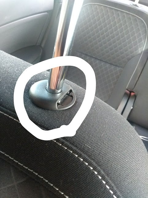

Somehow the little clip that you squeeze to adjust the driver's head restraint (yes, I know not a "head rest") has disappeared.  The first attached photo shows what I'm talking about.

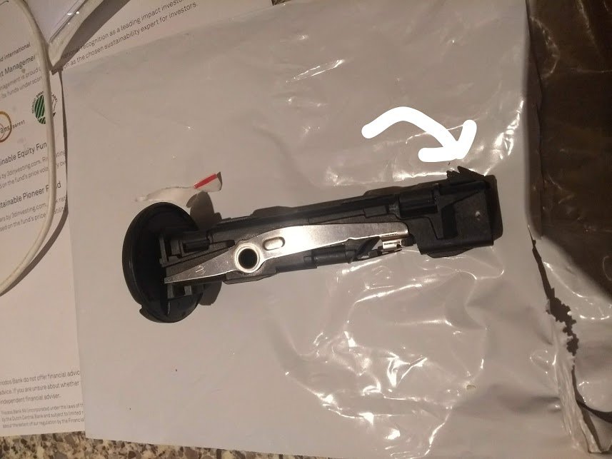

The replacement bit arrived (photos attached) and you can see there there is a 'spike' that is clearly intended to stop the barrel from coming out when attempts to raise the head restraint without squeezing the release clip happen. Having looked closely at the replacement part there doesn't seem to be an easy option of just taking the clip from the new part and inserting it into the original.

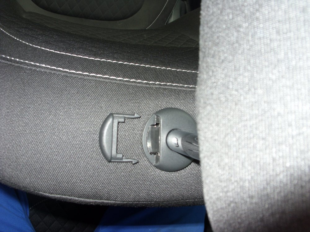

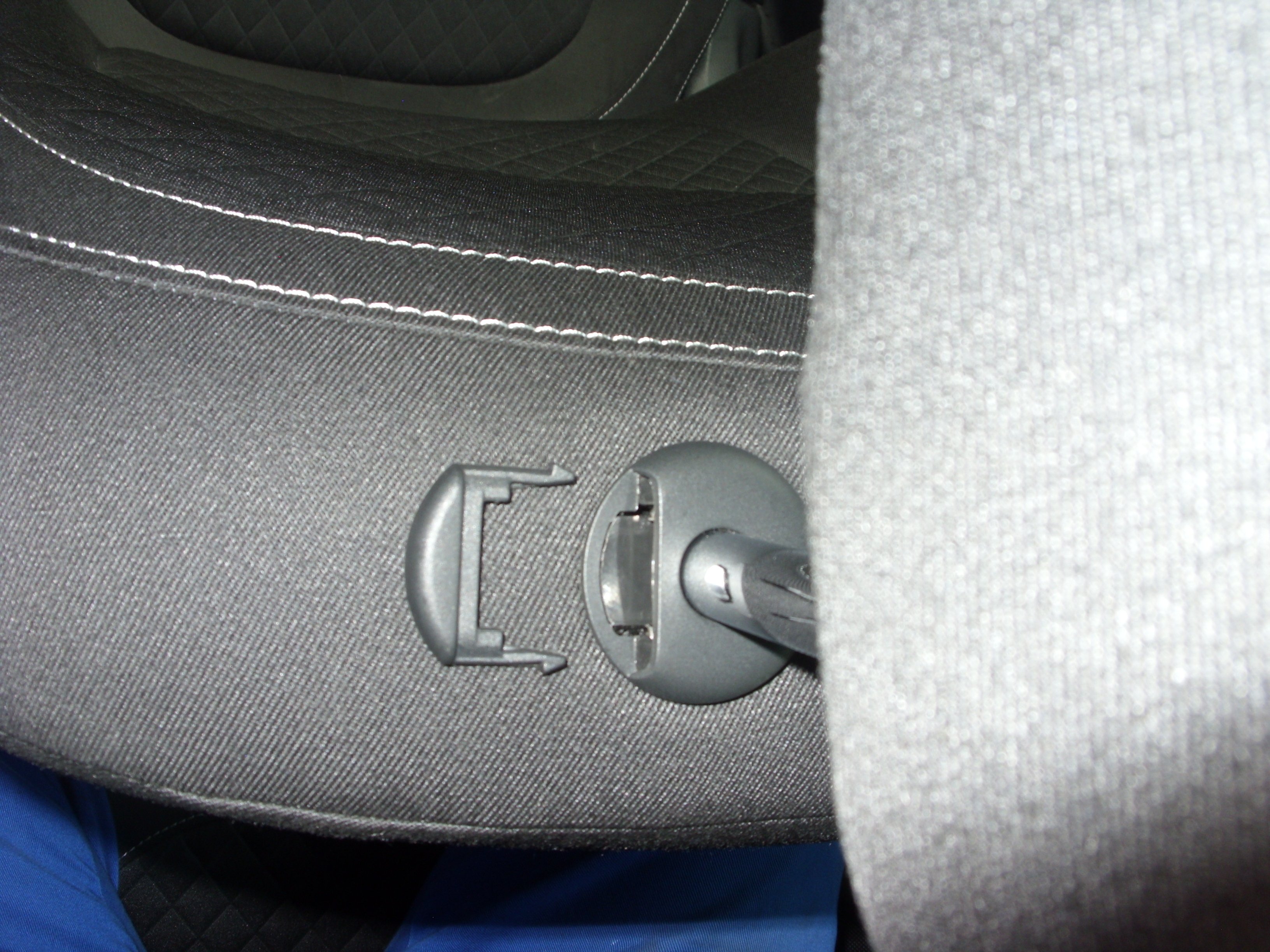

Five years on from this post but I've had the same thing happen. Just wondering if anyone has the part number to speed up my search for a replacement rather than just get the dealer to order it in. Thanks for the photo Robjon - seeing that it should be easy to remove the clip from the new part and slot it in the existing fixing.

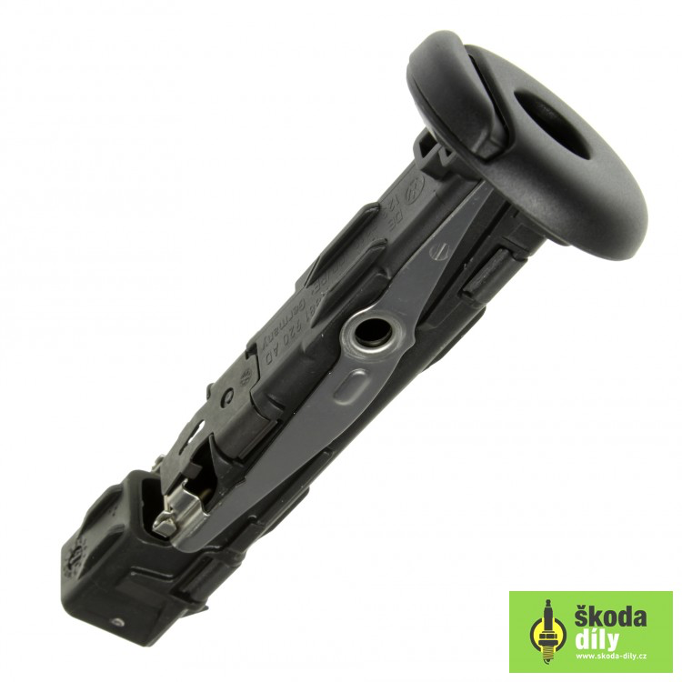

I did find this part number for the whole assembly, but never got around to ordering one, but the OP says the clip isn't easily removable from the part.
https://www.skoda-parts.com/spare-part/1k0881920ad9b9-headrest-guide-with-a-button-skoda-34638.html
  • 1K0 881 920 AD 9B9

The OP is wrong, the clip is removeable my Yeti was missing one and I used one from the rear seat of my old vehicle, it stands out now being a different colour.
Robjon has kindly shown a photograph that explains better than my words could ever.
It's a really easy fix. You have to order the whole part (I ordered mine through my local garage.  They service the car for me and they charged me a few pence less for the part than I could get it on-line and it avoided a postage charge - which would have been several pounds). The "button" clip just pulls out of the new part with a sharp tug, which is probably how it got lost in the first place, and slides into the old sleeve. Job done.

Well, 6 years on it has happened again (different yeti, same seat position). This time the additional words of wisdom from the forum will help me: (1) buy the full replacement fitting (I wonder how much the £8 original cost has turned into over 6 years) (2) extract the clip from the replacement part (3) inset into existing spike that is still in situ in the car.
