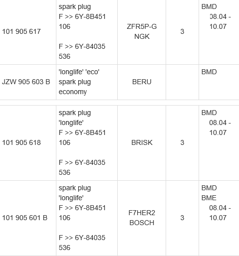

Few other options here: item 11, look for BMD in the model data column
https://skoda.7zap.com/en/cz/fabia/fab/2006-453/9/905-905000/
The date ranges are a little strange on that site, I find that chopping 20 off the front of them makes them more sensible, like this:
VAG part number in first column.
Manufacturers part number in third column, where specified.
Any of those should do for your 2006 car.
Brilliant , thank you
