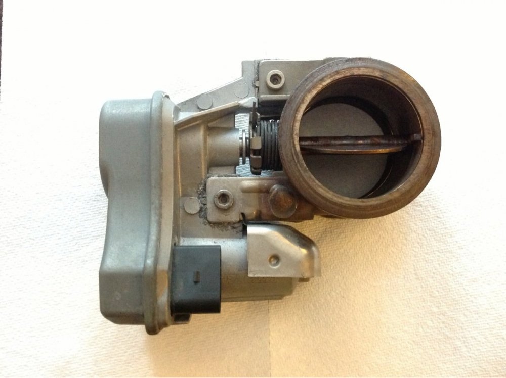

Those are related to the EGR valve if I am not mistaken.
Always good to fullscan, clear and give it a drive to see if they replicate.

For info, The error codes refer to the low pressure EGR valve in the exhaust line not the normal high pressure valve on the engine side.
The link from above sounds exactly like the codes you describe so might be worth a quick try if you are mechanically minded.

The exhaust flap control unit has five wires, pin 1 +5V, pin 3 0V/earth;
pin 2, labelled S goes to engine ECU pin 58 of a 94 way connector - probably a position feedback signal.
pin 4, labelled - goes to pin 7 of same conn.
pin 5 labelled + goes to pin 29 of same conn.
Last two are motor drive wires, I would think.
The colours of all except the earth wire change at a 5 way connector on the way.
