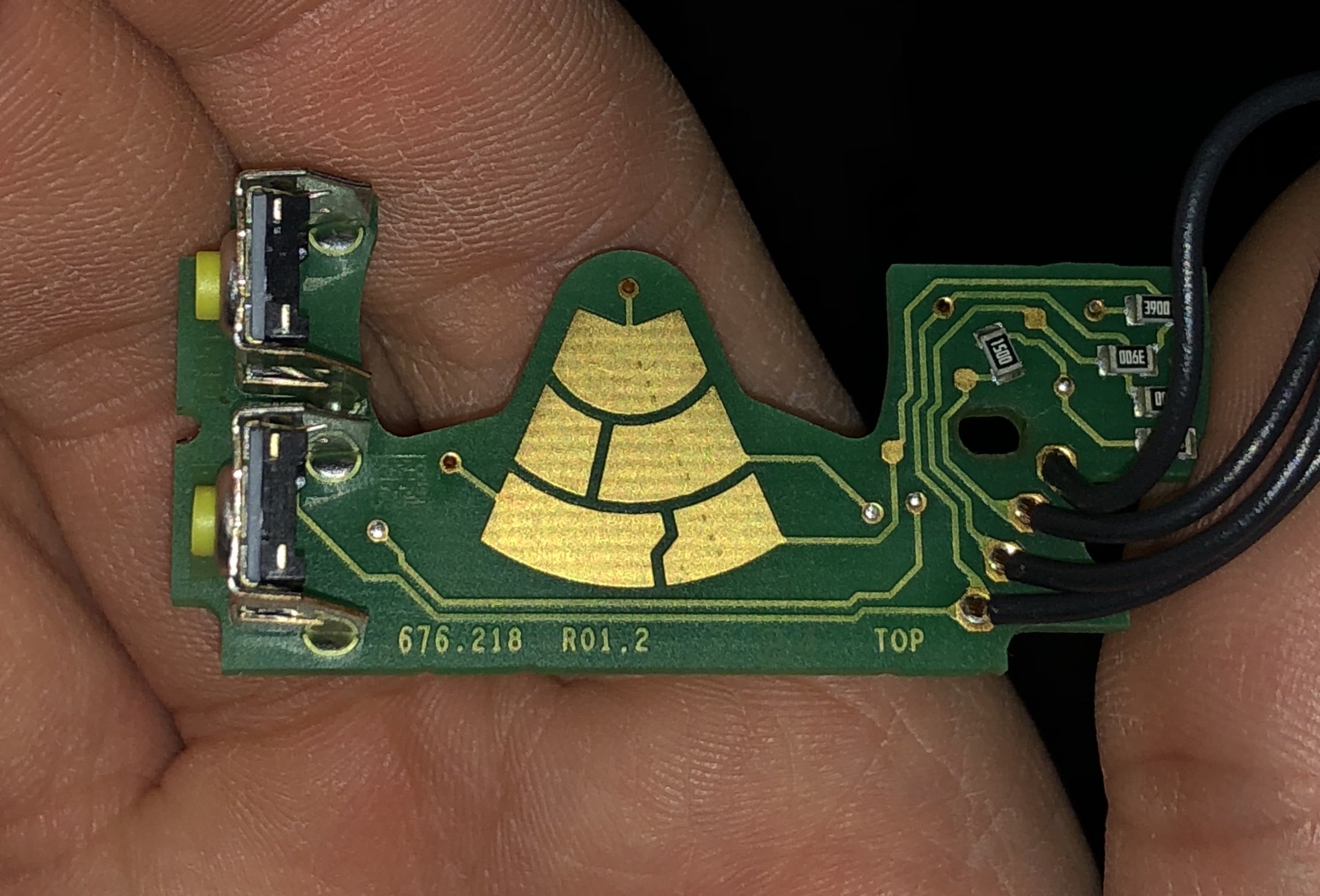

Following the tutorial posted here, I tried to clean my cruise control switch, and was greeted by a weird sight:
There is no removable switch, just soldered contacts. All have good connection it appears and the switches appear clean.

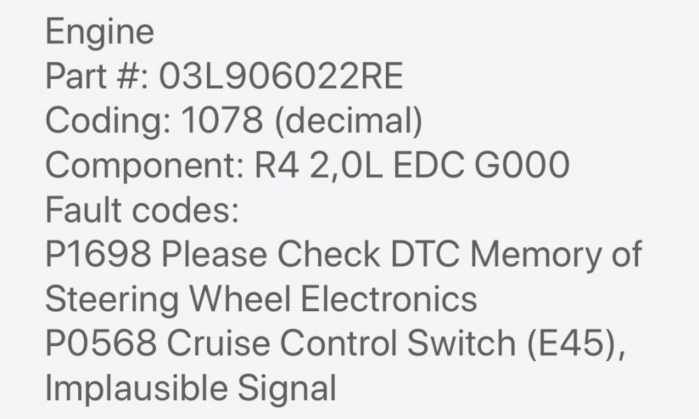

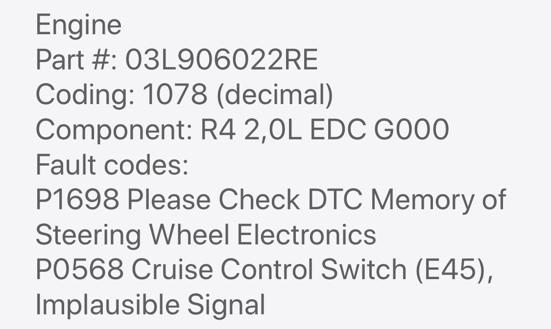

Even trying without the cruise control rocker thing, I still get the same error on my maxi dot, about an error with the driver assistance system. I can't access any menu on my maxi dot, just the phone settings, and the rest, I can't seem to figure out how to open(?)
Error codes show as well, about implausible signal. Do I just need a new stalk?

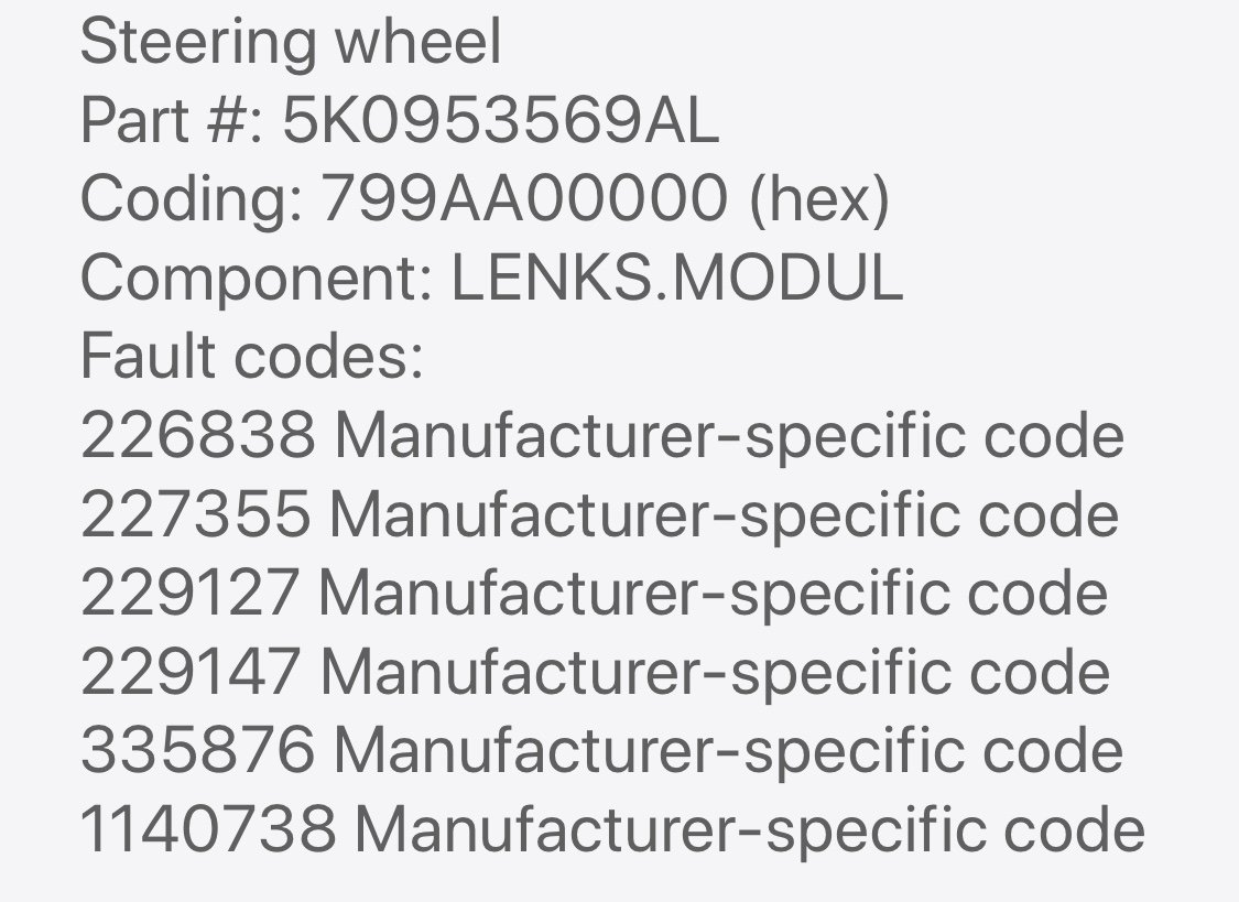

Have you done anything else to the car as the coding doesn't look right to me.
There is very little to go wrong in the switch, the on/cancel/off switch makes contact with the 5 pads in the middle of the PCB. You should be able to check it with a multimeter to see the resistance change depending what you press.

Seems like the switch was fine, the steering control module had a very strange lcode.
I'm sure the OP will confirm but last night they said it appeared to be working normally after recoding.
Yup thank you langers :D airbag code remains but all is well, it’s been so helpful :)
