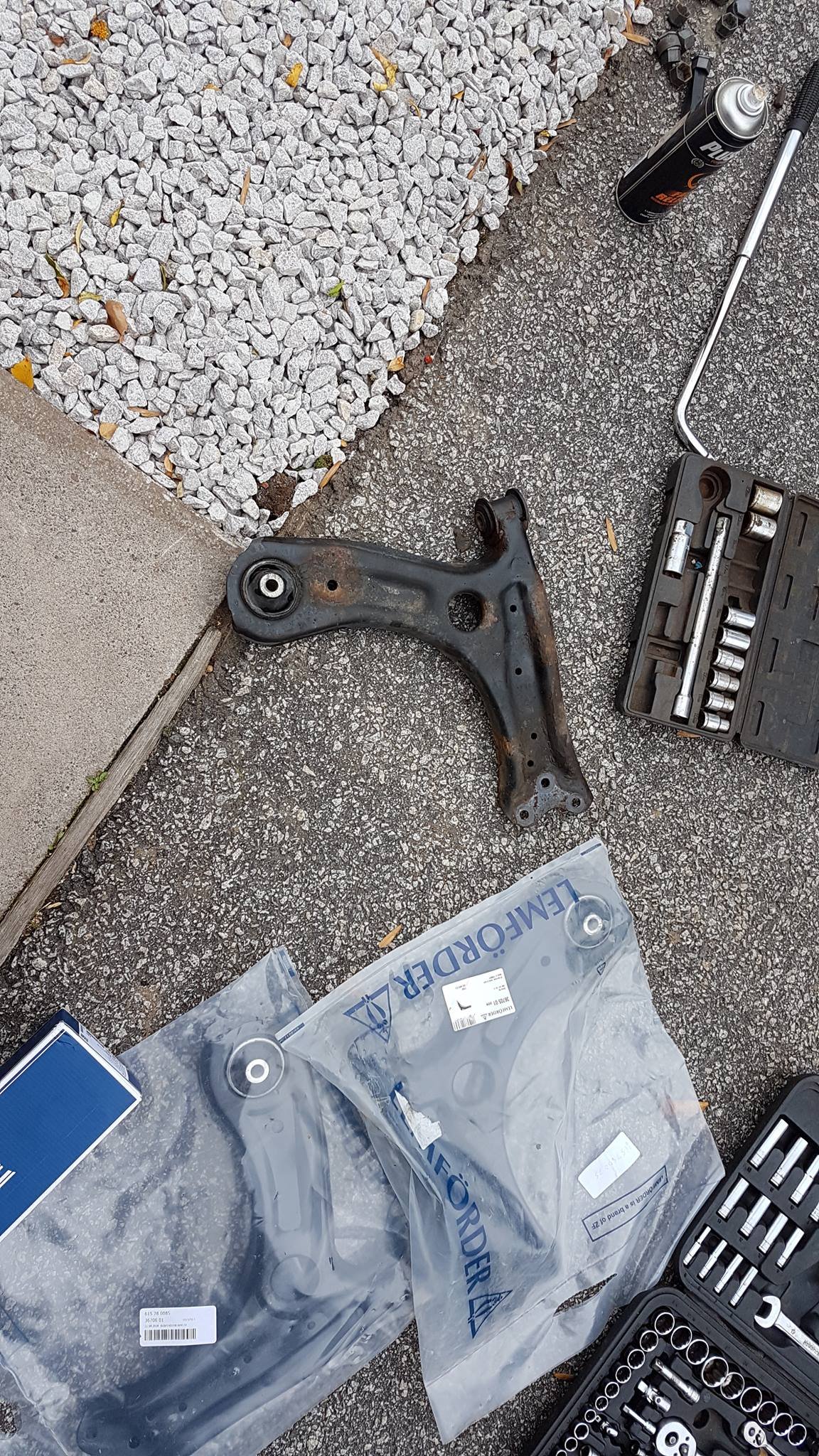

For once, suspension work wasn't a complete pain in the a**e. Skoda dealer noted the wishbone bushes needed replacing when the car was in for an engine management light which transpired to be goosed air intake sensor wiring. They do like their health checks!
Car is 1.6 diesel on a 10 plate with 90k miles.
I opted to replace the droplinks too, given they can be a pain to remove. As it happens, they are probably no more than a year or so old. Meyle HD kit, you can't beat it. I've boxed 'em up. They can be my spares if needed. Fitted Meyle HD droplinks and Lemforder wishbones. £50 a side for the wishbones and £24 all in for the droplinks which is pretty decent in my book.
Good thing with this car is the lower balljoint is a bolt on part, so no reason to break the joint, just undo the 15mm nuts (x3) which hold the wishbone to the lower ballpoint.
The main bolts and nuts are 18mm to the wishbone bushes. Nothing a extension bar can't sort. I sprayed PB Blaster on all exposed threads and wire brushed too. Use a little marine grease on the withbone to ease it back in.

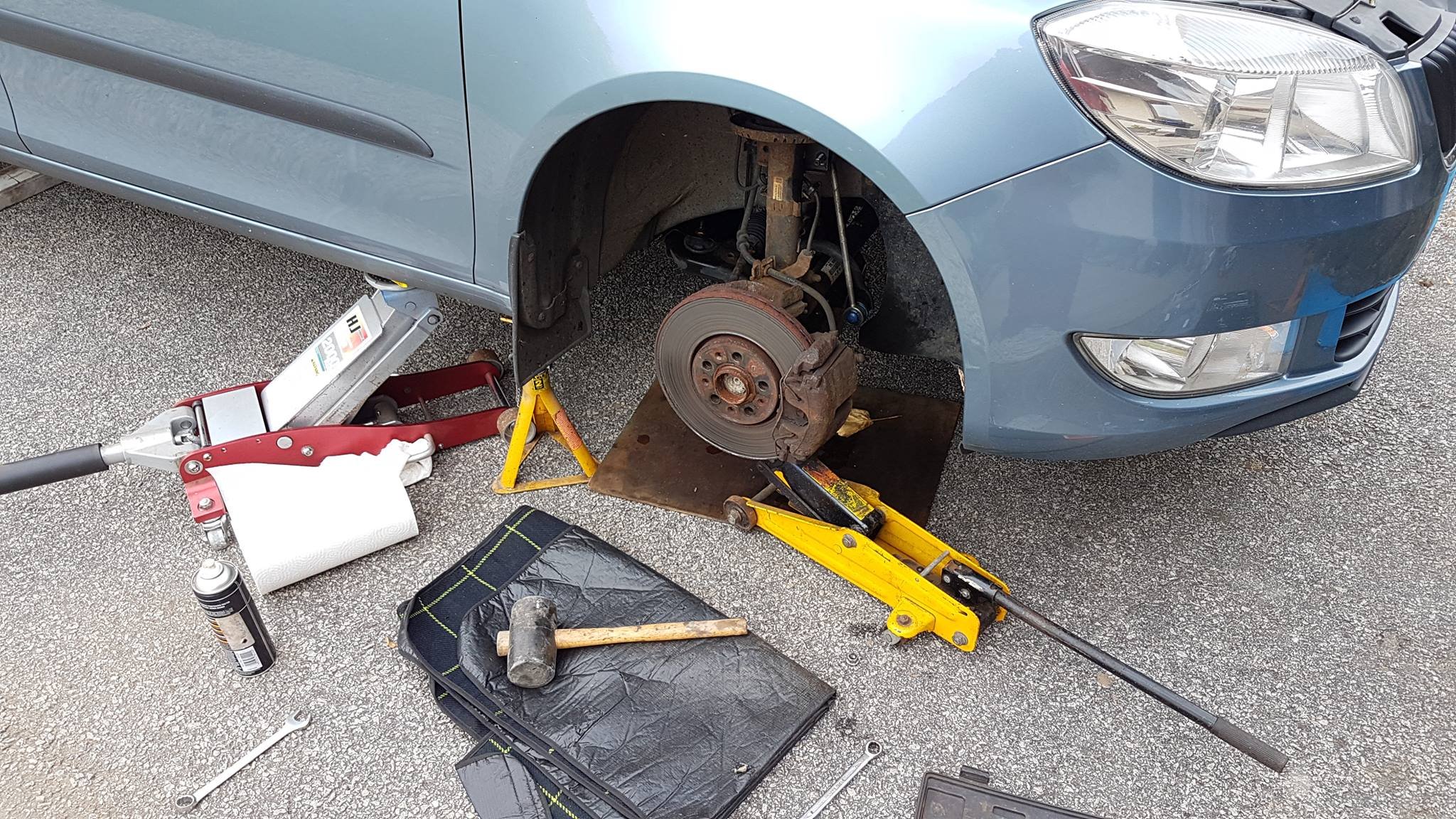

Good opportunity to refit the winter tyres too. If you're attempting the job, two trolley jacks are required, one to lift the car, and the other to lift the strut to align the droplink.

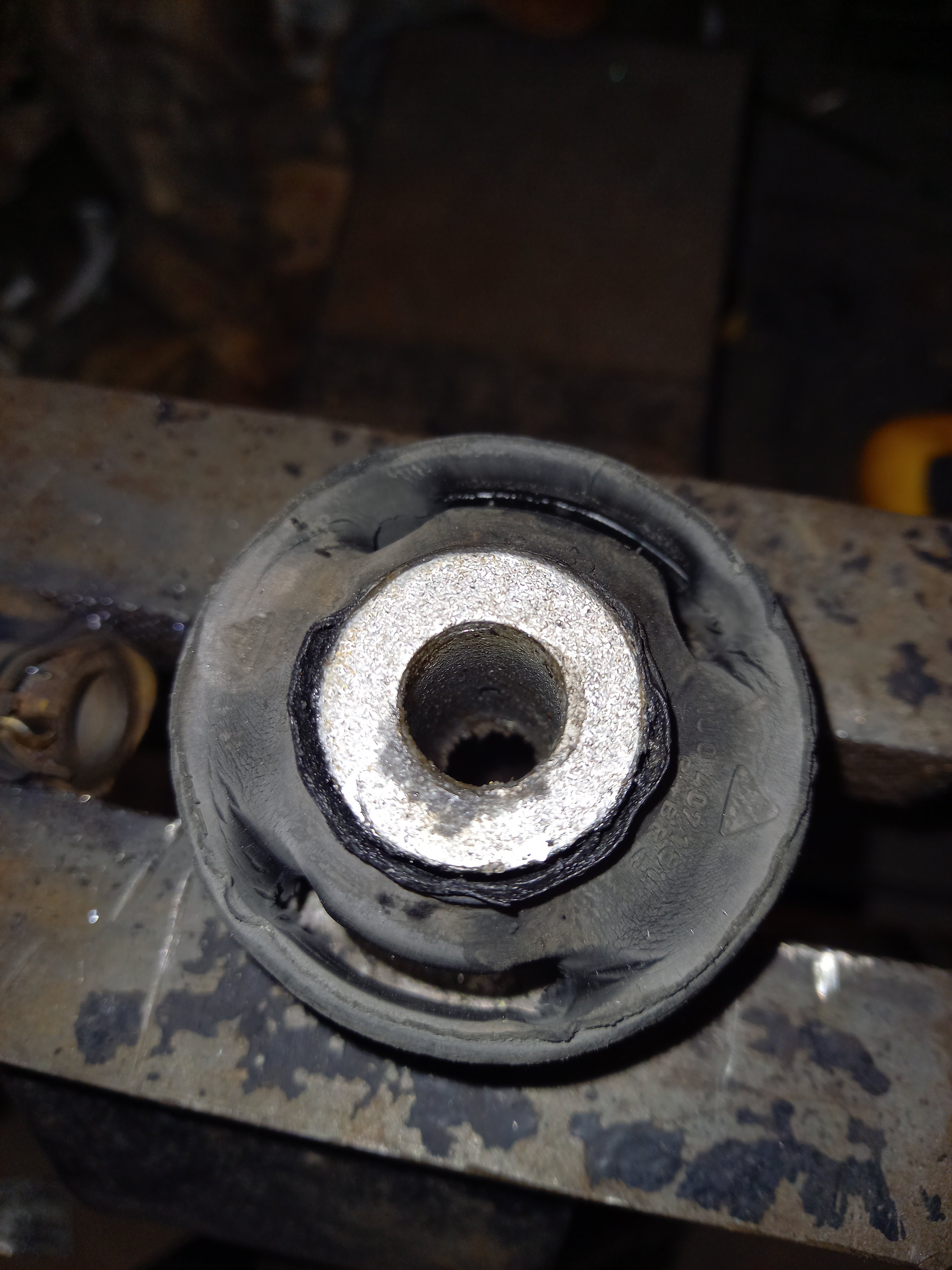

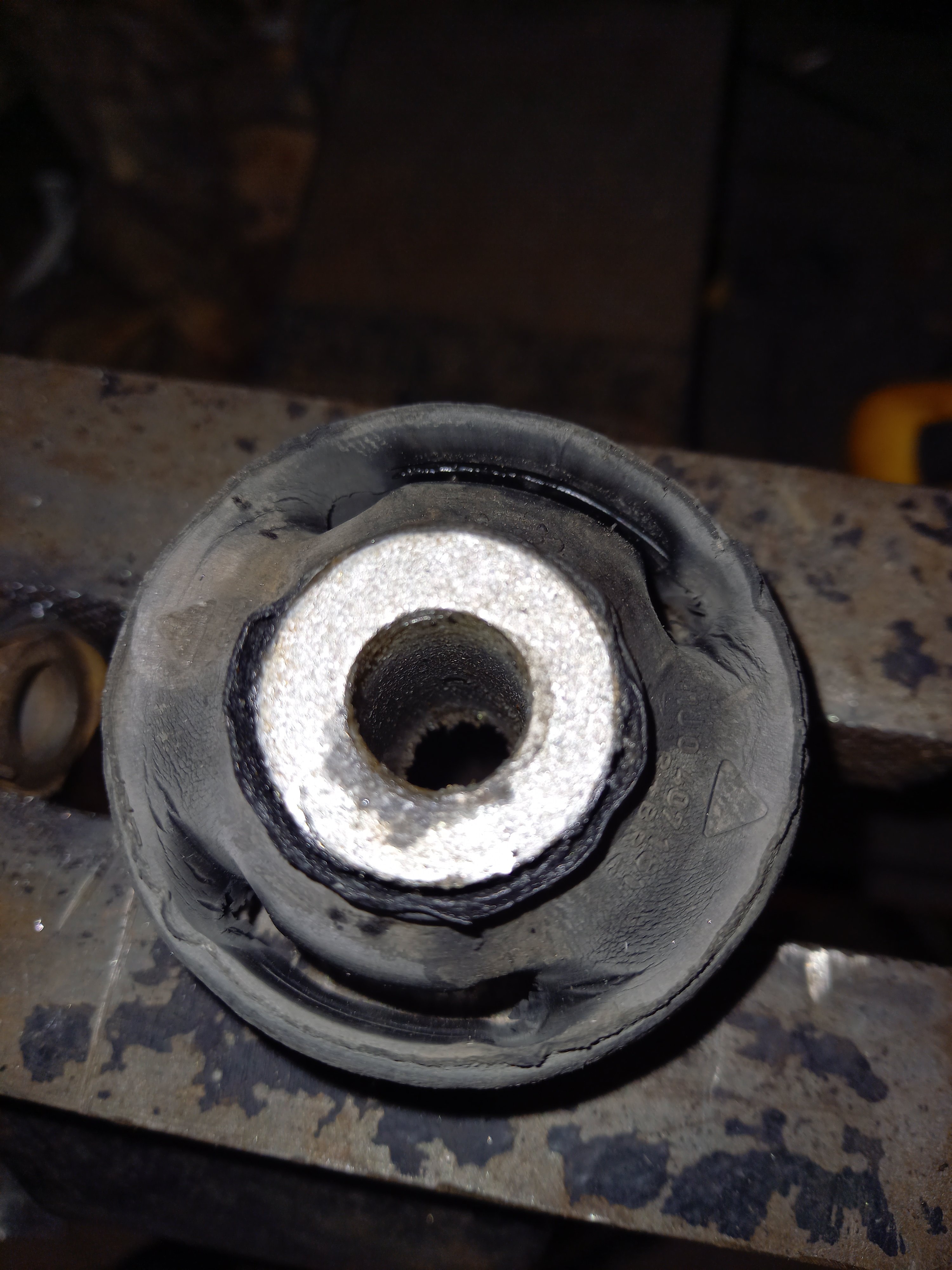

My old ones looked like this and I passed our NCT in November with no advisories. I can feel a big difference after swapping in the new urethane ones so they definately were on their way out. I only noticed how bad they were when I did track rod ends a few weeks before.
My horizontal bushes "look" and "feel" OK as they are installed but might look different when you have them in front of you dismantled as you show.
