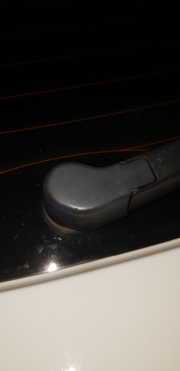

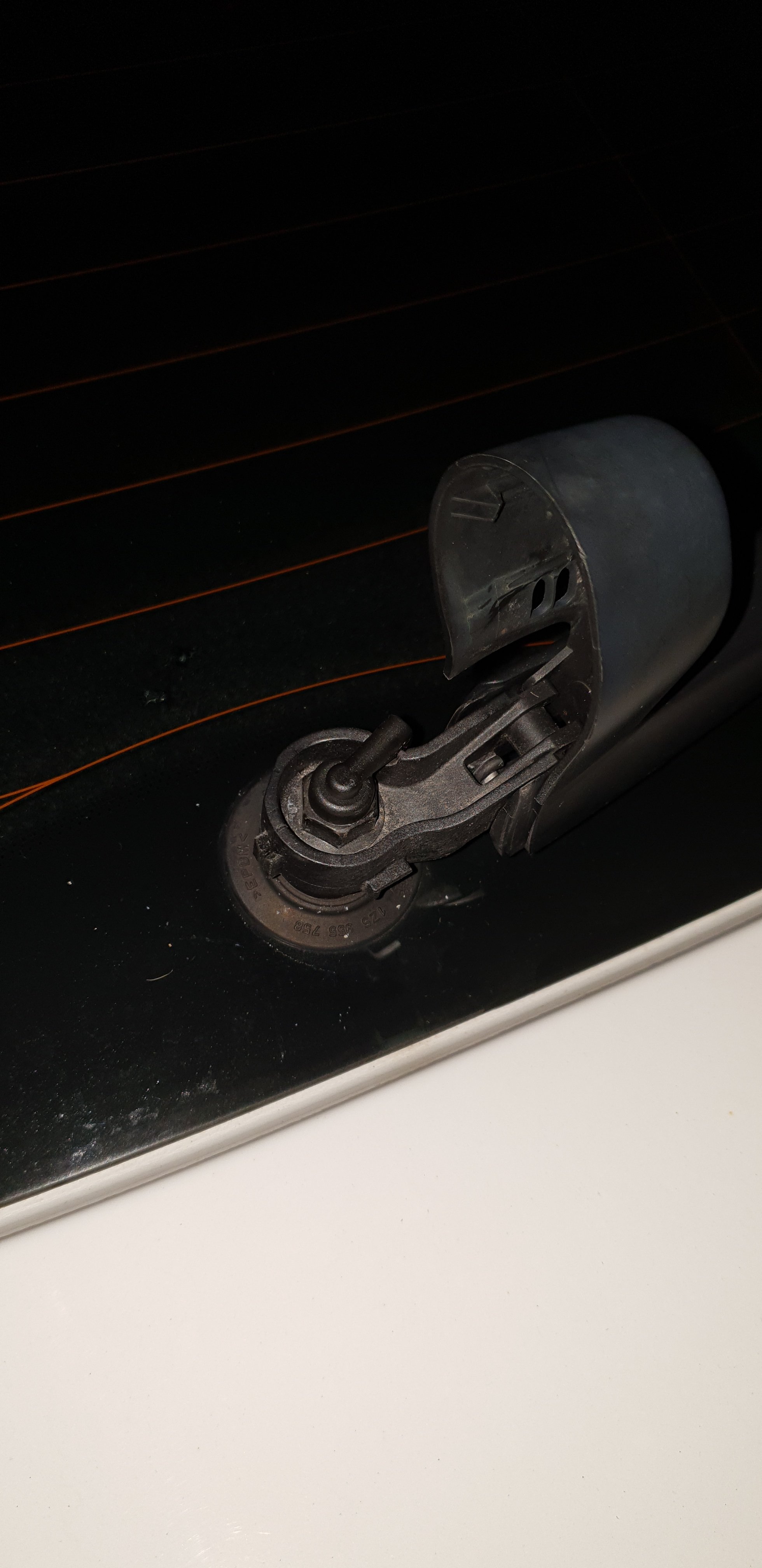

@64vrs I did mine a couple of weeks ago, its straight forward. The circular bit at the bottom on the wiper arm is just a cap, with some gentle prising it will lift and rotate towards the back end. Under there you will find the nozzle. This also pulls off but it may be tight. Use a pair of pliers with a cloth if it wont come off. To clear ths nozzle is not easy, its very fine! I soaked mine in everything from rubbing alcohol. Oven cleaner, washing up liquid, boiling water etc. In the end I cut a bristle off a broom and that was a great size to poke through and clear. If you struggle let me know and I'll take some photos for you

Wow sounds complicated, as stated before I’m useless with cars but trying to learn. Would it be too much work to stick a photo or 2 on?

The cap lifts up by the round section, gently pull upwards towards the wiper arm and gently splay the plastic a little. It will hinge on the bit you can see. Once its up the nozzles are in one piece but are pushed on, theres a hexagonal piece under it that doesnt move. You may need pliers and some cloth to stop you damaging it. Reversal is pushing the nozzles on and then simply pushing the cover back into place, taking care the hinge bit is correctly aligned.

That has been known to happen, easy way to know is to lift that cap up in the photo and pry off the nozzle. You can then activate the wash and see of the water comes out, much easier than stripping the hatch panels down. I was petrified that my pipe had come off, but was happy to find two very boocked nozzles!
