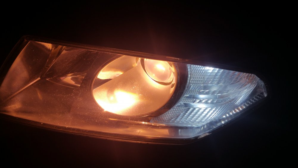

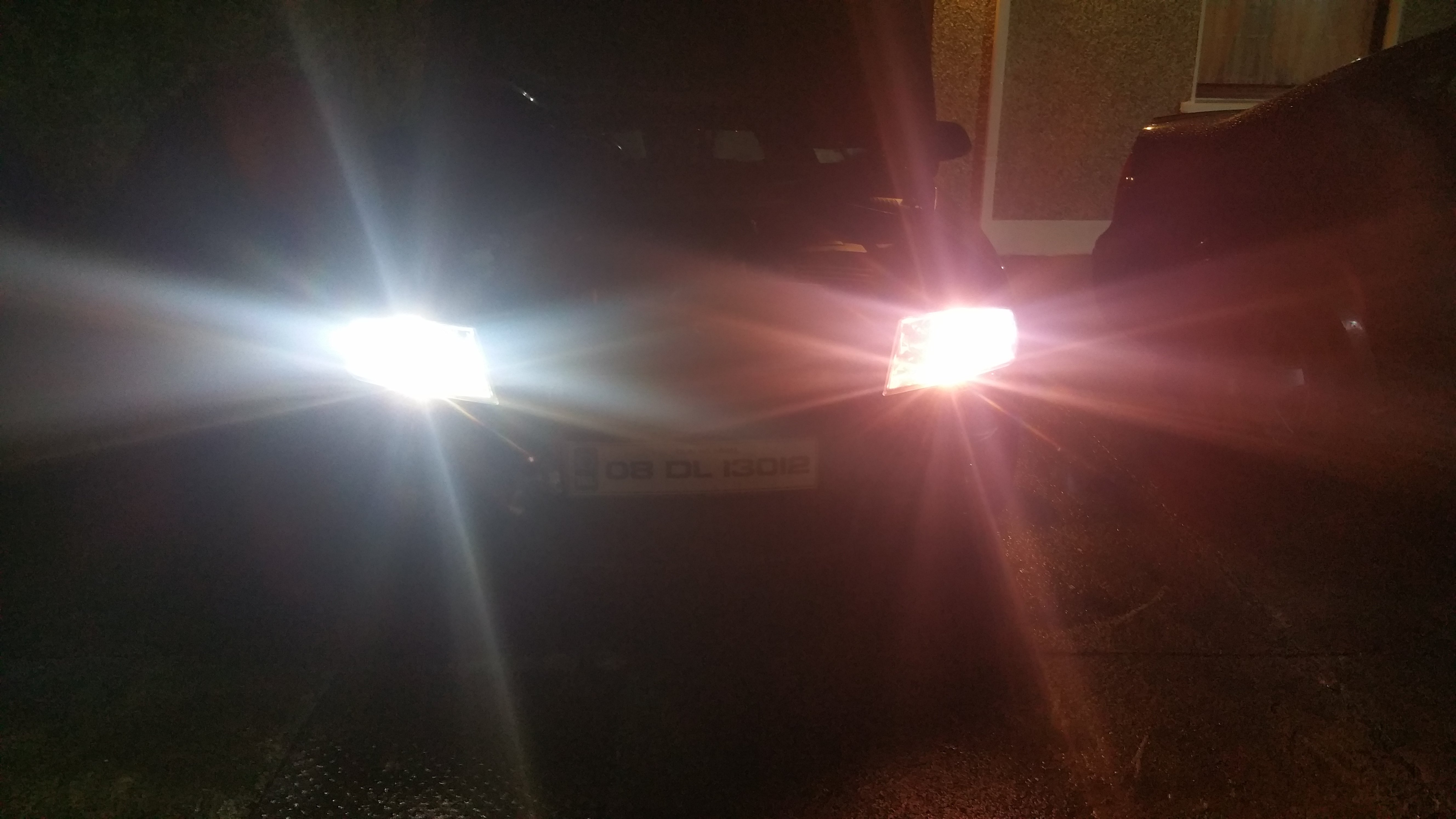

In November of 2017 I bought osram Xenarc D1s 4350k bulbs to replace the factory one that were there, baring it’s a 2008 car they done well but there was only 95k miles on her. Keeping this mind anyway I purchased the bulbs off of power bulbs uk and they’ve worked perfectly until tonight when one has turned a pinky red colour! They haven’t started to fail yet have they?! I was do some research and this is the indication. The car isn’t used as a business car it might do one run a day in daylight during the Week and some nighttime driving during Friday and Saturday and that’s it. I’m sure I’m still entitled to the warranty of a year but I’m a bit annoyed the fact that bulbs that costed over 150€ won’t last a year with minimal use.

Seems unlikely they should fail so quickly unless the bulb was faulty.
I'd try switching left to right and vice versa to see if the problem follows the bulb or not.
I would say that bulb is not going to last much longer I would be contacting the retailer to try and arrange a replacement.
Ask for a replacement, I would be happy to replace with the same
Obviously you need to fit a new one when removing the faulty one and then send it back. Phone them and see how they can arrange that for you.

I've just changed the bad one out there easy enough job as the headlight comes out, disconnect totally from the car, two screws hold the bulb in, I replaced the old ones and these are the new ones I put 11 months ago and one is falling already for anyone that didn't know, 10 min job just watch the screw's of the holder don't fall into the headlight. Just gotta wait for powerbulbs to respond.

It's definitely bulb failure these were the genuine bulbs and not aftermarket, put the old one from 2008 in that works from the last pair and it's perfect no red.

As mentioned above, the build is definetly faulty. The problem is known as "pinking". Most likely a manufacturing defect.
