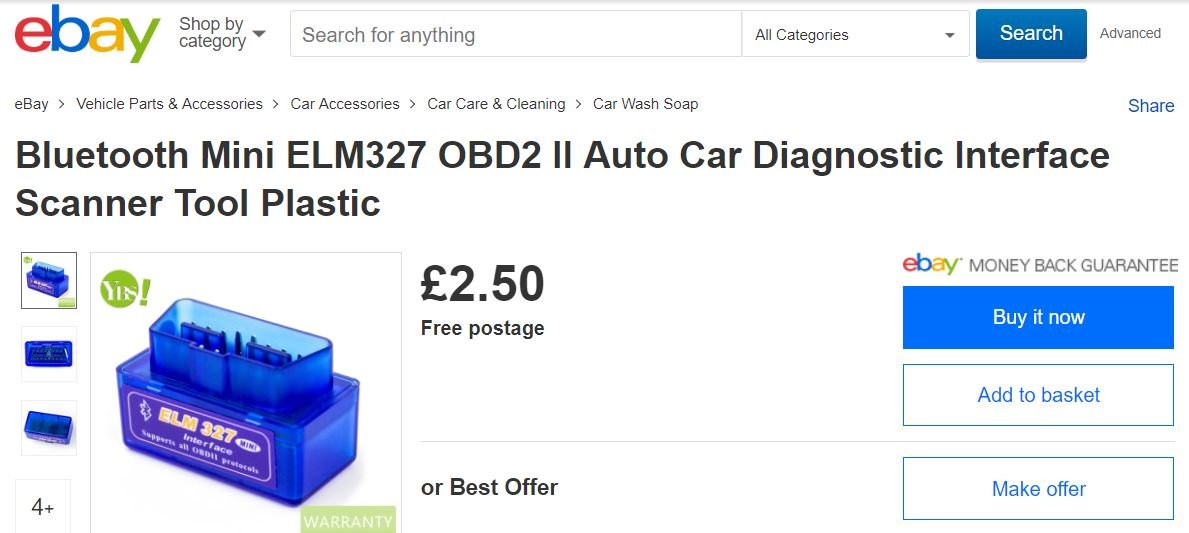

Can you tell us where you got the dongle to do this please?
They're everywhere, type "OBD2 Bluetooth Adaptor" into your web browser / Google...
Euro Car Parts, eBay, Amazon, they all sell them.
I have the ELM327 one which has worked well in my Skoda's over the years...
