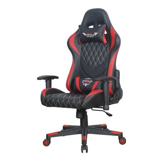

I haven't abandon this thought, many times i grab the chance to find bucket seat chairs
like these
https://media.partwerx.com/wp-content/uploads/2018/02/27141738/buerostuhl_racecar_sw_gr_fk_fkrse2481.jpg
https://5.imimg.com/data5/SELLER/Default/2021/10/WX/HH/ZH/7276863/ufitblack-red01-1-500x500.jpg
or this
trying to see if i fit with every day clothes but there are some ''issues''.
The 1st (and the most crucial) is that there is a huge distance between the back of my head and the head rest of the seat which means in every day use if someone hit me from behind i will brake my neck from the bounching (front-back movement).
Yes there are some ''pillows'' in the market for this reason (as in the above picture) but that's not reinsurand me and they are ugly looking.
in some of them i don't fit very good, the sides are tight and some of them have short lower part (seat bearing) which means there is gap between the back of my knee and the end of the seat.
This gap causes fatigue while driving for long time, as we say here in GR ''your lengs are hanging''.
For now i have found those 3 ''issues'' that makes the dream of bucket seat installing to moves away a bit ...:crying:
This is not safe my friend
