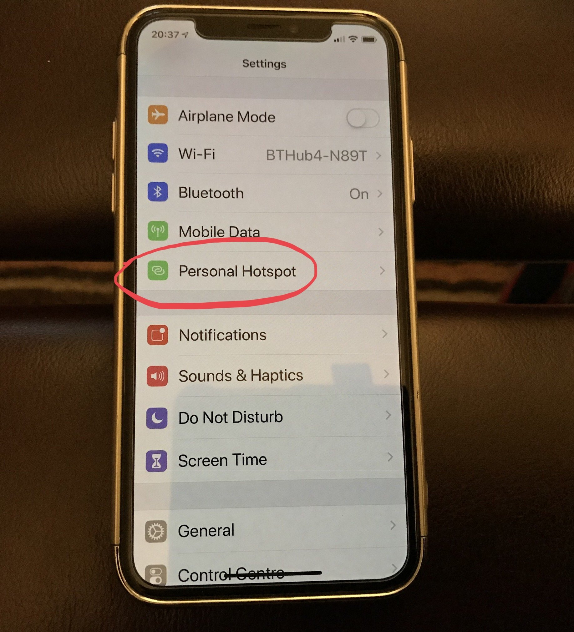

Both my wife’s and my iPhones are paired to the car but for whatever reason it doesn’t automatically connect to the car and therefore no infotainment. Blue tooth is on so is personal hotspot and WiFi is enabled on the hone but when you go into the settings it shows the phone is there, not in white/highlighted but it won’t connect.
The little red world stays red, on the odd occasion it goes white we have no idea how it’s happened.
Also you can go into the WLAN settings and the phone is there but it just doesn’t seem to want to connect.

Dont you have to set up a personal Wi-fi HOTSPOT  between the iPhone and the unit
Yes I spoke to Skoda connect they said move away from my home and try and set it up I switched it on entered the code from my phone no joy ☹️

so so far my phone seems to connect but not sure why and only after a while ie 10 mins.  So the world symbol goes white it connects to mine but not my wife’s when all iPhone (7  & 8) settings are the same ie Bluetooth on, personal hotspot on. Even yesterday when it seemed to be connected you couldn’t get the infotainment function.

I am having a problems connecting my iPhone XR to get the connect services.
I did speak to Skoda about the issue and I was told that there was an incompatible issue with the version of Bluetooth on the iPhone 6 upwards and the Amundsen.
This caused a problem in getting a consistent connection when using the iPhone Hotspot.
I do not have any problem with using the iPhone for hands free calling or Apple car play.
In the Fabia forum I was aske about the 2 speed limits showing and yes I also get that
I have given up trying to get an internet connection using my Iphone XS. If I get it to connect it lasts a few minutes at best.
I have fitted a MIFI in the boot powered by the 12v socket. It's on permanently but doesn't seem to cause any issues.
