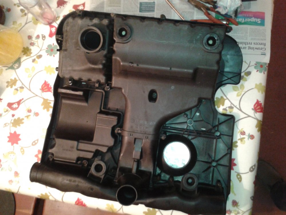

I have ordered the temperature sensor and will fit tomorrow when it comes. Has anybody got an idea how to take the engine cover off? It looks like the air box is fixed to it, and there are no bolts from the top (I have seen one screw on the underside to the left)?

The cover/airbox 'just' pulls vertically off; you won't break it, although it feels like you might. Usually easier to start with the back edge I find. There are three or four plastic pegs on the engine that go into rubber grommets on the airbox/cover, the rubber can be very clingy so would advise a little silicone grease on the pegs once you get it off. You will have two pipes connecting into the nearside edge of the cover, the one nearer the front is easy, just pulls off a parallel pipe stub, the rocker breather inlet one further back can be stubborn, so if it resists attempts to squeeze in the sides of the connector, just leave it on at that end, and pull it off the other end when the cover is loose.

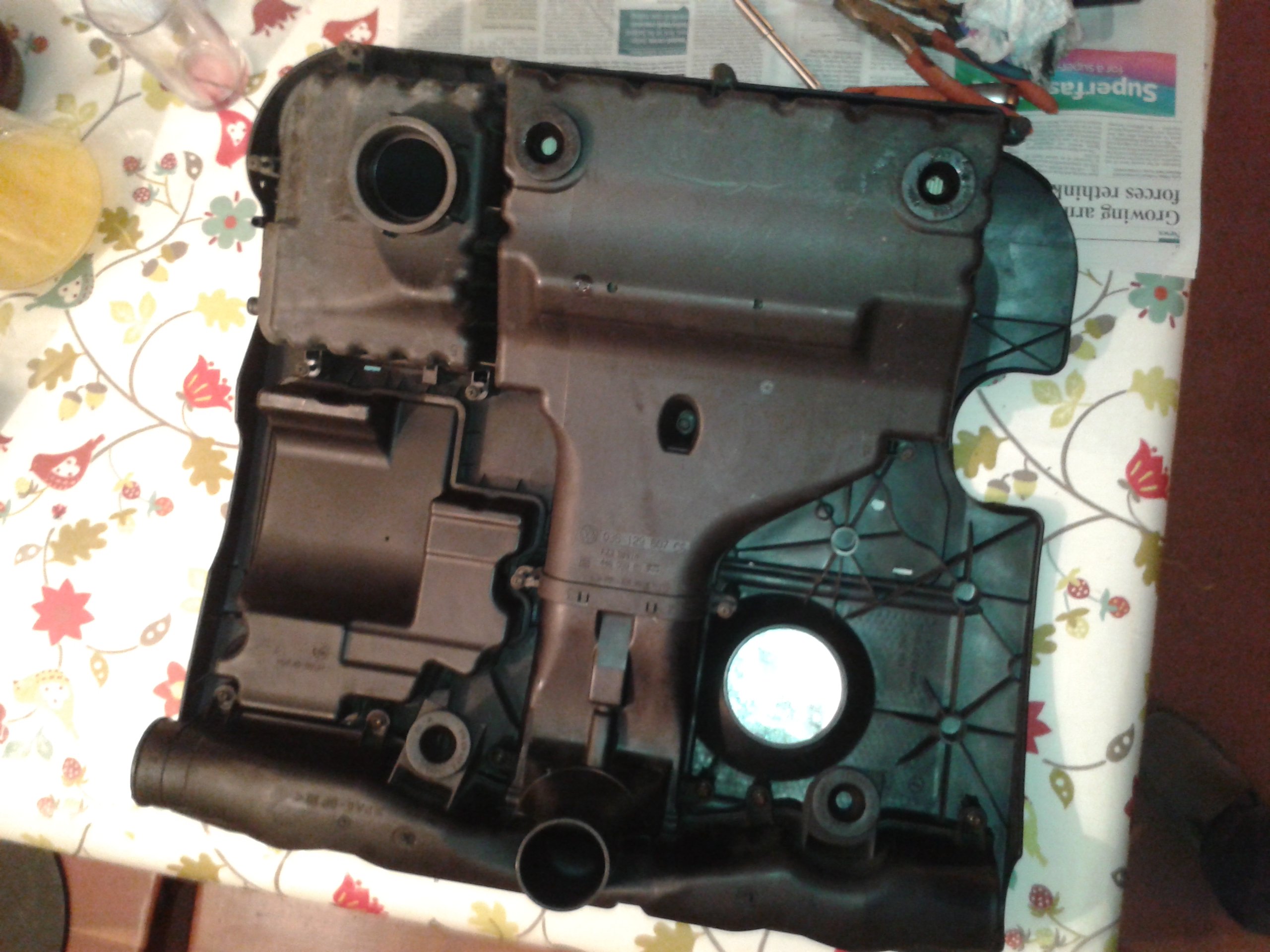

The rubber grommets like yours will have are shown in this photo (not an identical airbox, but very similar):
