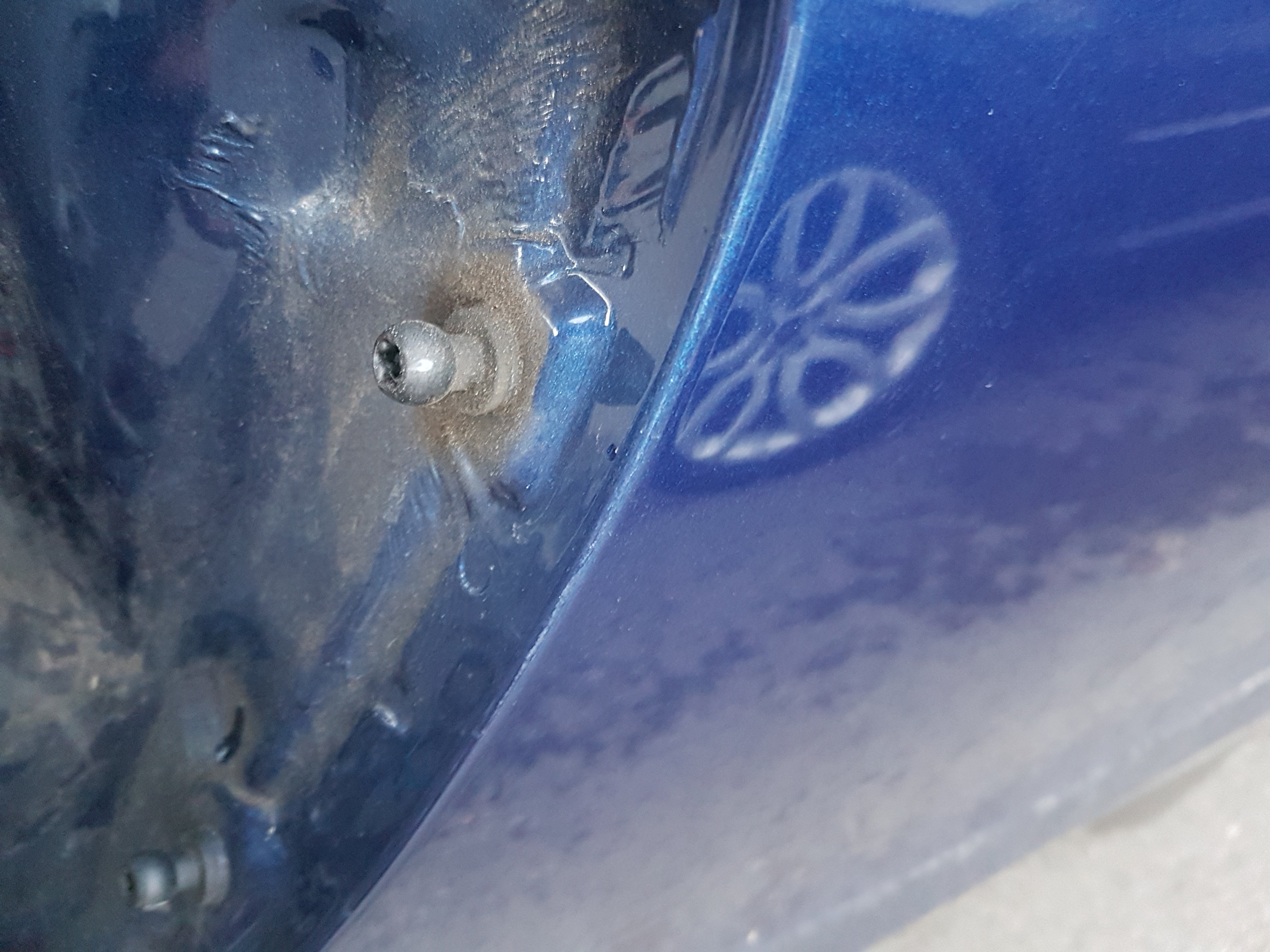

What are these and where can I get them?

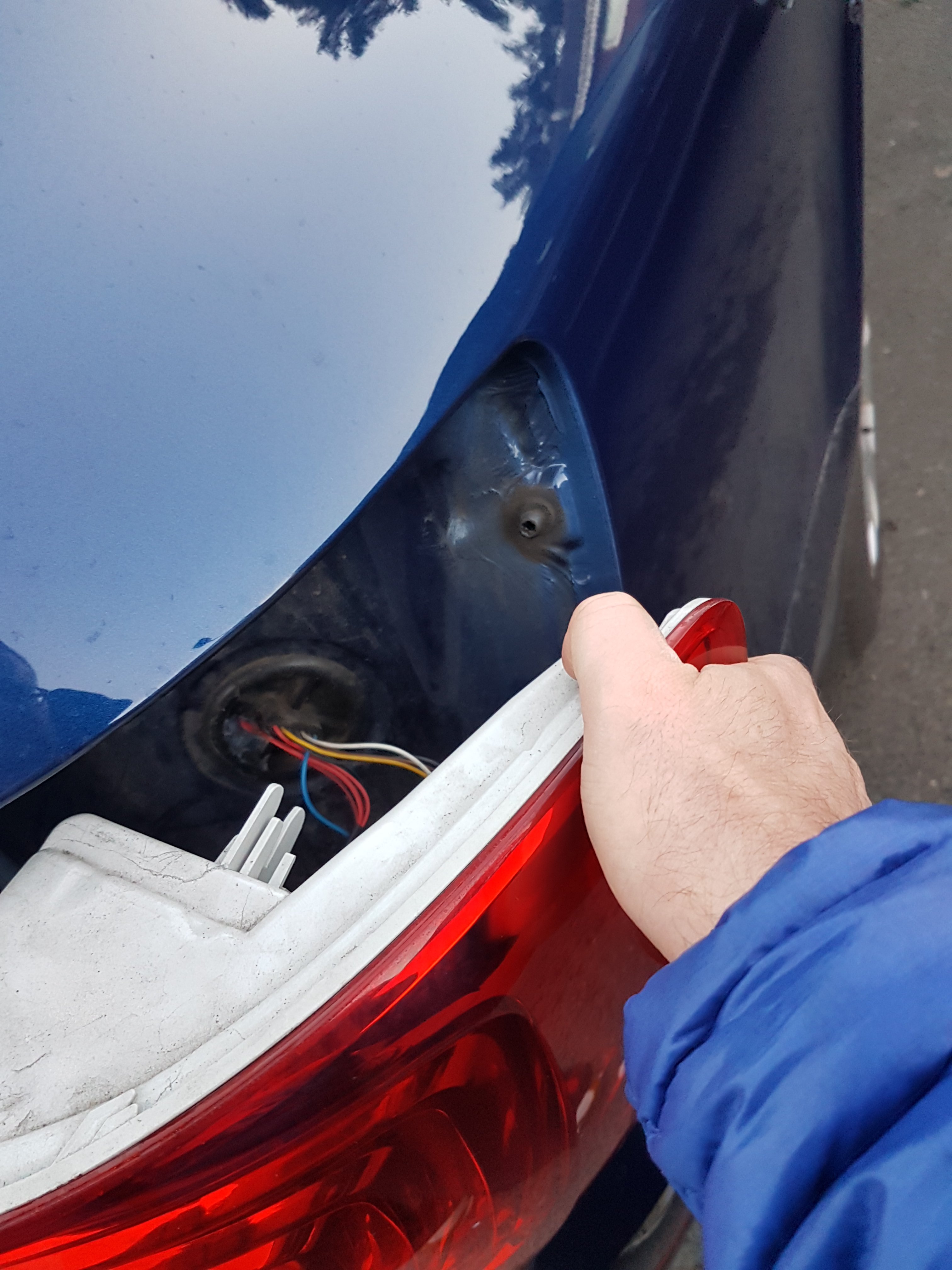

The small black 'ball studs(?!?)' Behind the rear lights. The unit pushes onto them. I've a broken one :(
a part number would be fantastic if anyone has one

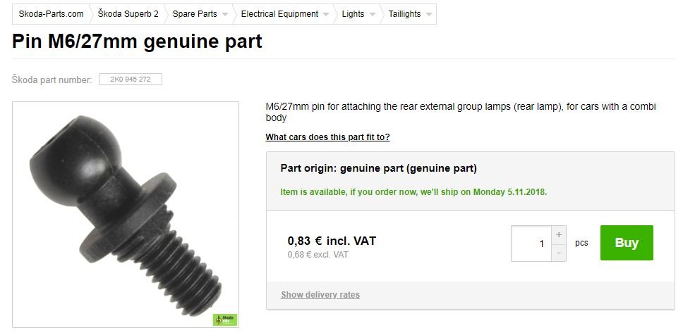

Check the thread , link above suggests m5 so these
https://www.sgs-engineering.com/x1-ball-extension
Might be the very thing
They look spot on. Albeit metal rather than plastic. I'll take some measurements and compare. Thank you
Think there were dif thread sizes if they aint m5
That has to be it!
