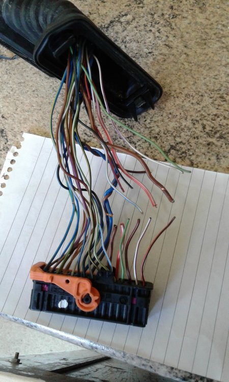

Is there an obvious way to see the broken wires, are they literally snapped.  I pulled off the gater and everything appeared to be okay.  The electric mirrors and c locking still works fine.
This is what mine looked like,you may have to pull the gaiter back a bit more to see. You will also notice not all are broken, some are in the process of breaking.
Mine were broken and a Skoda  technician soldered them a couple of years ago. Everything works like a charm since then. He quoted me 20 euros for the job.
