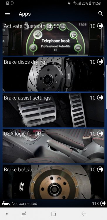

Spoke to eddienl to get a loom made as couldn't find one other than the Chinese ones. Mic 3B0 035 711B from factory retrofits. Any one local that has vcds can activate bluetooth function or you can use obdeleven to do it yourself if you have it Screenshot_20181103-115900_OBDeleven.thumb.jpg.89bd61267265db219c5d79b355947746.jpg
