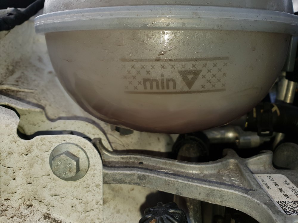

I think Im about half a mm of level from getting a low coolant alarm on my 2016 vrs tsi 220! Never had this on a car before, I havent had to top oil up between services either but I started doing that too when I bacame a skoda owner!

Is that just condensation/moisture on the outside of the expansion tank?

Yeah thats just general mess, its not from the tank. It rained for all of the day yesterday. As far as I can tell thats now twice as far as it was from the minimum as it was about a 1000 miles ago.
